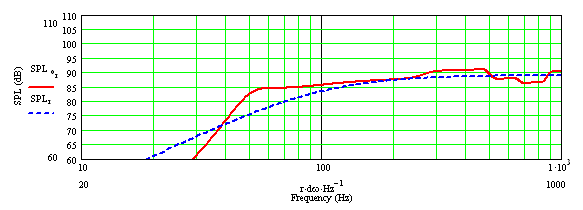

so I started the design using the allignment tables from MJK (weidok and I made a nice excel sheet that automates this) and the allignment from that (a 1:10 taper, driver at 1/3 of the line, tuning 55Hz) was the starting point for the Mathcad sheets. the 'driver offset' sheet gave very promissing results, so I made a sketch, and entered that into the sections sheet. just some tweeking and the results were imho excelent. I optimised the stuffing so I could use 1 sheet of Sonofil for each box

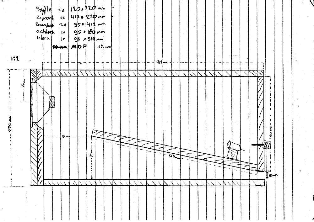

so, building it was fairly easy, just the normal 6 pieces + 1 extra... I applied the same notch filter as for the original BB3.01, so I could do without measurements this time, and soon I could start listening...

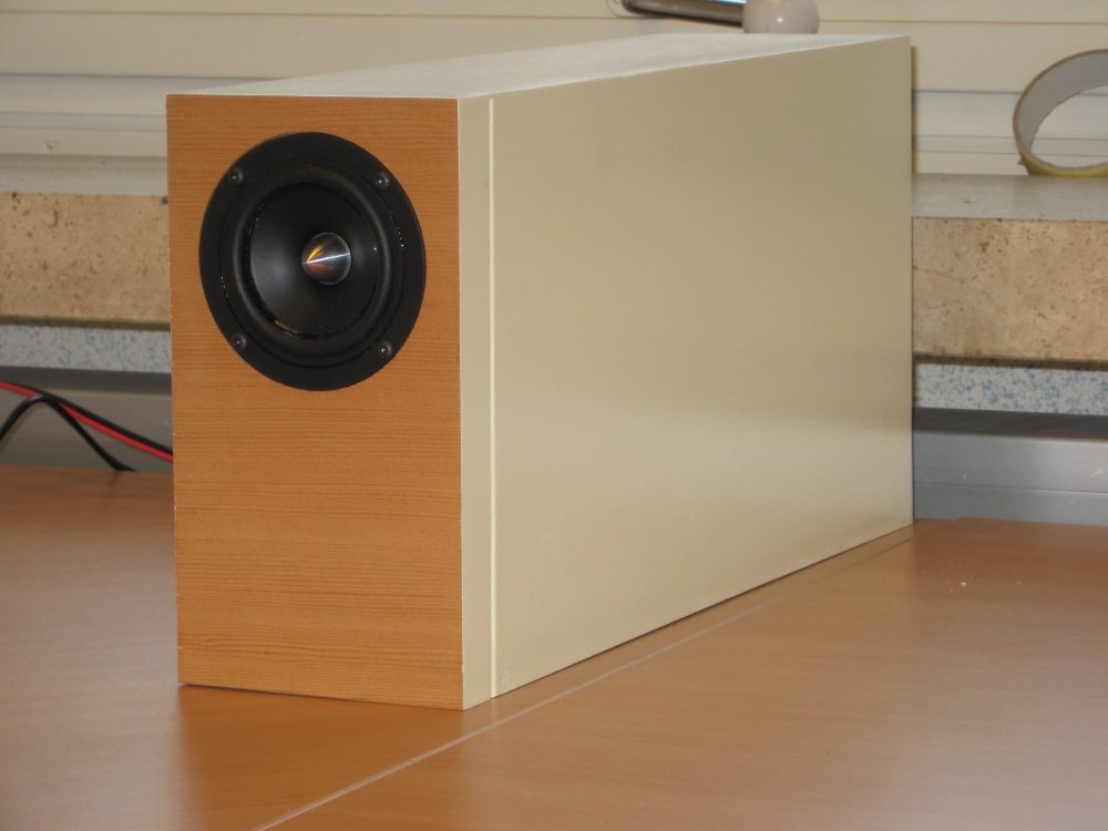

I wa stunned. the bass was amazing, most I have heard from this size of driver ever. (in a larger room the bass is somewhat less I found out later) even percussions sounds good, a accoustic bass sounds like a big instrument, etc.
I decided to do a combination of vineer and paint for the exterior to finnish them off, se the photo

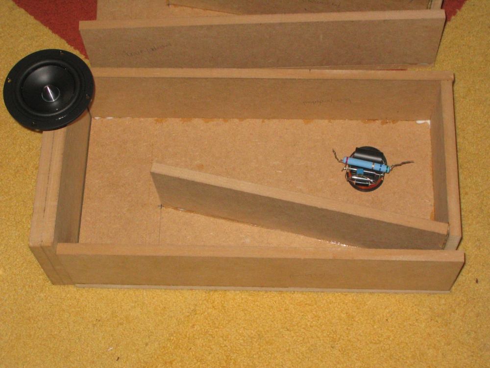

on the stuffing: most of it goes into the closed end. the area around the driver remains empty, and only some 4 grams go into the open end. bass output is rather sensiive for the stuffing in the open end, so if you experiment use small changes...

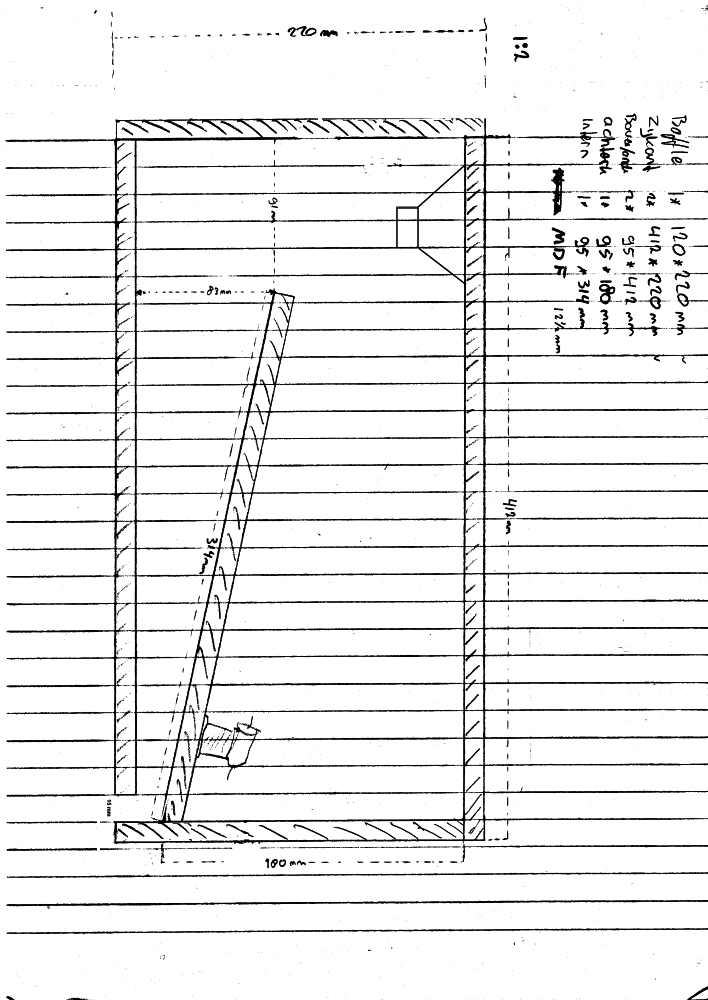

a drawback of this design is that it will not fit every desktop, due to the large depth.... so why not flip it on it's end and move the driver a bit... this results in a 40cm tall and only 22cm deep box. would fit nicely next to any decent sized LCD screen or TV... so I modified the mathcad sections sheet, and the results were very similar to the original.. just a dB or so in the ripple, nothing more..

Does the line tuned much lower than the driver Fs really have that good a response or does it create ripples?
you can see the sim in the opening post... flat enough for ya ? :cool: the combination of a strong taper and the stuffed closed end does the trick.
I think this basis (~1:10 taper and 80-85cm line length, lots of stuffing in the closed end) might work with other TB drivers as well. but I expect you'll want to change the BSC somewhat.
