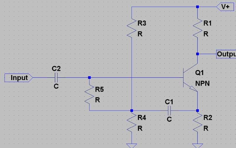

Your bootstrap circuit appears to be wrong also. See the attached bootstrap circuit. The input signal should not pass through the bootstrapped resistor as your drawing shows. The input signal goes directly to the base of the transistor and the bootstrap resistor (R5 in my drawing) acts to "insulate" the bias network from the input signal.
The voltage across the emitter resistor (R2) follows the input voltage (approximately) as in an emitter follower. The bootstrap capacitor (C1) applies the AC componant of this voltage to one side of R5 while the input applies an AC signal that is essentially the same to the other side of R5. So for the AC componant we have approximately a constant current and thus nearly infinite impedence.
So this configuration allows R5 to "pull it self up by its bootstraps" so that its effective AC impedence is much higher than its actual value. Since this very high impedence swamps out the voltage divider's impedence and is the only other impedence in parallel with the impedence of the transistor's base the total input impedence becomes essentially equal to the impedence at the base of the transistor. I don't think this will work as well without an emitter resistor because the emitter resistor raises the input impedence of the circuit. The input impedence is 1+hfe times the sum of the impedence of the base emitter junction and the emitter resistor.
