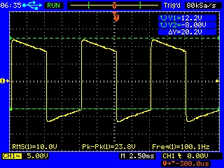

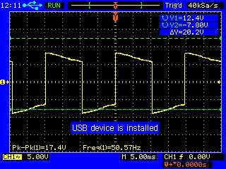

The scope showed 1Vp-p into primary. However, In thinking about it that should be 10V p-p as I had adjusted the output for the max I could get. I could not maintain 2Vp-p on the scope out beyond 400KHz and I suspect the scope was not detecting the 10X setting on the scope probes. I'll verify it tonight.
I measured the transformer on our old GenRad 1658 RLC bridge which was recently calibrated.
I got:
primary inductance - 1.05H
Leakage inductance - 5.02nH
capacitance primary to secondary 522pF
Lp is rather disappointing.

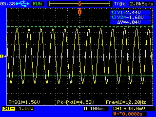

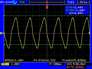

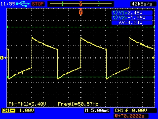

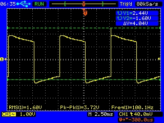

It was as I suspected, the scope does not detect the 10X probe and so the voltage was 20Vp-p in and 1.15Vp-p on the secondary loaded iwth a 330R resisstor.
Measuring with a 6.8K resistor in series with the primary and the secondary open, I get half the voltage across the transformer leads at 238 Hz for L of approximately 4.5H. Still not near what I expected.
I ran a few tests again and captured the screens. Square wave does not show much as there is too much slope in the output of the signal generator.
Some of the peak in the original measurements was due to a peak in the signal generator. I'll have to go back and carefully adjust the input level and measure the output again.

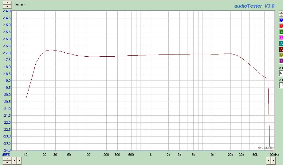

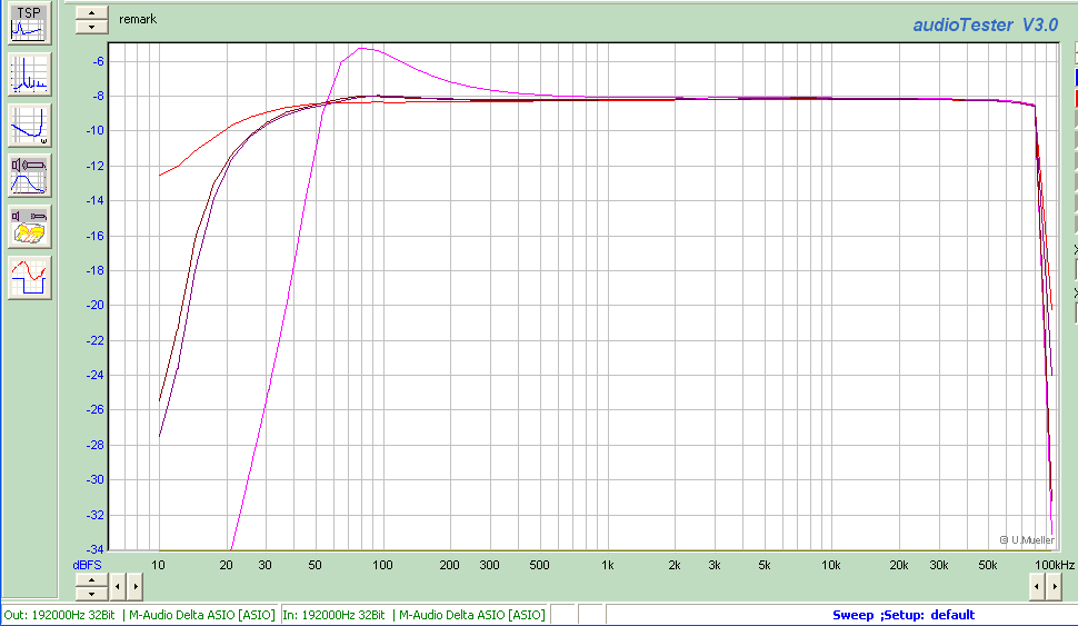

Out of curiosity I hooked it up to my sound card and ran a frequency sweep with a 520 ohm resistor across each output wired to the sound card differential input.
I got the attached curve running 24 bit 192Ksample rate.
The input to the transformer was -4db with a reference of 2.8Vrms as 0db.
It looks to me like it is +/-.3db from 20 to 20KHz. The hump at lf looks nasty, but I suspect it won't sound too bad.
Next up is to build the proposed amp and see how it sounds.

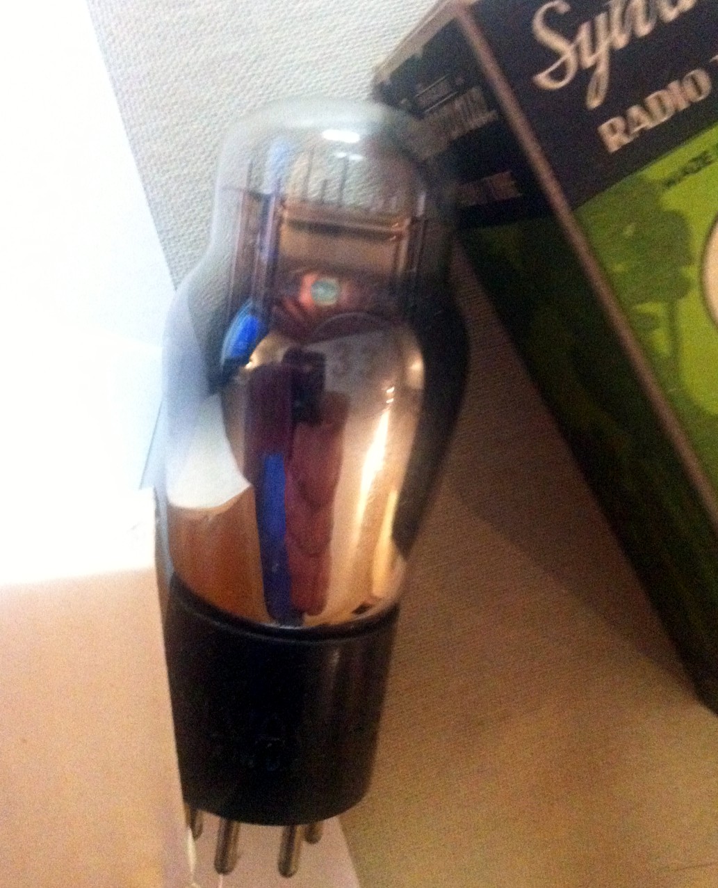

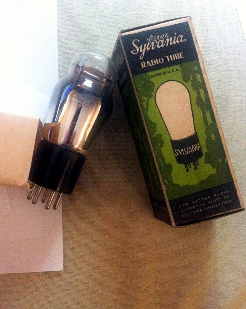

71A 6J9P Mu Follower Parafeed headphone amp
I built the output stage of my proposed headphone amp. It is a 71A Mu follower with Parafeed output. The top current source is a 6J9P.
I treid several coupling cap values starting with 1uF (orange trace) and working up till I got rid of the LF hump.
Frequency response looks pretty good with a 50uF film cap for coupling.

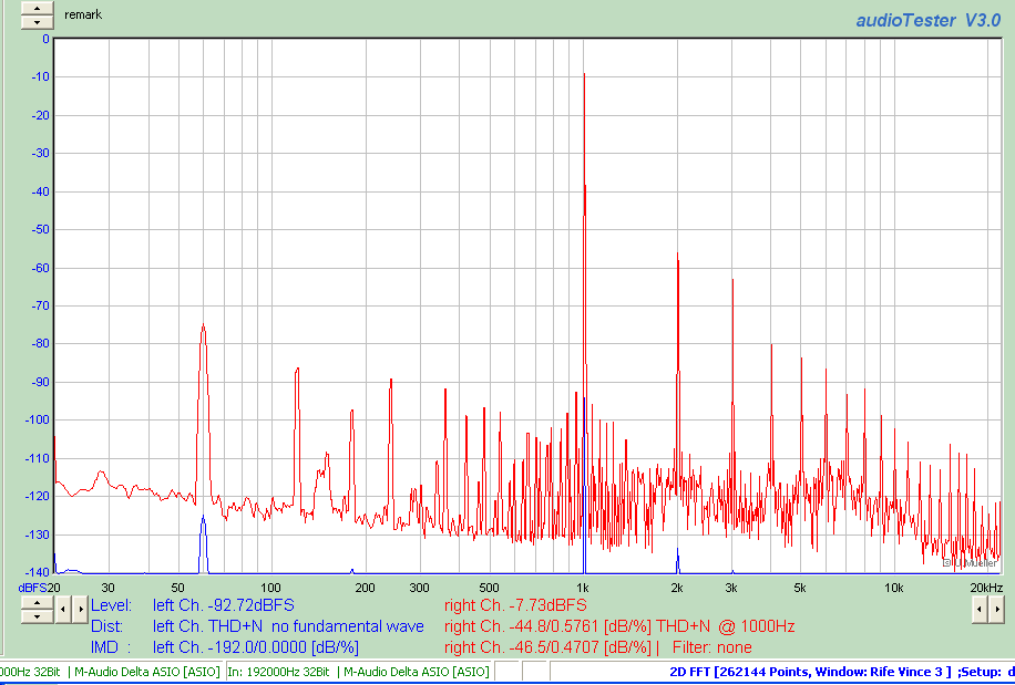

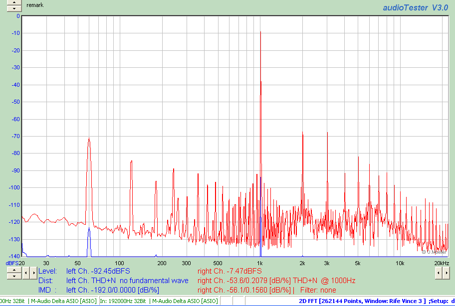

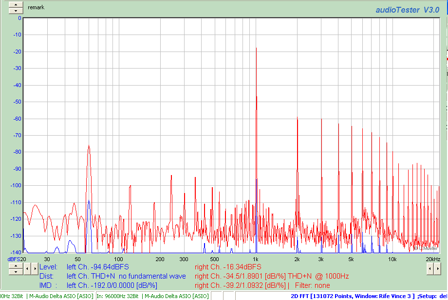

Looks like my sound card is toast.
1/2 channel is reading like I expect. The other 1-1/2 channels are really distorted.
Distortion now changes with bias conditions.
I still can't get distortion down where I think it should be. With 1.4Vrms out is is way higher than the simulations.
Of course the simulations could be way off too.

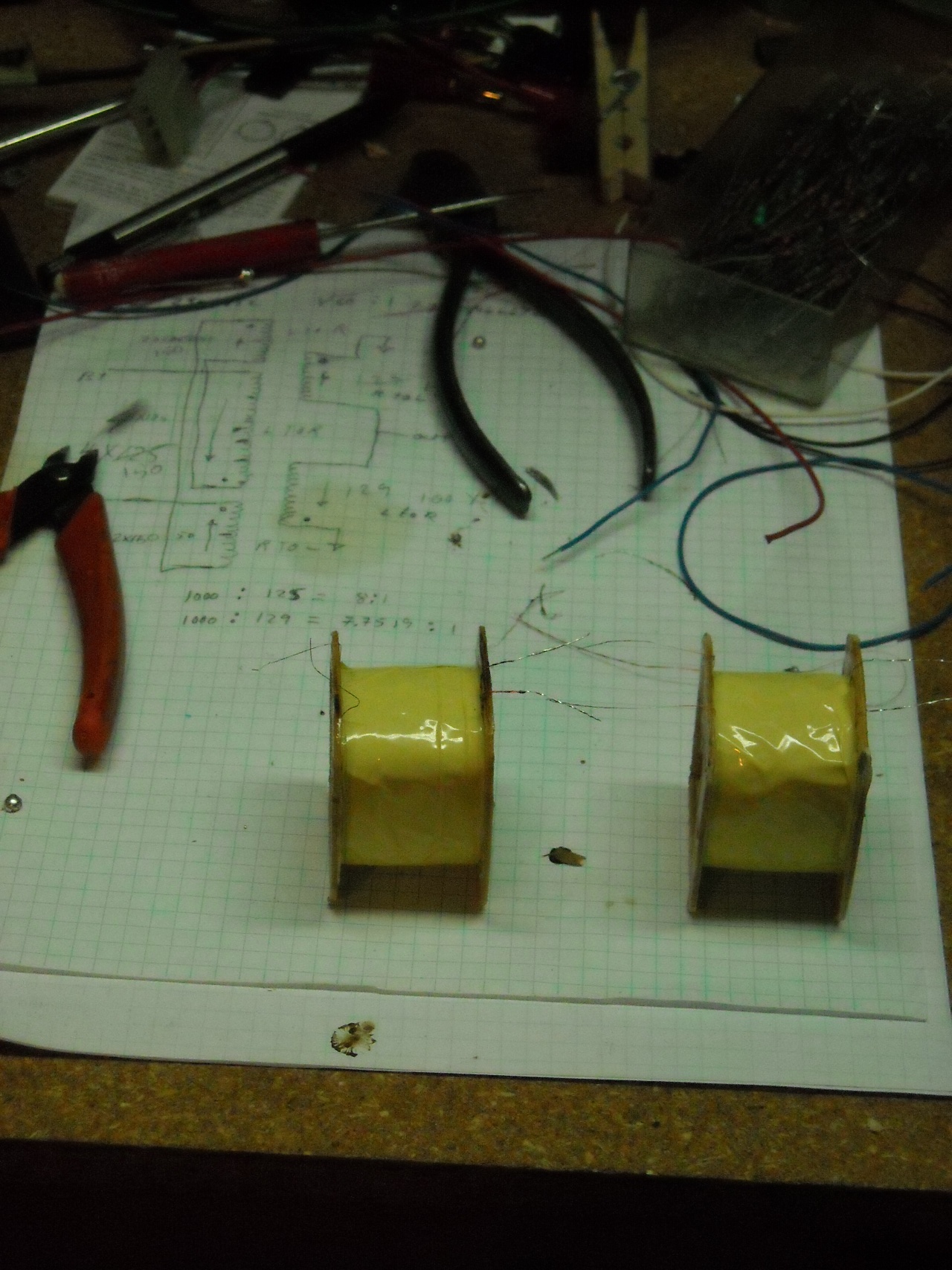

I got a jump on the transformers and wound the first bobbin last night. Initial tests without the core using a signal generator and voltmeter look good. Windings are much tighter than the first transformer so I expect greater coupling capacitance and upper f3 to be lower than the first one.
Coils Wound
I managed to get both coils wound this weekend.
The secondaries show different output voltages than calculated, and one is high while the other is low. This is true of both transformers and they match within less than 1%. So I went ahead and wired the output windings in parallel as planned, and they came in within 1% of the expected output.
Matching is better than 1% between the two coils when tested at 10KHz without cores installed.
Both show peaks around 110KHz.
I need to wire the leads and finish taping the coils before installing cores.
