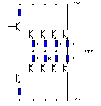

I wasn't sure in post11, but I have gone and drawn a single ended ClassA with constant current sink. Then bridged a pair of these.
The peak output power is limited to Iq^2 * Load impedance.
Short the output and the current is Iqpk and power =0.
It is immune to the effect of an output short.

Headphone impedance goes down to about 32 ohm for normal headphones. So output impedance of amp needs to be much lower than this. I wasn't keen on overload protection schemes because they seemed to be detrimental to sound quality. So I was going for a brute force approach.
Andrew, that sounds interesting, but I am still new to this, do you have any schematics?
search single ended ClassA amplifiers.
Start with the Pass site. He shows a CCS version and he also shows bridged in there somewhere.
D. Self also discusses single ended, but there are many others, even in here.

I must add that a push pull amplifier that is bridged is not immune to a short. It self destructs unless protected.
not in general.
Badly designed protection can interfere with the sound quality.
A well designed protection scheme should be completely inaudible when the load and drive voltage are within specification.
But as said earlier, for a headphone amp this would be unecessary complication.
