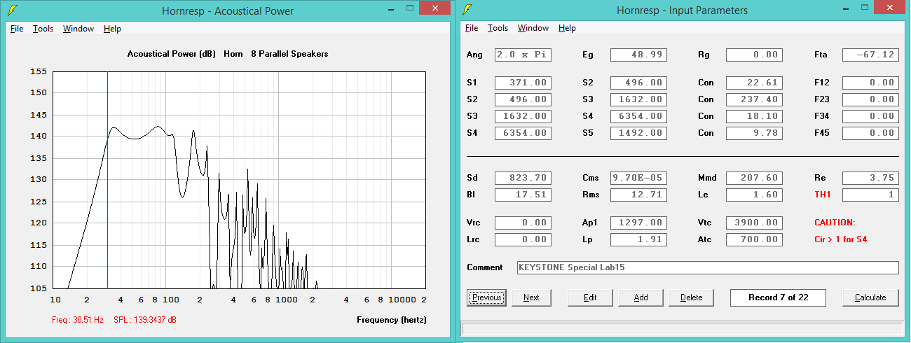

My snap choice? Build as many Keystone tapped horns loaded with this as you can afford and enough amplification to match.

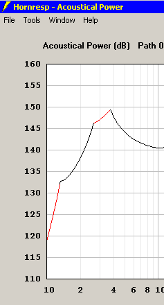

I ran some sims on that titan 15. My diagnosis is it's plain garbage. Almost no motor and isn't well behaved in any reasonably sized box. I remember we were talking a similar "wall of speakers on a budget" in another thread. I'll have to find it.
I've kindof run through some of these low budget many drivers scenarios before in hornresp sims because they interest me. Usually they don't pan out to anything amazing. The only exception is that LAB15-4 run that was going on a while back. That was a fuckin steal at 2 for $260. Shame they're gone. Could have bought around 8 of those, and that would have made fantastic noise. See attached.

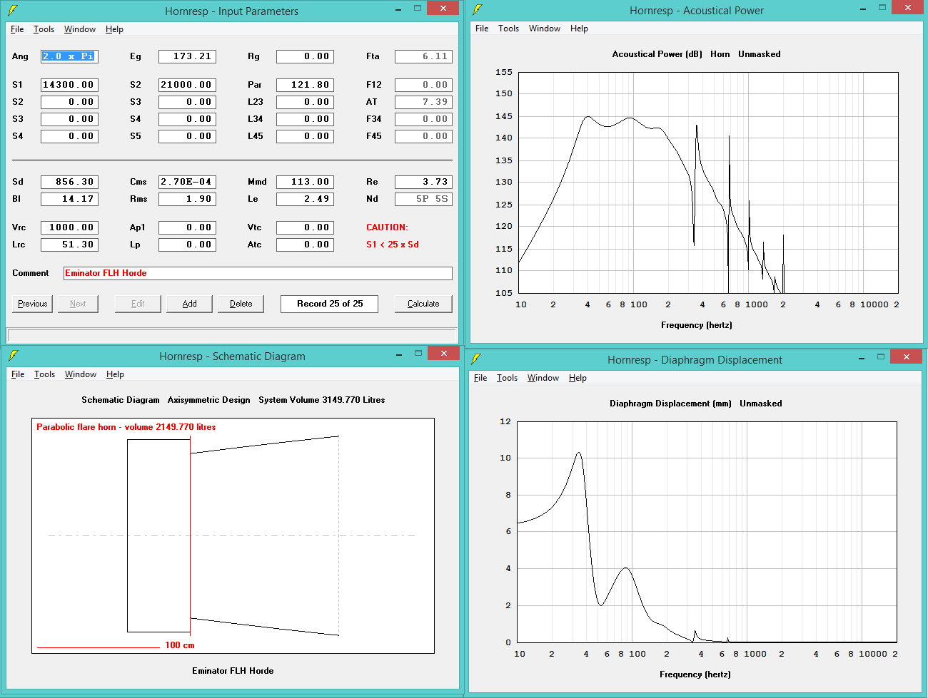

I cooked up a quick idea of what you could get done. I personally think it's ludicrous, but if big and imposing are actually positives, could be the ticket. Also will necessitate ton of plywood.
Eliminator 2515 Drivers
25 x $34.50 = $862.50
25 x 300w rms = 7500w rms
3149 liter internal volume
Sims say it will do around 143db from 35hz up. Das a lot of bass.
But the more I look at it the more I'm convinced that a trio of big FLH loaded with 18tbw100 is the much more sane route if you decide to reject something like the above for the following reasons
1. That much plywood is gonna get pricy. Might be covered by 10 sheets of 8x4 though.
2. That's quite a bit of power to supply, given you'll want about 15000w worth of amp to run it to max potential
3. That's gonna take a long time to build
4. That's a lot of space. But not an absurd amount. Internal volume isn't the best way to do size comparisons, but this is about 2580l internal for comparison
http://worldconspiracy.org/speakers/NorthHall.jpg
(a dozen SS15s at about 215l internal each)
5. A stack like that will have very little resale value. Reasonably designed 18tbw100 loaded sub would.
But hey, why not.
