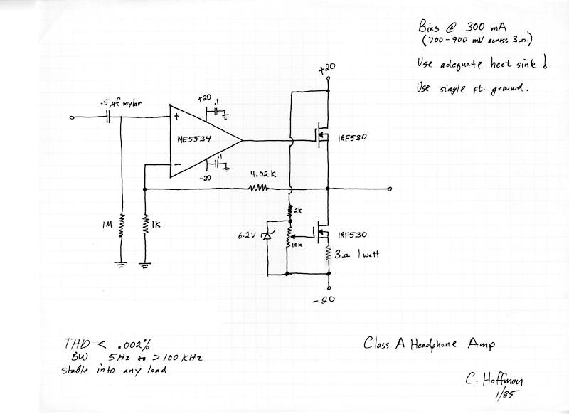

I've built a very satisfying class A headphone amp with little more than a good opamp and a couple MOSFETs. Set one up as a constant current sink. Though everybody thinks symmetry is good (hey, it might be if you could actually achieve it), the voltage offset involved in driving a MOSFET moves the opamp signals away from the crossover area, making it that much better. I'll try to dig up a schematic for the thing.
Conrad
Here's a super simple circuit. You can bias it low for headphone use or, with a large heat sink, bias it high enough for small speakers. Just be sure the heat sink is adequate. Today I'd use an LME opamp, but 5532 or 5534 is very good. MOSFET choice is non-critical and it's also nice because no P channel devices are needed. I'd also use a polypropylene cap rather than a mylar.
Headphone Amp from 1985!
I also did a version with an active current sink, but it really didn't offer any great benefit other than using more parts.
Conrad

The other project i see by there use IRF mosfets.
I personnaly tested these devices, and they have
a serious drawback as they will limit the max output voltage
due to a 4.5v threshold, not counting that they produce
significantly higher distorsion than BJTs despite a higher
bias current.
