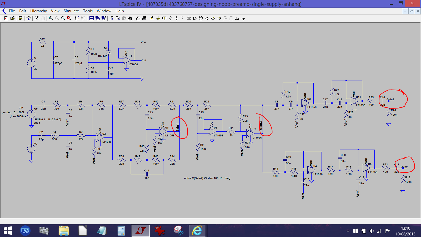

Mooly is doing a simulation. That will not consider good/bad layout.
The sim only considers the opamps and resistors for the various noise that come out.
I would guess that "noise gain" may be a clue to finding the problem parts of your circuits.

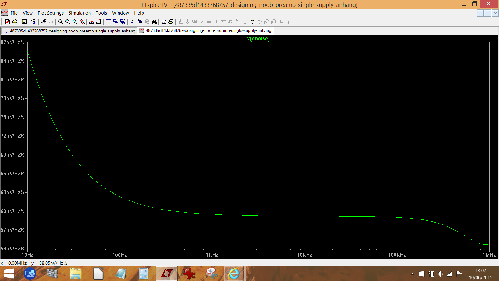

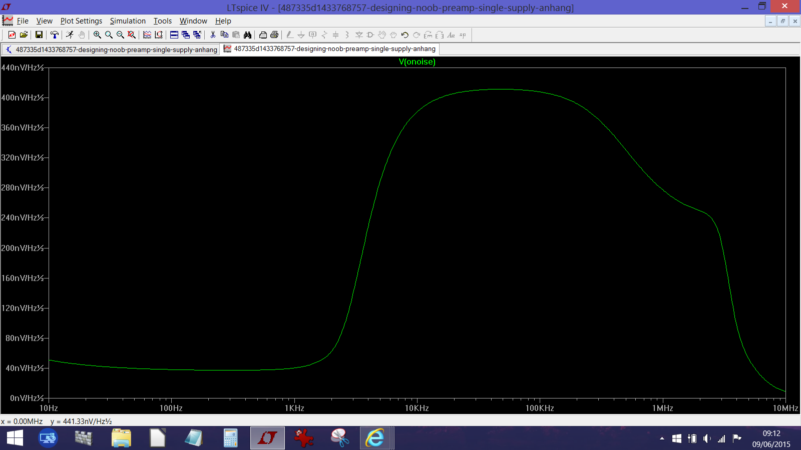

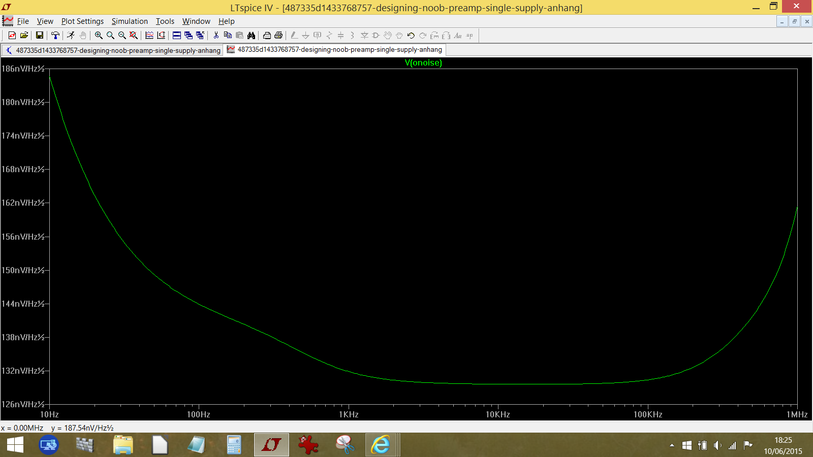

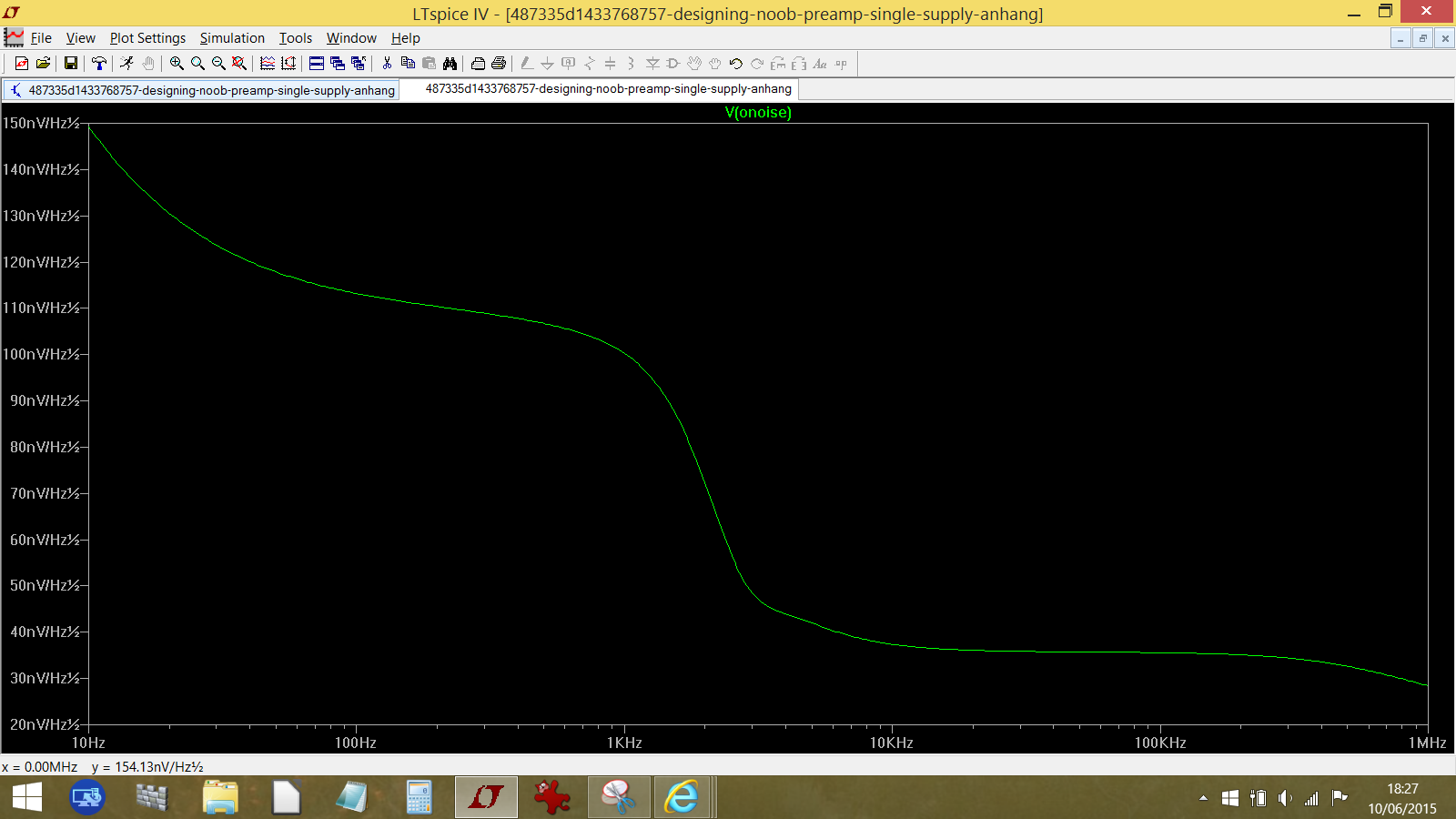

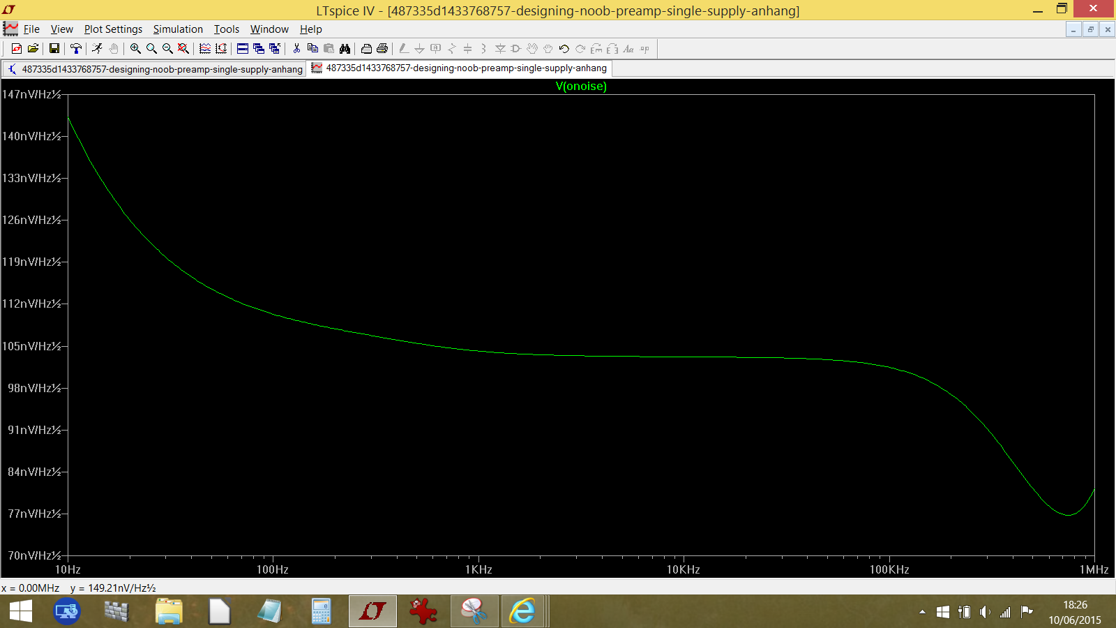

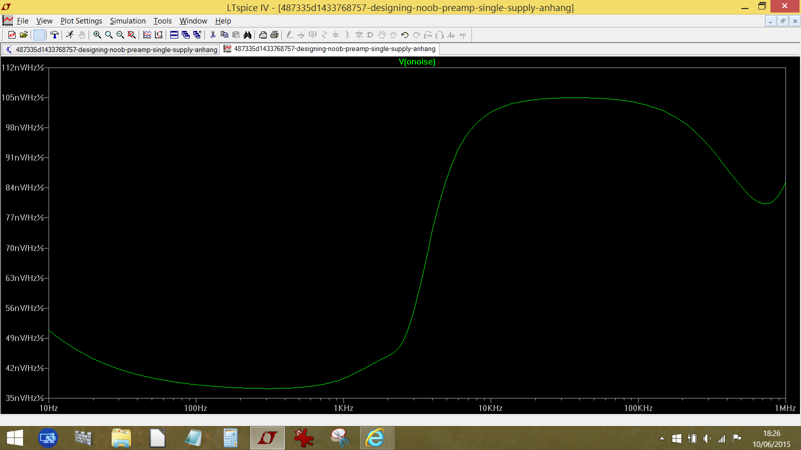

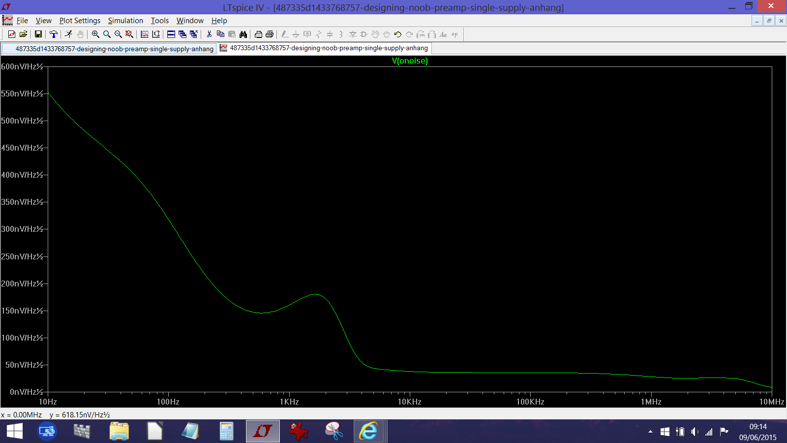

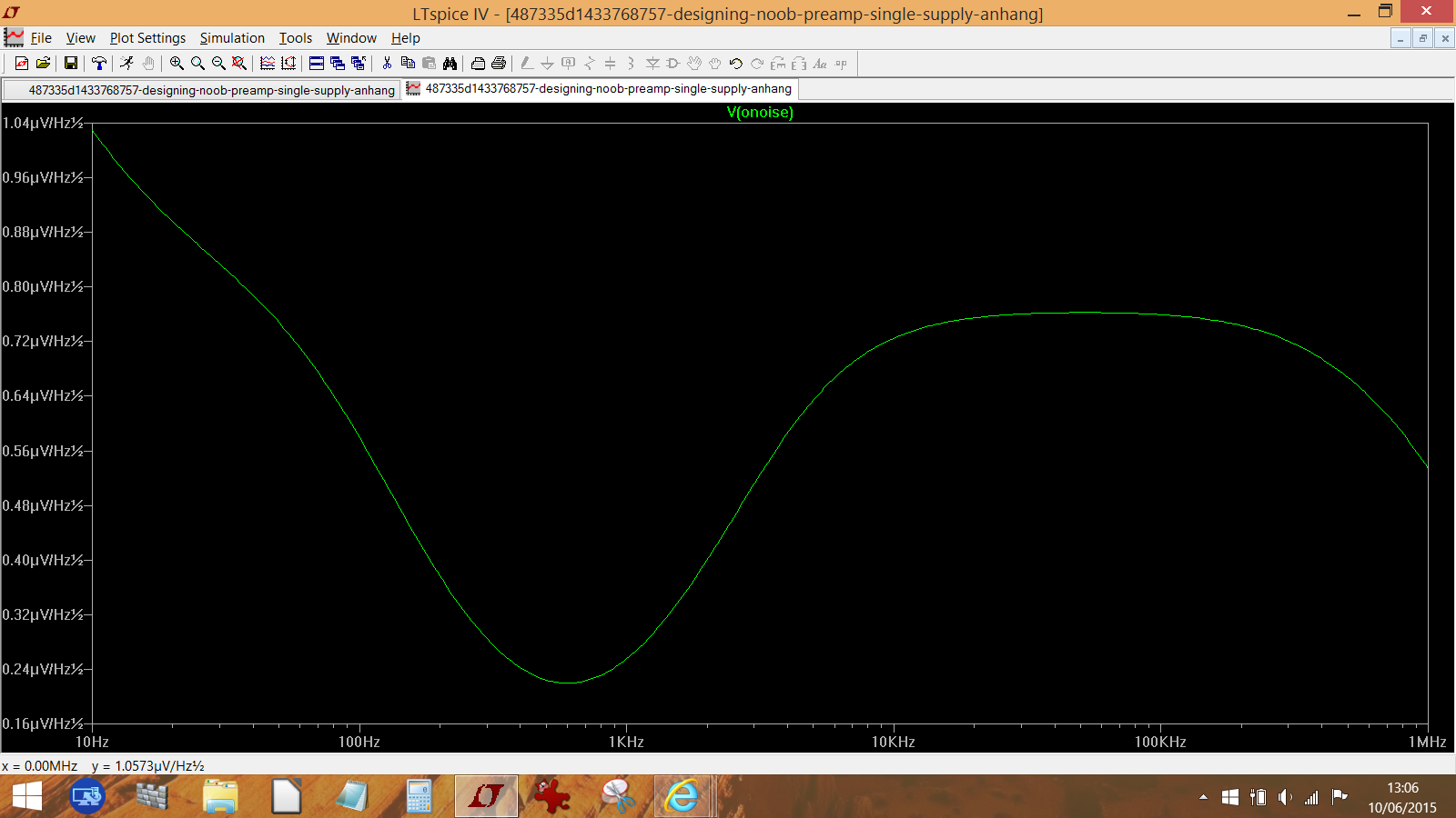

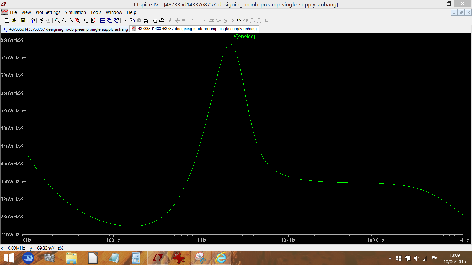

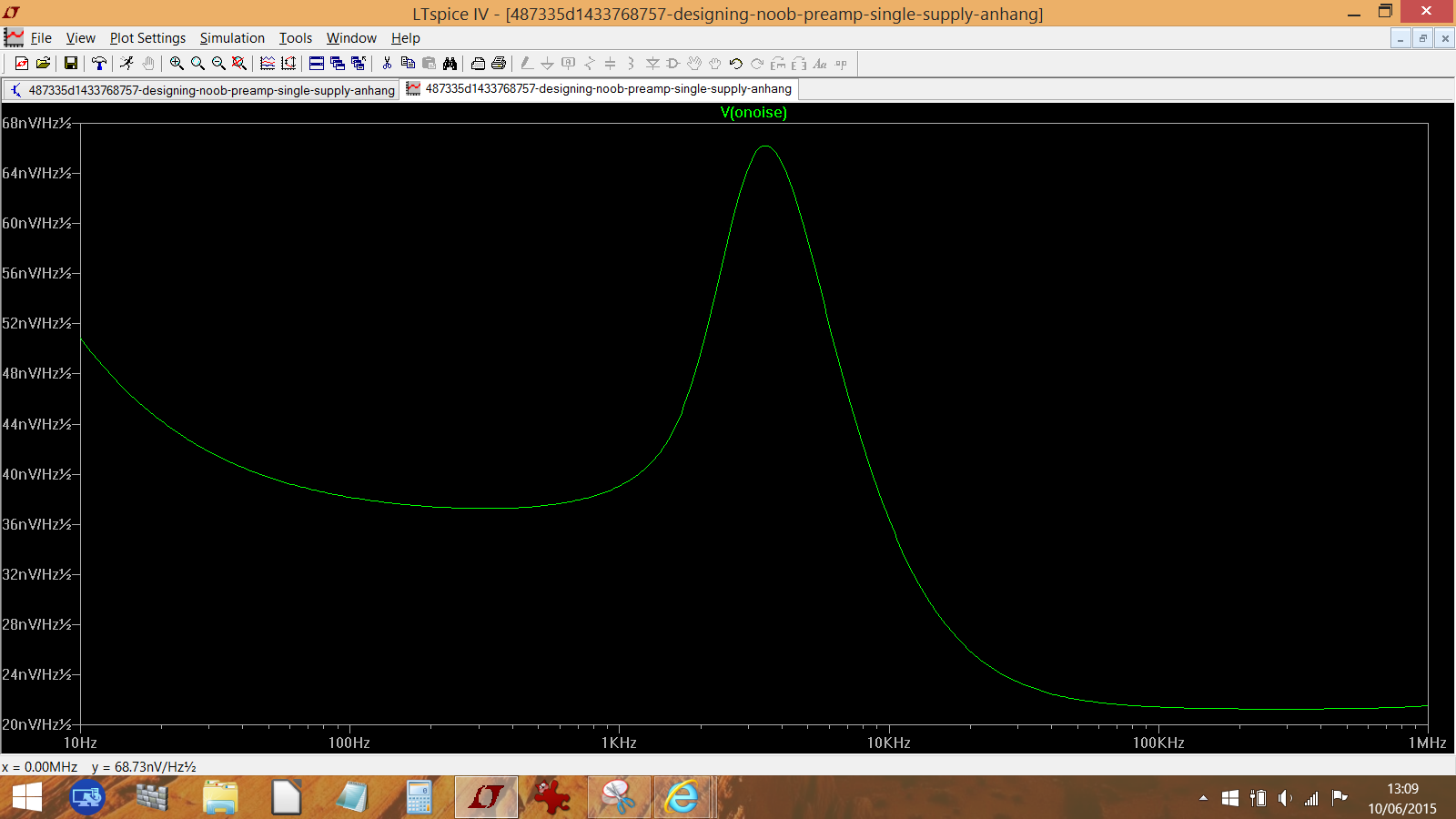

I've retested each section individually just by breaking the chain at stage and injecting the input signal at that point. So here you have four test points, Gain 1 through to Gain 4 and the noise of each stage. Look at the scale in Gain 1 plot. We are in microvolts of noise here.
No the stages are not separated.
Pic 1 is relatively noisy. 0.7uVac/rootHz or 700nV/rootHz
Pic 2 after passing all the preceding stages is noisy. 60nVac/rootHz.
Pic 3 after passing through the high pass and the preceding stages attenuates some of the noise but leaves a narrow band with little attenuation. 21nV is -10dB of noise attenuation, 38nV is ~-5dB of noise attenuation.
Pic 4 after passing through the low pass and the preceding stages attenuates some noise but leaves a narrow band with little attenuation.
It is clear that the EQ stages are introducing the noise and that the crossover is actually removing some of that noise, not generating it.
