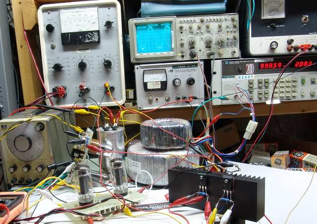

This picture shows the setup. The BIG toroid is the Plitron OPT. It is not connected in this test. The surplus power toroid is on top of it. The transistors are mounted on the heat sink on the right. It barely gets warm. Scope trace and analyzer readings are at 50 watts, 2% distortion. Note the pegged current meter on the Fluke PS.
I gave some thought to the suggestion of using 6146's for screen drive. I am not sure that they would be a good choice. A screen drive amp runs in near class B operation. The tubes draw very little current at idle, but the current rises quickly as the audio signal drives the tubes into conduction. Sweep tubes have a high peak cathode current capability. The 6146 has a maximum plate current spec of 135 ma. The peak cathode current is not specified. The little 6BQ6 has a 400 mA peak spec, the 6CB5 has a 770 mA spec, and the 6LW6 has a 1.4 AMP peak cathode current spec. Just look at the size difference in the cathodes themselves.
I don't have any 6146's here to test. I have some in the warehouse, so this is all conjecture at this point.
The 6146B datasheet I looked at has the max current spec at 175 mA CCS spec or 220 mA ICAS spec. Maybe it's the difference (135 mA vs 175 mA) between the A,B versions.

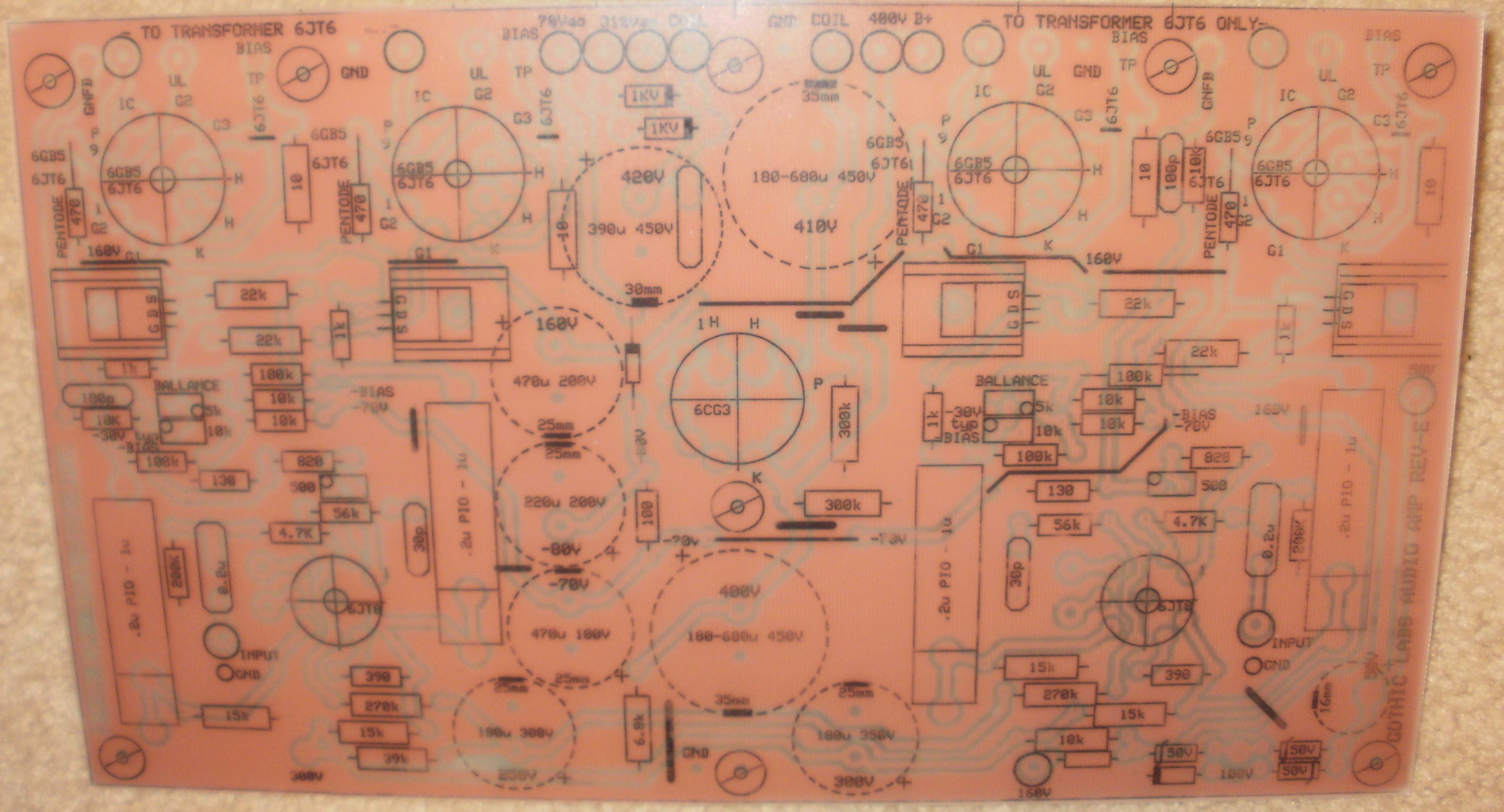

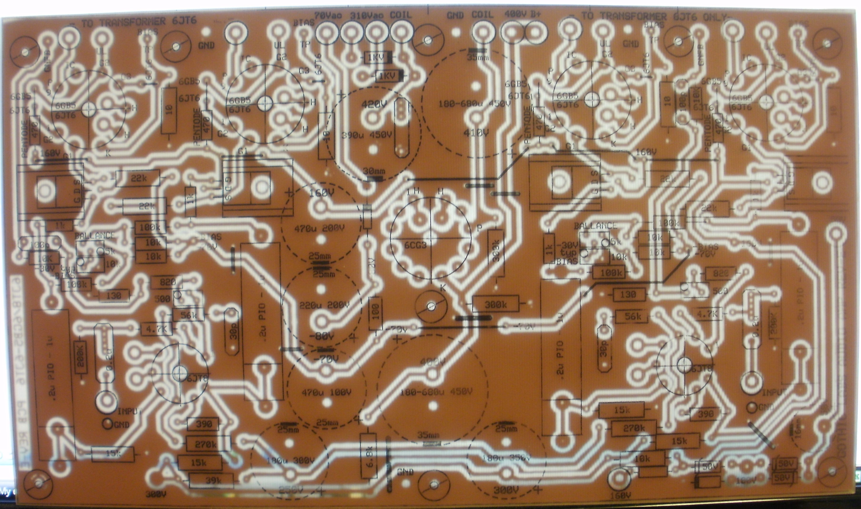

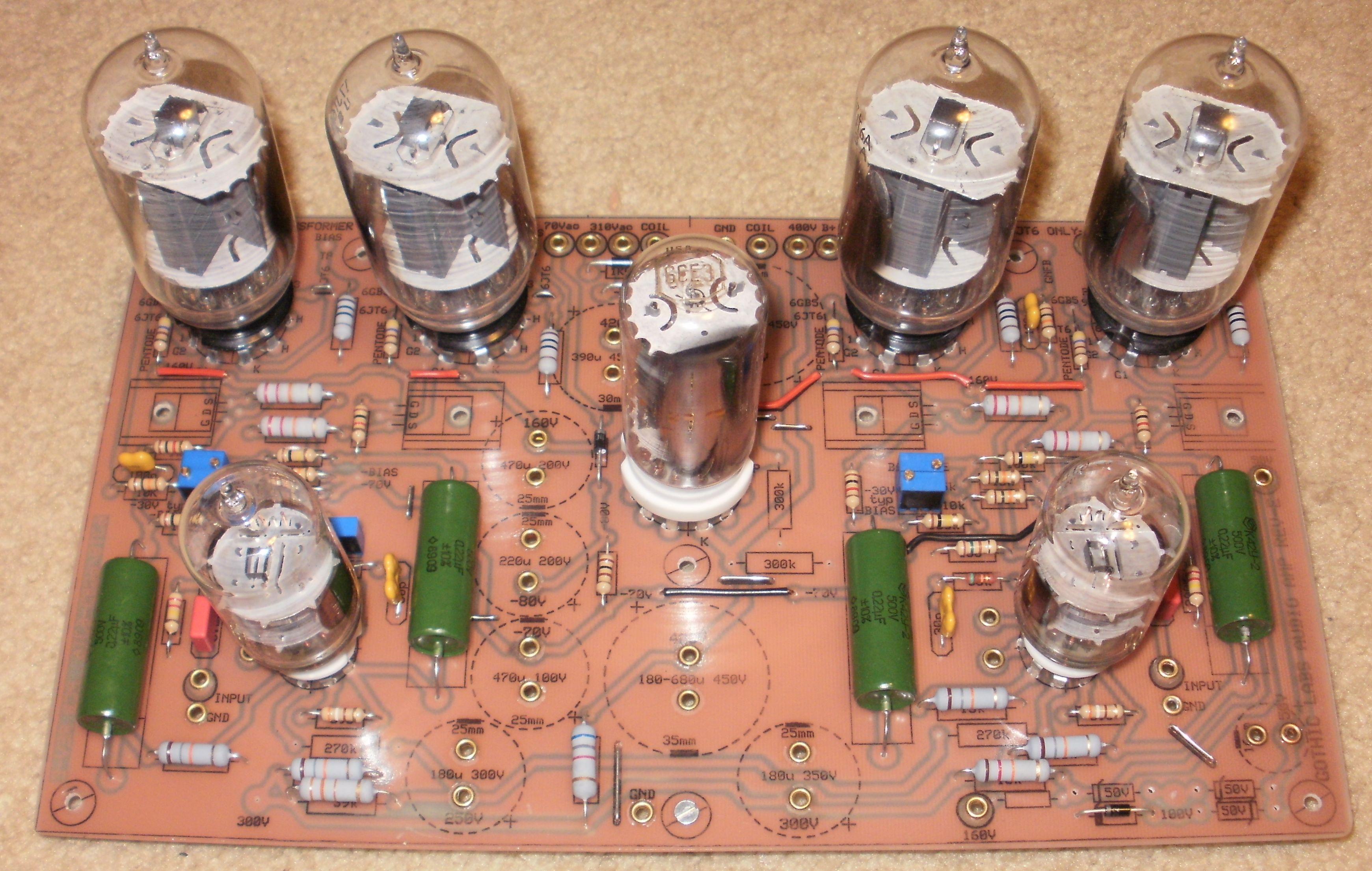

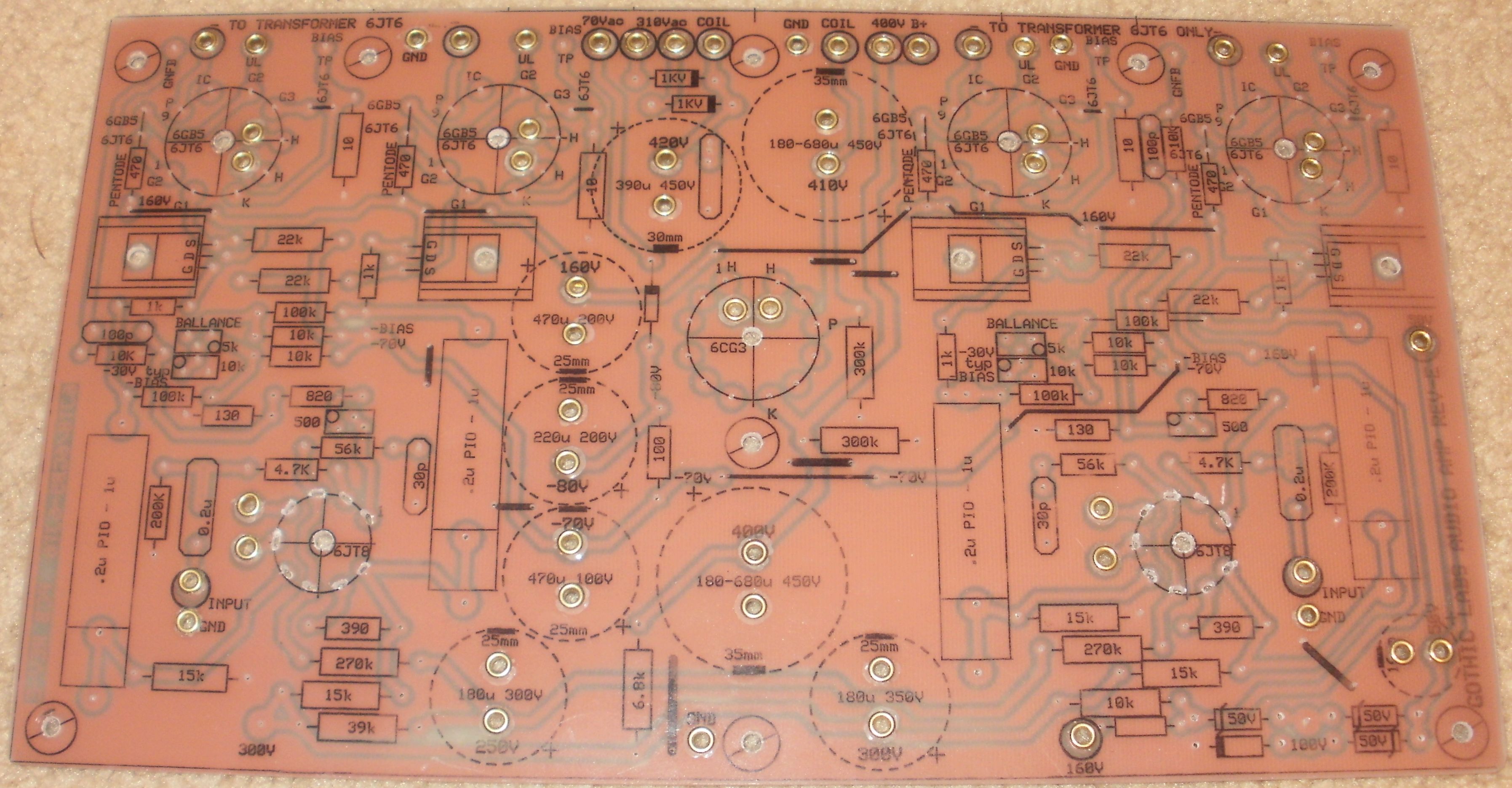

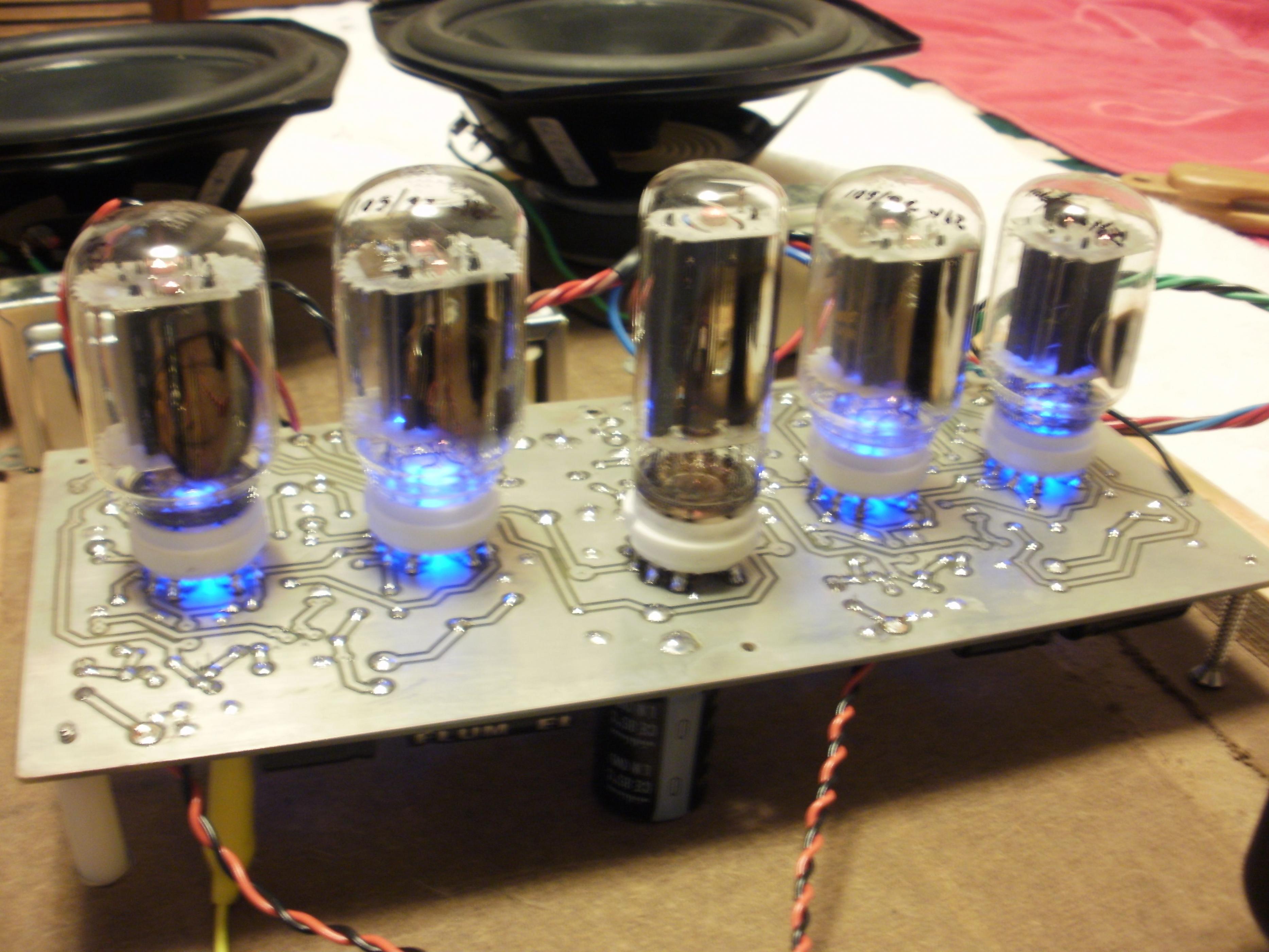

I started a PCB design that can use *JT6 or *GB5 tubes depending on a couple jumpers, both being 9 pin sockets. I contacted Edcor to see if they would be willing to make a custom heater tapped PT to use the 13, 17-18 and 21 volt heater tubes still available, i n process but no answer yet. Simple design with FET follower grid drive on the output tubes, can be bypassed and a few components left off...
PCB has B+, bias -70V and 6CG3 for slow start, again can be left off and bypassed.
What is a good Mosfet for the grid driver? IRF 710????????? I'm using the 160 volt for the upper rail and -70volt for the bottom rail for it, DC coupled to the gate, that should be good for +-60volt swing....
Thinking that with 17watt dissipation, 400V and 45ma on the bias, that keeps the caps single and not stacked keeping the cost down. I did this same concept on a Quad Spud'ed 6LU8 amp that I've been playing with, sounds great with 6.6k Bogen iron. I etched it with the copper side up, to have the bias pots on the bottom side to minimize the holes in the top plate. The pics are from the initial fire-up to see if the "magic smoke genie" would appear.

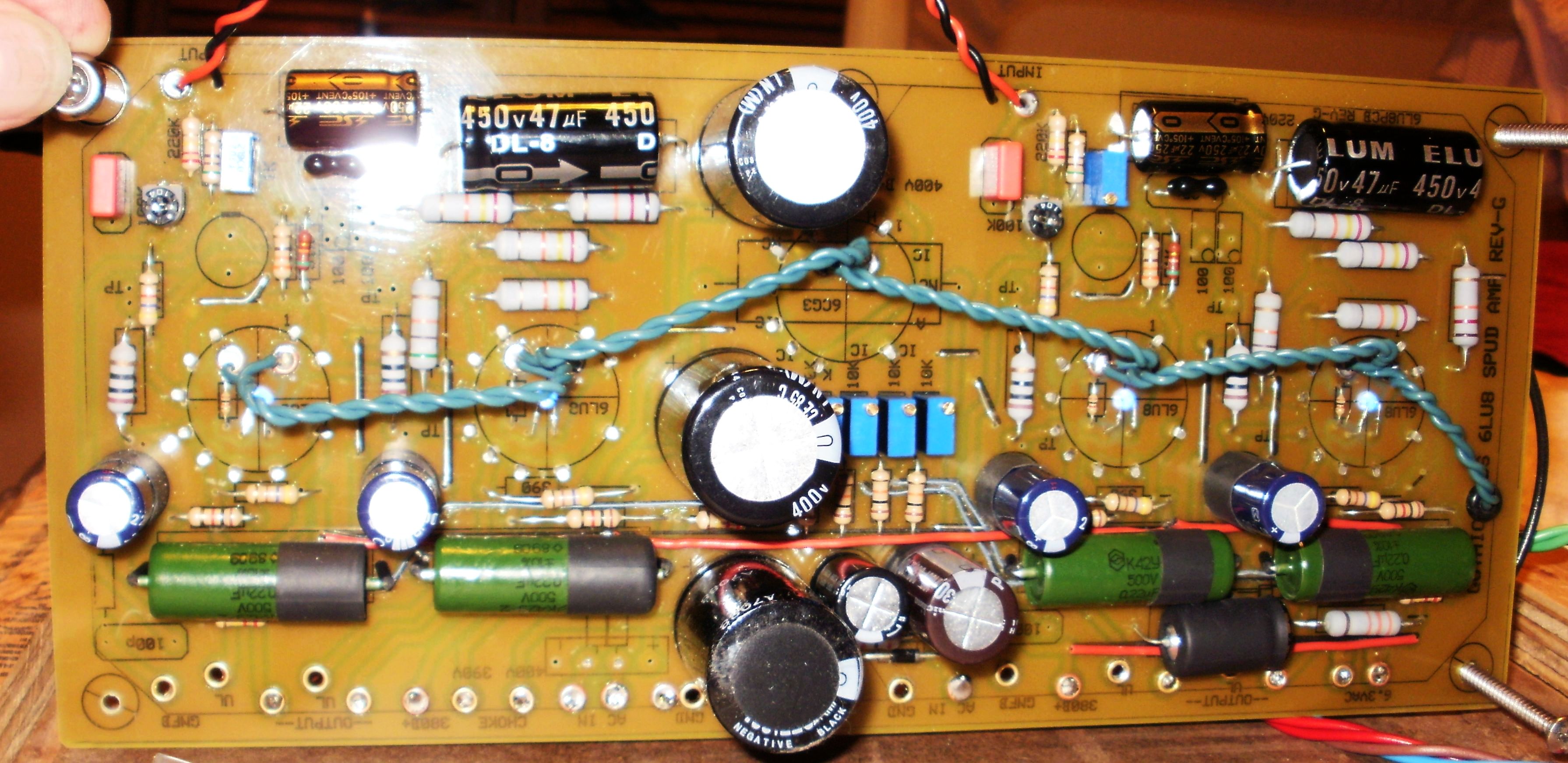

Cheap PP Power Amp.
Still scrounging components, but have it etched and ready to tin plate the back side prior to the drilling marathon. For Mosfets, I found some K2700 to play with. They are electrically isolated at the tab for easy mounting. I'm sure that they will not be able to transfer heat as well, but they are not that stressed, should not require it.
I left another message at Edcor to see if they are interested in winding a custom heater PT, 6.3, 13, 17.5 and 21 VAC for the weird ones. They have the tinker box series that is close, just need to add the B+ and bias and change the heater targets.
I have a couple flats of 17JT6 tubes to play with and can use a 18VCT short term to supplement a "normal" 6.3VCT heater PT. I also have some 18GB5 tubes to try.....
The B+ is targeted to be 400V so 450V caps can be used. The 6GC3 is for slow B+ start. and for those that don't care, it can be left out and jumper-ed. The output tubes are setup for Mosfet grid drive, again can be left out and jumper-ed if not wanted... but I like the idea of reducing the possibility of blocking distortion when driven hard.
I have a set of 40watt 6.6KRaa Hammonds for outputs, old style without the UL taps. I'll configure in Pentode mode first and compare against the 6LU8 PP amp in the previous post. It has been the daily driver for a couple months. A very sweet amp, maybe due to the Bogen output iron.

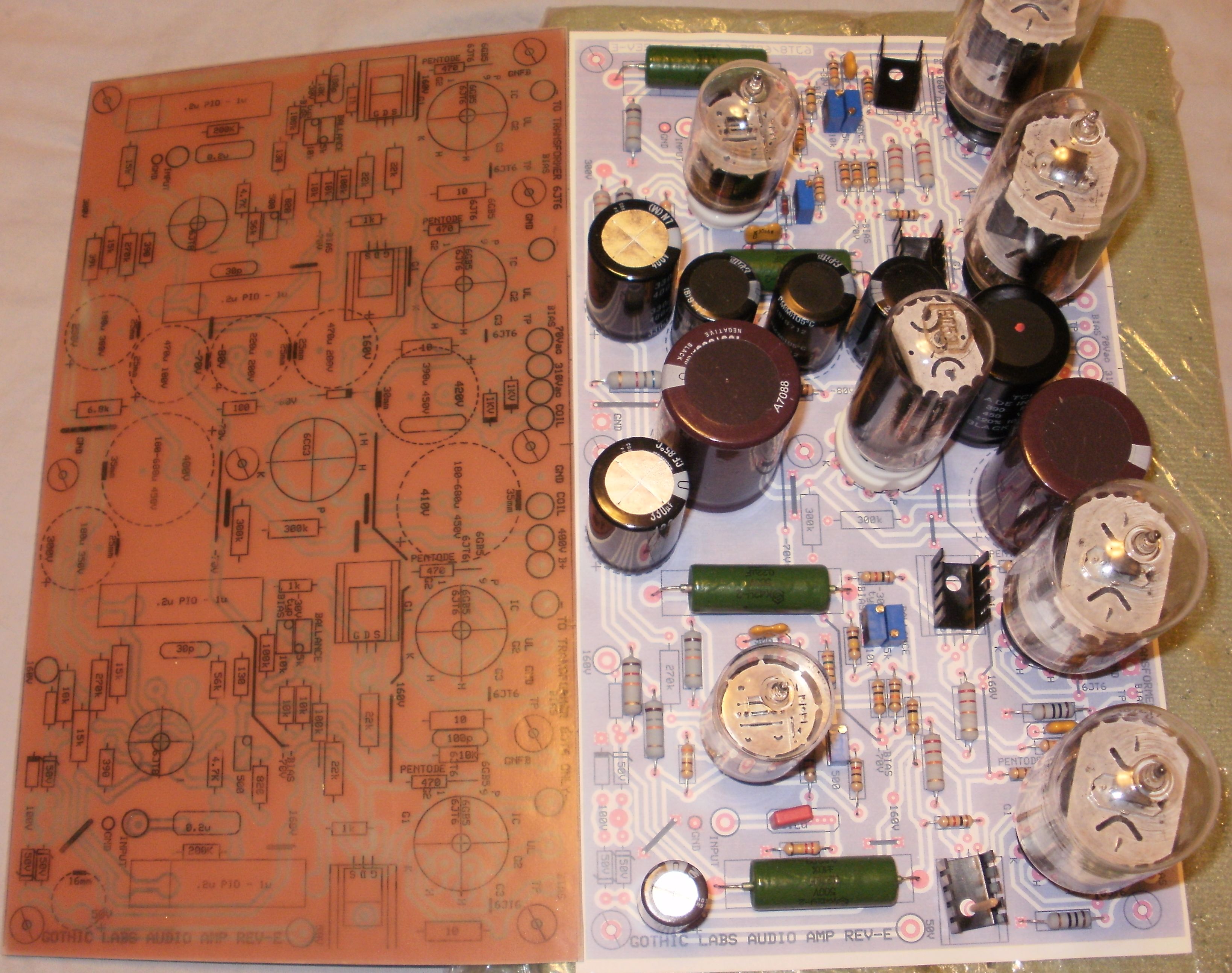

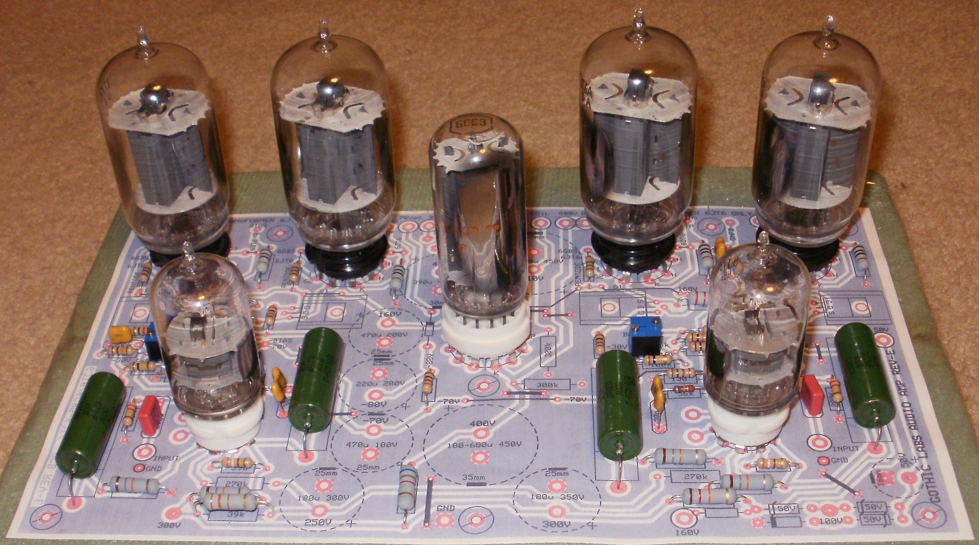

Cheap PP Power Amp.

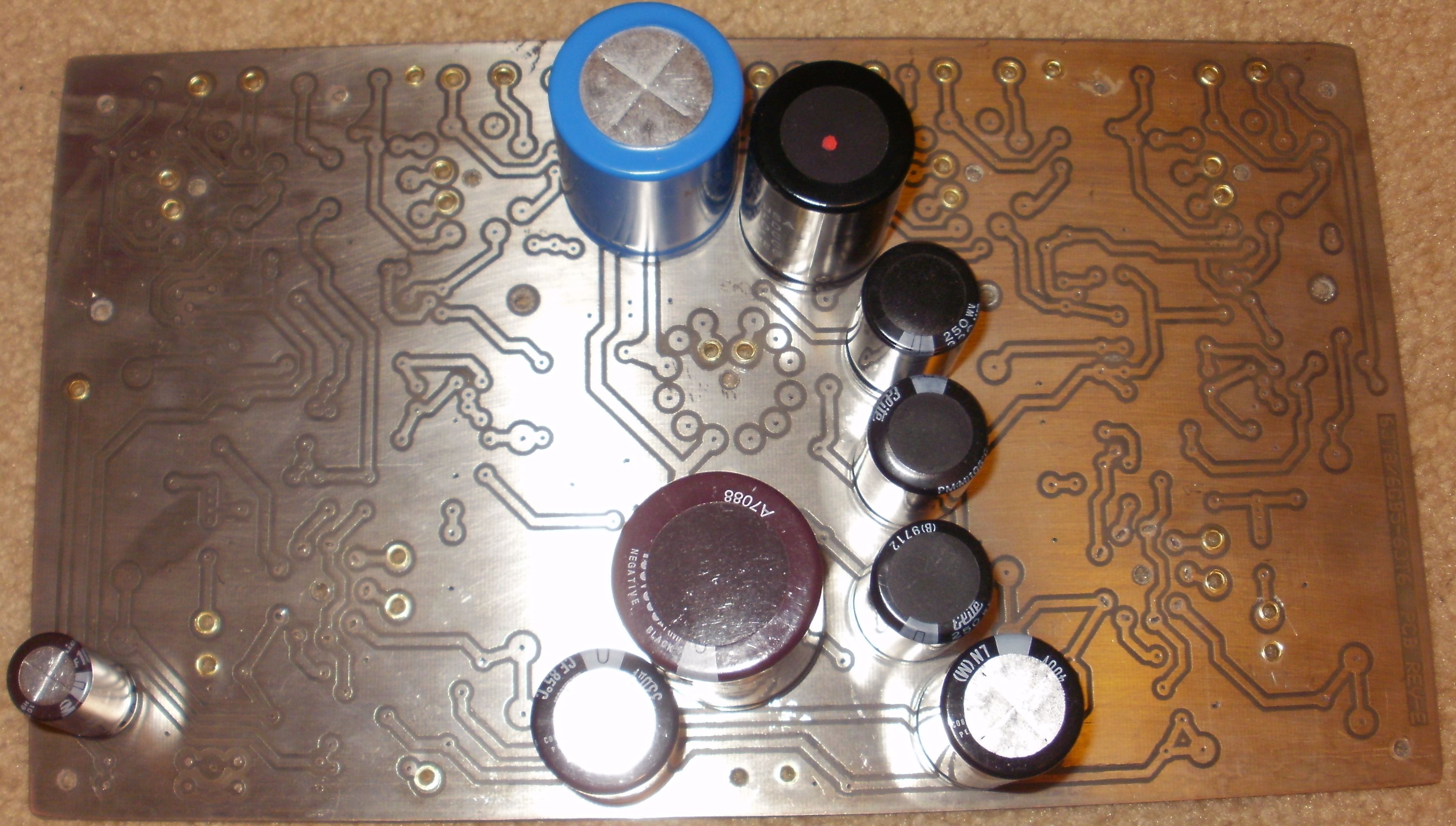

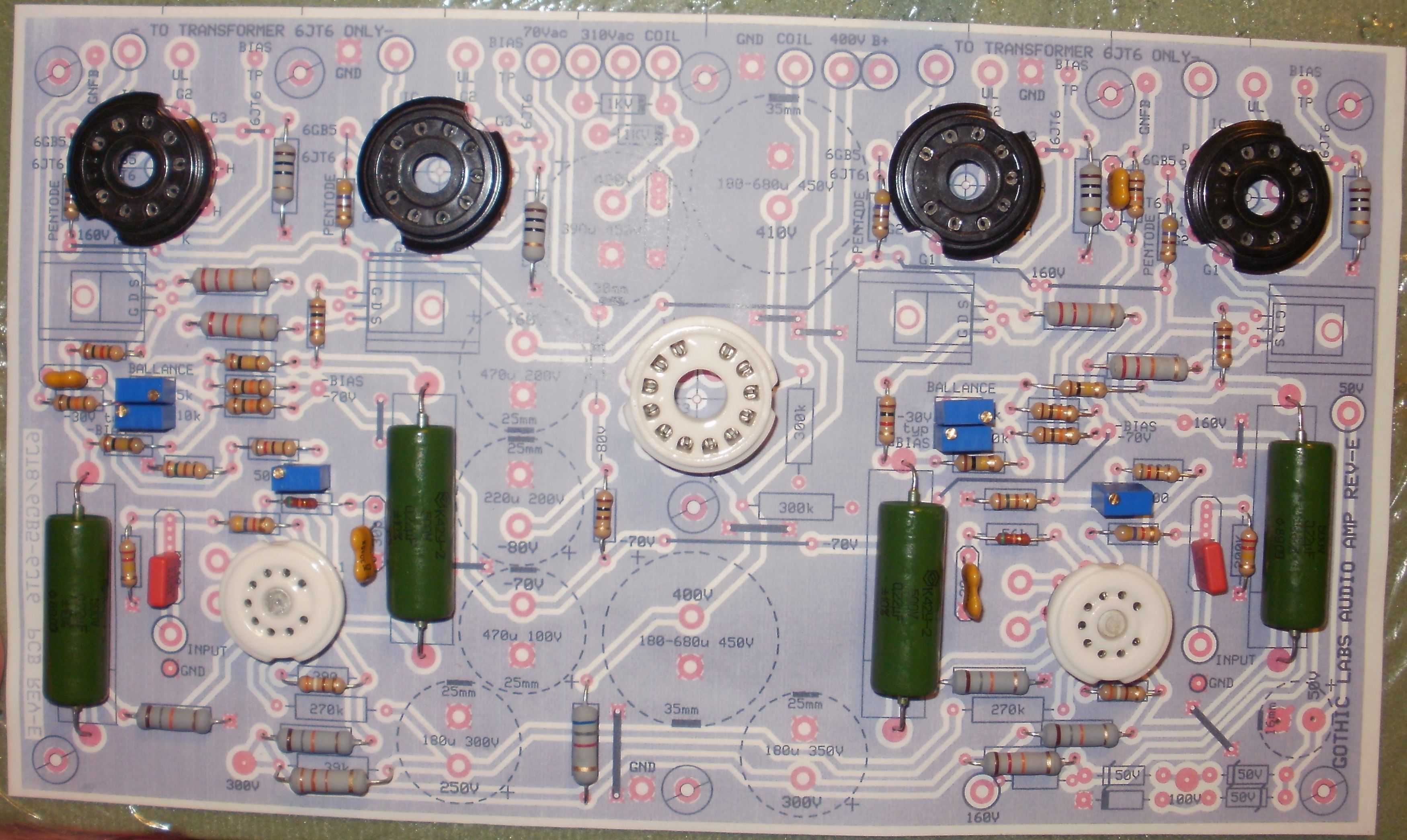

Still need to drill/elongate tube holes/slots for output and 6CG3 tube sockets. All eyelets installed for functional feed throughs for heavy wires and caps on the back side. Quick spacing check verifies the mock-up worked for confirmation for fit.. If I need to, the PIO coupling caps can also go on the back side.
I've placed an order for the sockets, so I should be able to complete the drilling and start the soldering marathon soon. I found a 18Vct 5Amp filament transformer to supplement the 300VAC B+ iron for the 17JT6 flavor. Still a few more components to scrounge.......

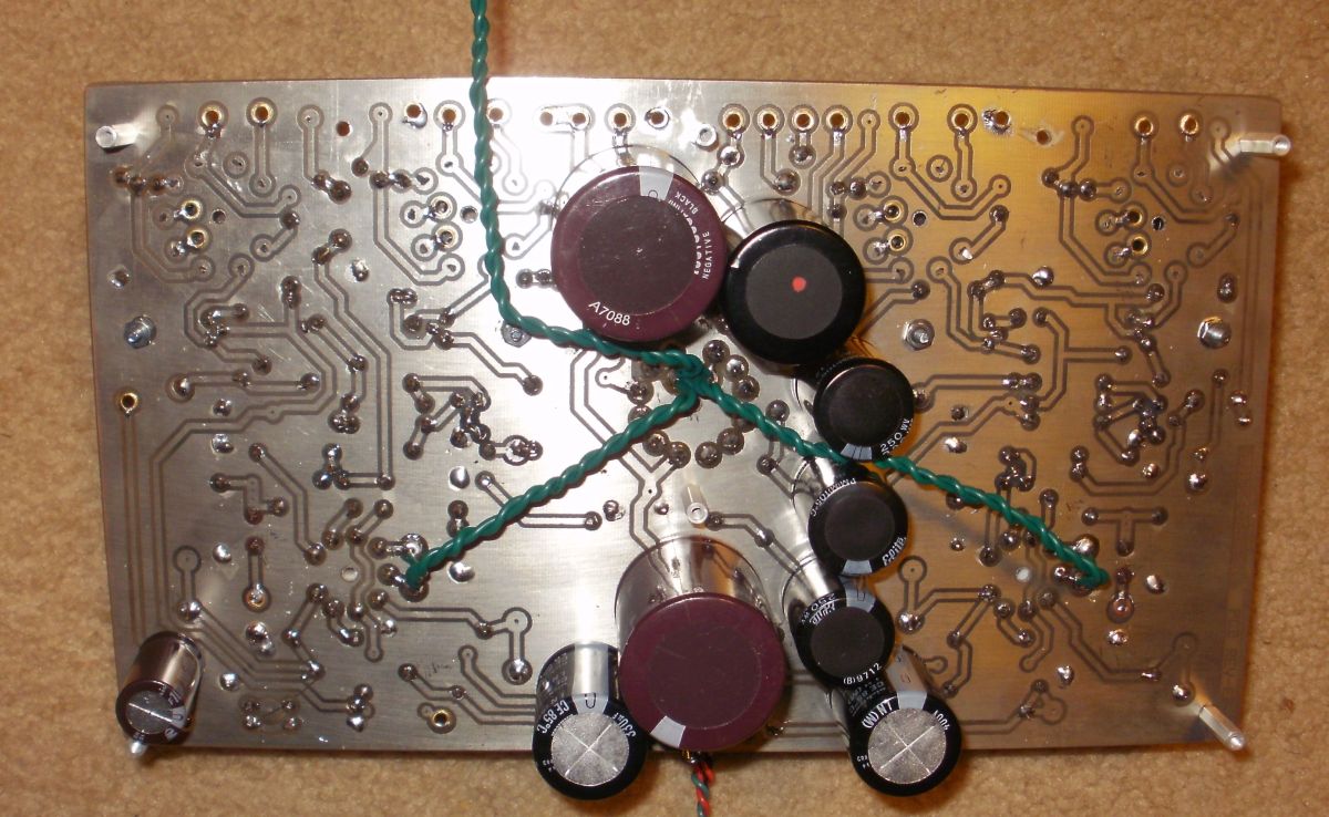

I use shorting leads across the Mosfets, they will be pulled prior to firing up. Started the heater wiring for the 6volt section, I will complete the 17Volt section after installing ceramic sockets for the outputs. I have some for Magnovar sockets but they are designed for pins that are 0.010" bigger in Dia so there is not enough interference with the 0.036" dia. pins.

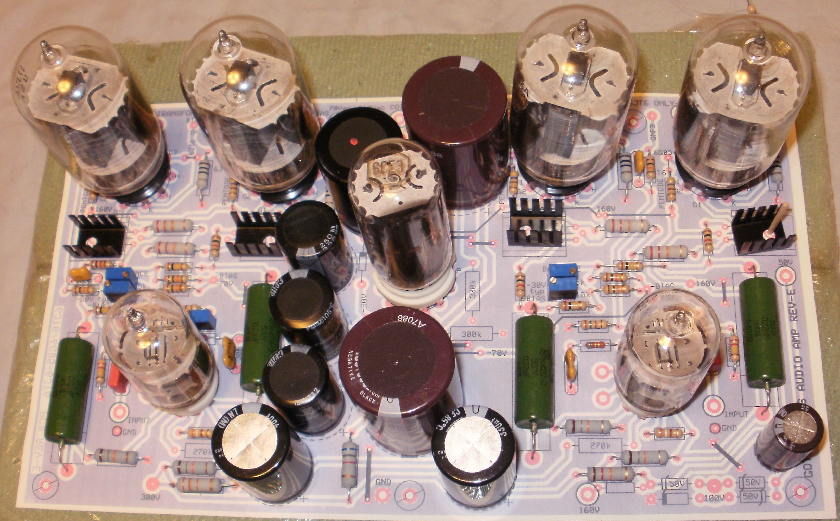

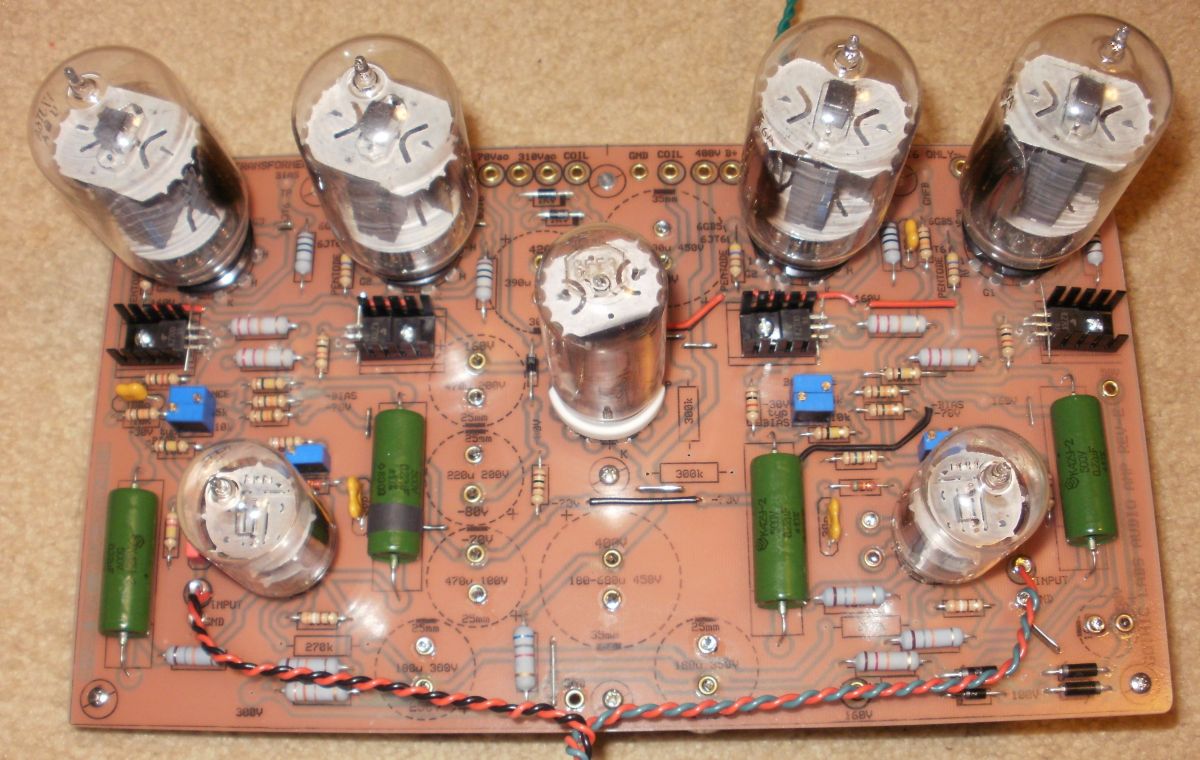

Finished stuffing and did the initial fire-up. I used a Hammond 300-70-0-300 PT with a separate 18V filament PT just for the output tubes.
Replaced the 6.8K 2 watt with a power 100V zener, 100v zener, mosfet and heatsink, the 6.8K was too warm dropping from 400 to 300 volts. The 300V also supplies the 160V supply for the mosfet drive circuit and 250V first stage.
The rest are OK and initial bias adjustment was set to -36volts. The 17JT6 should should be throttled at that initial bias. I'l use 6.6K 40 watt Hammonds, I have an old style set without the UL taps.
