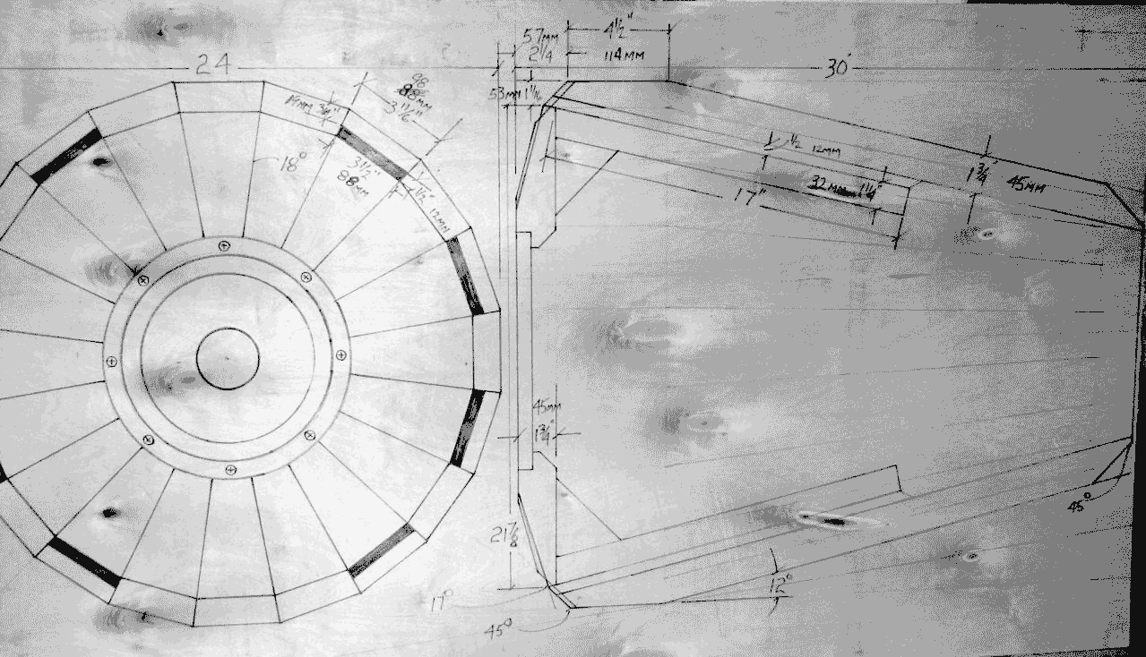

Designing a cabinet for Mark Audio Alpair 7.3
Nice looking design. I will echo the sentiments of those before and say CNC would be an awful waste. What I call "Bendy plywood" would work a treat, otherwise, if you are a glutton for punishment you would cut kerfs in regular sheet plywood to achieve the bending properties / curve required. Its not difficult but is time consuming. The tops are easy enough to shape.
The only other concern would be calculating / measuring the volume of enclosure and even that would not be too much trouble getting an estimate of.
I did something around two years ago, a stand mount two way speaker, roughly the shape of an elongated guitar body and used kerfing.

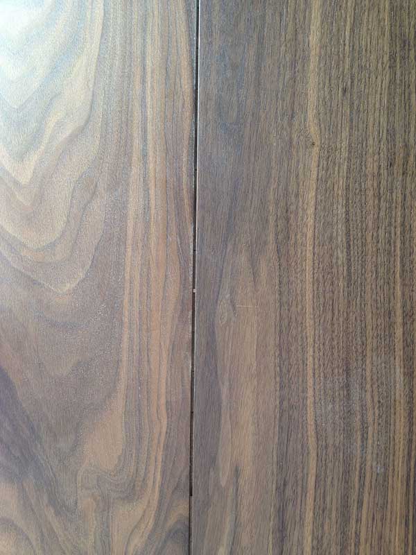

Been researching materials and came across an interesting product.
1mm solid wood backing
7 layer ply (10mm)
4mm solid wood 'veneer'

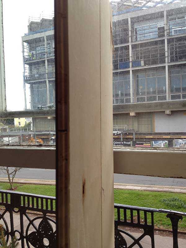

They are engineered solid wood floor boards. I plan on glueing them together onto an 3mm mdf backing to ensure they lie flat an them power sand the finish off.
I was looking at them for building a pair of the Pensils, but have decided to do a test mockup using the Alpair 7.3 and one of Planet 10's small bass reflex cabinets.
As they were surplus to the flooring shop and a little scuffy I got them for £10 a board. Two should be enough to make a pair.
I also plan on putting round lippings on the corners......a sketch up picture to follow.

Having finished the above cabinet, its time to start thinking about the next.
Has anyone seem an Alpair in a cabinet like this.
It would be a challenging project....
Have the 7.3 sat in a turned coopered bowl, on top of 2xlarge subs, Peerles XLS 10" for example. With a curved plywood skin, similar to the B&W 800.
Thoughts?
