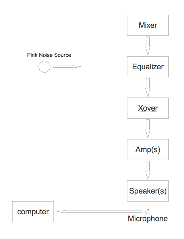

I really don't know enough about how that minidsp works and how this works with a microphone hooked to a computer.
There should be a pink noise source, and I'm wondering how that's generated.
Where to inject the pink noise also needs to be properly considered. Should be at least before equalization, to make sure the equalizer is in the chain.
Roughly, my overall scheme would be something like on that attached diagram.
The longest link would be between the equalizer and the xover, which would have to be balanced.
If the pink noise source also comes from the computer that runs the analyzer software, then that requires that computer to be fairly near the equalizer/mixer, and that could be pretty far from the xover and speakers, so there are considerations to take into account there.

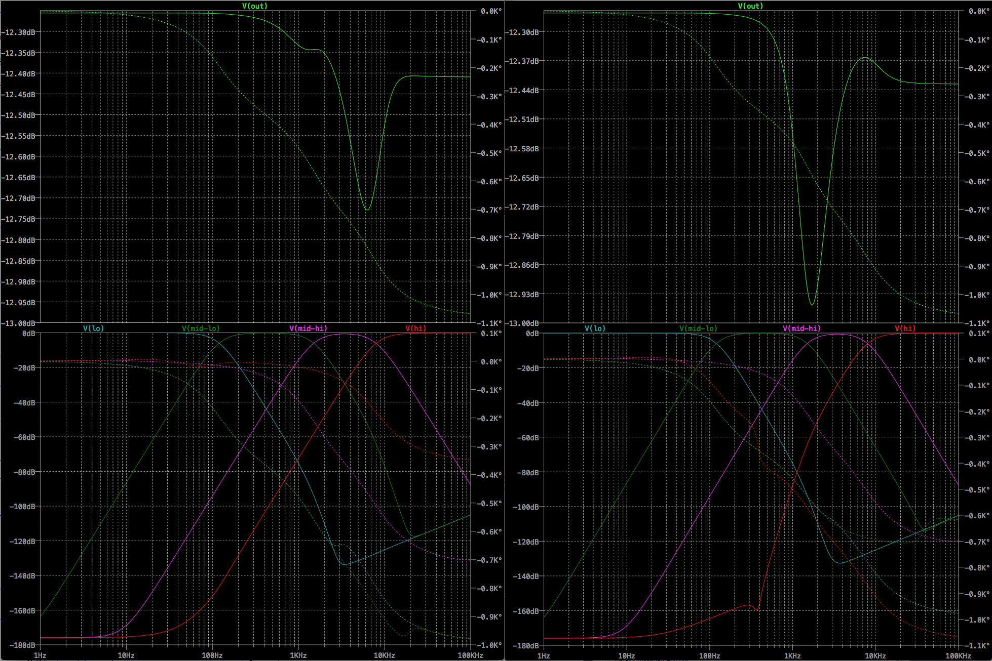

I finally made an alternate arrangement sim for the 4 way xover that I posted about earlier, as it's proposed by Rod Elliott, for comparison.
I first split in two, then each half split again, instead of the cascading scheme he proposes.
And I ran the same sim on each and put both plots next to each other for better comparison (attached). The plot on the left is the ESP proposed arrangement.
I'm not really sure it would be any better by splitting this way as opposed to cascaded.
There is a larger dip in the summed output with the split scheme, and that dip happens at a bit lower frequency. The lowest point in that dipped output summed response is somewhere near 6.5khz with the ESP cascaded scheme, while that deeper dip with the split scheme is at a little less than 1.8khz, with almost 0.25db of dipping with the split scheme, compared to cascaded.
The phase response looks somewhat similar, except maybe a tad more chaotic with the split scheme.
I don't think splitting this way brings much improvement, if any, except perhaps for the fact that all 4 bands have the same exact number of filter cells in the signal's path.
The cascaded scheme leaves only a single filter cell in the signal path for the highest band, which would be the one most affected by having more circuitry involved.

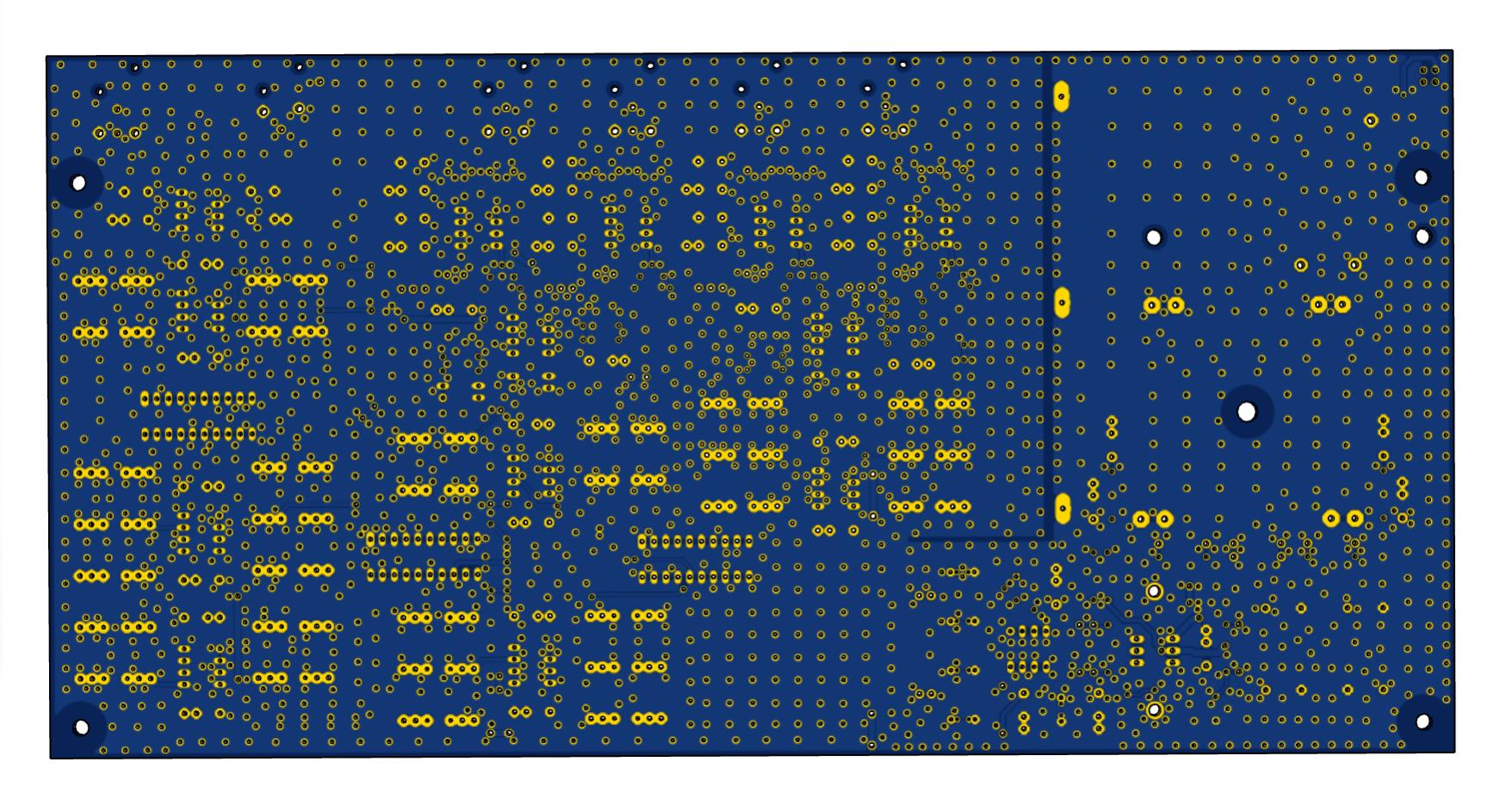

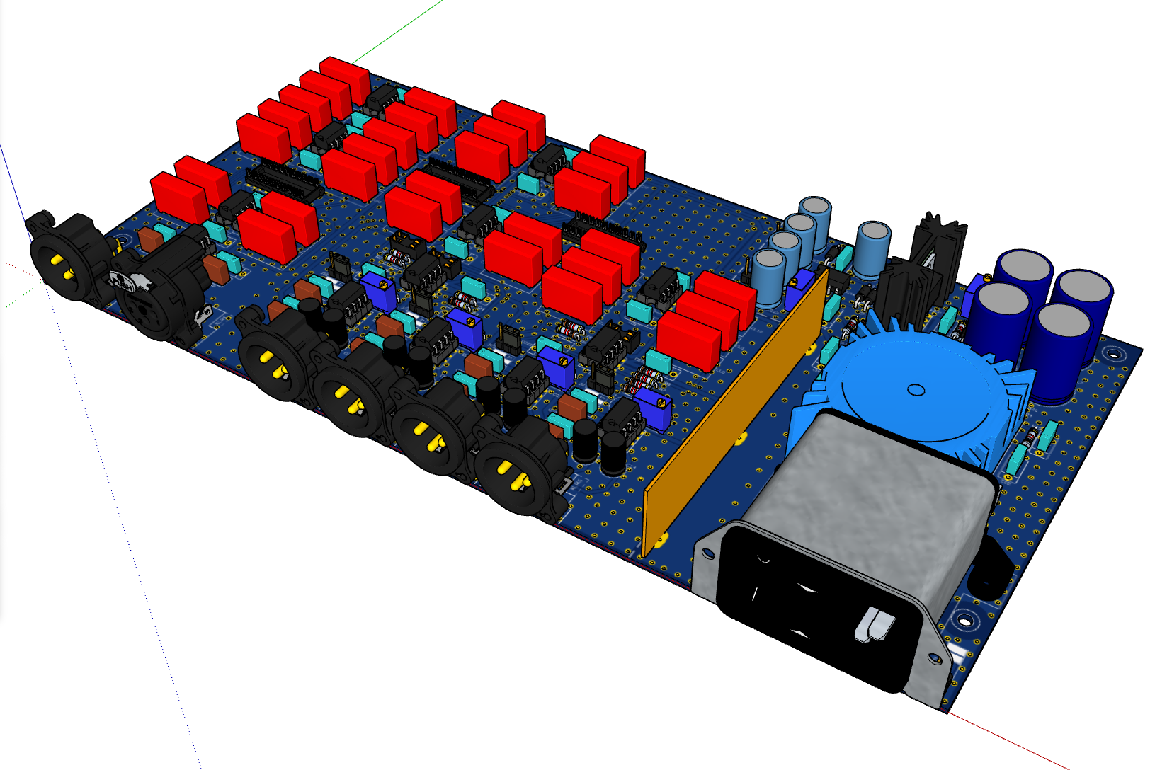

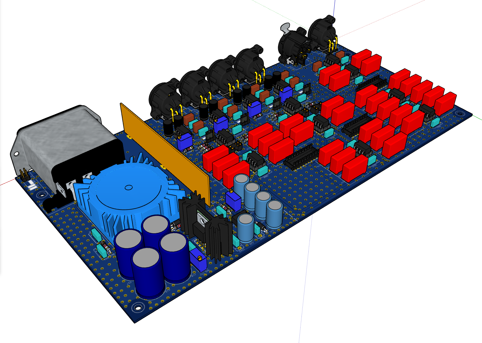

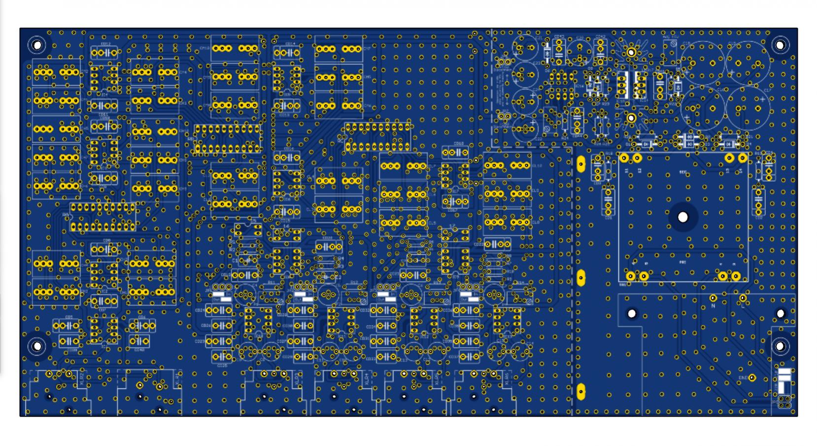

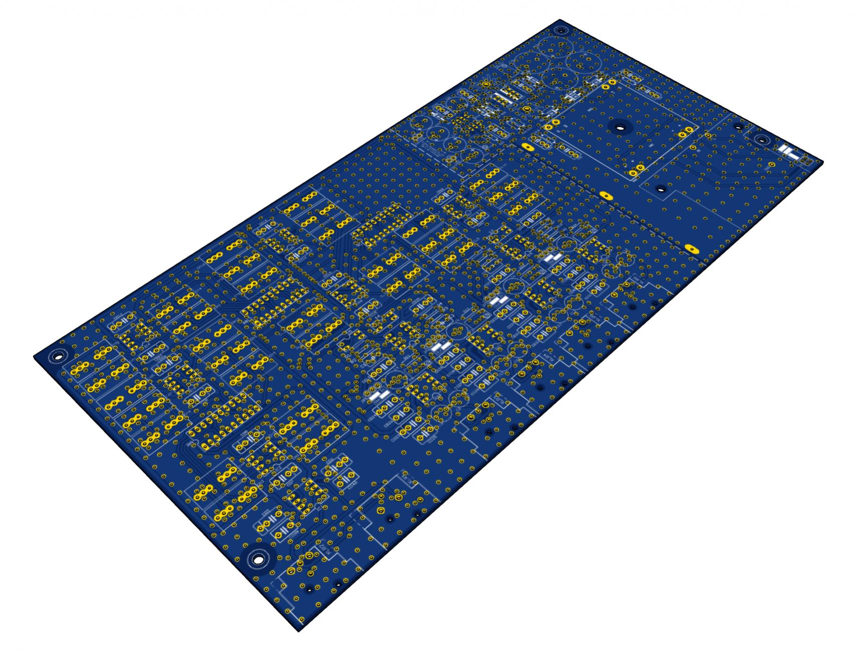

Having compared the behavior between the ESP proposed cascaded arrangement vs the split twice arrangement for the filter cells, in view of how much deviation there is from the flat response, the ESP cascaded version is flatter, so I retained that option.
I am putting the resistors setting the xover frequencies on component sockets, which in turn are on IC sockets, so easily interchangeable in case a different xover frequency needs to be used.
I put all-pass/delays and inverter that can be disabled with jumpers, in case they're needed or not, and their frequency setting parts are also on component sockets in case they need changing, plus those sockets can be rotated to change their delay/leading action.
After that, before outputting via balanced line drivers, the levels are adjustable.
So, xover frequencies can be chosen, delay/leading/inverting can be added, or not, and level adjusted on each channel. So it can be adjusted as needed, from measurements.
I decided to xover at 120Hz instead of 150Hz for the Lo channel, but that can easily be changed as needed.
Having the parts on component sockets allows putting in whatever we want and calculated. If measurements require something different, it's easy to implement.
Using XLR PCB mounted also eliminate any wiring, as well as using a PCB mounted Power Inlet module and the transformer, so everything can all be fitted on a single PCB with zero lose wiring.
I entered the schematics in Eagle and the attachement is the current schematic for the filters. The PSU and all decoupling caps are on a second sch sheet, which I'll post later.
I've been thinking about what would be required at the input before the balanced line receivers, and I don't see what I could add that wouldn't cause some side effects, except perhaps for some kind of EMI filter, maybe with ferrite beads and some kind of caps that wrap around the lines...
I haven't found the right type of such EMI input filter, so for now I left the balanced line going straight into the line receiver.
Just in case, I put both a male and female XLR input plug, which allows a pass through.
I thought I'd try a decent PSU design with all discrete stuff, and simulated one that works nicely with a good ripple rejection, better I think than IC regulators like the 78xx/79xx or even LM317/337. But the part count was a bit high and I wanted to add a tracking of the voltages so both polarities would mirror each other as much as possible, so I ended up going back to the LM317/337 option, with an opamp added to track the negative side to the positive, so it's not too bad I think.
Power requirements are pretty low, and I picked a 5VA toroidal transformer for the PSU, PCB mounted. It takes a small amount of PCB real estate to have it all on a single PCB, but then there are no external wires whatsoever afterwards, no even the power cord, which plugs right into the power inlet module, which has a fuse, a switch and an EMI filter. I opted for the Schurter DD22.1121.1111 inlet module, which I wish could have a lighted switch and input voltage selection, but at least it does have most of the wanted features.
The inlet module uses the standard C14 plugs, so anyone anywhere in the world can use the appropriate power cord with the plugs in use locally. That module is rated for 1Amp, which seems low but not for the purpose here, as with a 5VA transformer, we're nowhere near that.
The PSU has 2 trimmers, one to adjust the +15V, which gets tracked automatically to the negative side, and one to adjust the tracking so it can be properly balanced to equal voltages on each side.
I'm inserting jumpers at the PSU +-15V outputs to disconnect the PSU from the rest while it's being adjusted, so at assembly time, before the first power up, those jumpers shouldn't be fitted before the proper adjustments have been made with the trimmers. A simple operation with a digital meter.
I'm planning everything to fit with space to spare on a PCB sized at 150x300mm. I plan to add an automatic muting, to prevent any plops or whatever at power up or down, but that remains to be designed and added.

Working on a PCB layout. Everything already on the schematics can easily fit on the single 150x300mm PCB, using the bottom layer as ground plane. The goal being to try to avoid as much as possible to route anything on the ground plane, only very few and very short traces at the most, to avoid breaking that plane.
I've been thinking a small shield might be useful to limit the transformer's influence. It shouldn't have a far reaching influence, so maybe a little distance might suffice, but just in case, I figured adding a small shield would be good to try. Will put out visuals for all this soon...
The tracking opamp can be anything similar, I chose the old faithful 741, but many others have the same footprint and pinout, so wide choice there.
Probably all, if not most, of the parts can be obtained from Mouser, or perhaps Digikey or whatever (Arrow? Future Electronics? Farnell?). I'm hoping nothing would be difficult to get in some countries. And nothing should be overly expensive..

Some views of the board by itself.
