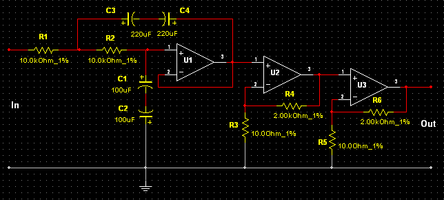

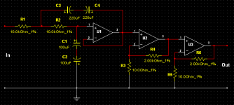

Hi, i was working on this for you before DUG posted, but i thought i'd post it anyway.
This works fine in Sim. You can choose a filter below 1Hz as i have, so a 12dB per octave one should be OK.
Use Ultra Low Offset OpAmps such as OPA177 for eg. You could use a 5k Ohm Trimpot for R6 to alter the gain to suit. And also make use of the OpAmps offset terminals to trim out any internal offsets.

Yes, thanks for the model and your thoughts.
It looks like you used a two single pole (first order) filters - I need at least 5 pole or more to get enough attenuation by 10Hz. Also, I don't want to reduce the corner frequency below 1Hz because the filter time constant becomes too long and I won't be able to measure second-by-second changes in the signal.
There is no way I want to trim out all those op amps!!! I'm thinking of using the LTC1052 (quad chopper op-amp) even though it is rather pricey.
So maybe three or four MFB LP filter stages with gain would work for my needs. I will sim that up tomorrow but would love to hear more feedback.

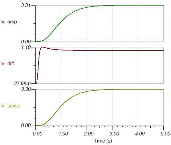

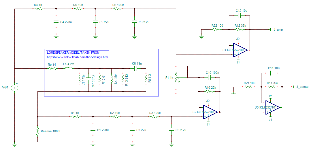

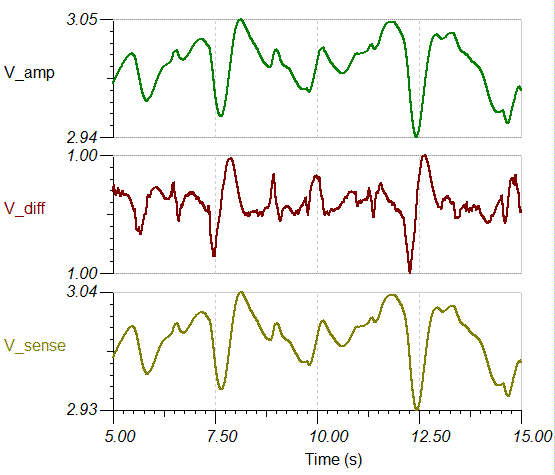

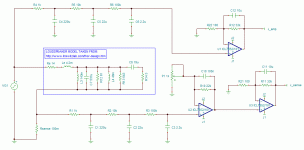

Here are more details on the circuit, and application.
GOAL:
The goal is to dynamically measure the voice coil resistance of a driver during use. A "sense" resistor is connected after the driver, to ground, and the driving amplifier has an intentional DC voltage offset of a few millivolts. The ratio of the voltage drop at DC across the driver and across the sense resistor can be used to determine the voice coil DC resistance, Re. The changes in Re with power input due to VC heating can be tracked by the circuit described below, with a time resolution of about 1 second. This should make it suitable for use with woofers and larger midrange drivers.
CIRCUIT DESCRIPTION:
The circuit that I have been using to simulate this is attached below as "Driver_VC_resistance_measurement_circuit" and "Arduino_processing_of_VC_measurement". To sense the DC voltage I use three single pole RC low-pass filters, each having a corner frequency of about 1 Hz. The filtered signal is then sent through one or more gain stages. One gain stage operating on the voltage coming from Rsense is used to multiply by the ratio of Re/Rsense, which is 35 times using the loudspeaker model shown in the circuit. There are two separate measurements taken, one at the amplifier output and the other at the sense resistor. As shown in the attachment "Arduino_processing_of_VC_measurement" the gain-scaled voltages will be acquired by an Arduino, DC offset removed from each voltage feed, and then the ratio calculated. Because of the 35x gain stage mentioned above, the ratio of the voltages is now equal to Re(T)/Re(T=To) where T is the current temperature of the voice coil and To is some reference temperature (e.g. room temperature) to which the system was calibrated. Although temperature is not directly (or indirectly) measured it could be calculated using the tempco of the voice coil material. The Arduino is useful as way to monitor and display information and also because it is a simple matter perform the division operation in software. The Arduino can sample 0-5V with a 10-bit (4.7mv) resolution. In order to make better use of the range and resolution, the gain stages are used to bring up the nominal voltage to around 3V when a 10mV DC offset is supplied by the amplifier. The full 5V range could be used by increasing the amplifier's DC signal to 15mV, or by using more gain.
CIRCUIT SIMULATIONS (see attached figures):
THOUGHTS:

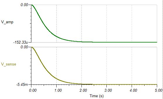

It looks like this circuit could work for dynamically measuring Re. In the sim, I have used a low-offset, chopper-stabilized op-amp that also has a very low DC-offset temperature dependence. This may make it possible to do a one-time calibration only. I need to check the influence of the tempco of the resistors in the gain stages, since these can also effect the performance. This may only be of concern if all the circuitry was located in the same housing as the amplifier or other heat-producing circuitry. If temperature dependence is not of concern, it may be possible to use other amplifiers depending on the amount of DC offset that will be produced. I have not make any effort to reduce DC offsets in the gain stages, and some changes in component values or topology (inverting gain stages?) might reduce the offset further. Any suggestions are welcome in this area.
One issue that I have not yet tackled is how to get the power amplifier to generate a reasonably stable DC offset of around 10mV. I thought that a DC servo could be used, but instead of trying to zero out the DC offset the servo would bring the offset voltage to the desired setpoint. Since I can directly measure the DC offset, I could also use one of the Arduino's output pins to send a voltage through a resistor to the amplifier's inverting or non-inverting input to control the DC offset. Both of these will require a dedicated amplifier design, e.g. you probably won't be able to use a commercial amplifier since few are DC coupled, unless by itself it happens to have an appropriate and stable DC offset...
That's where things stand for now...
-Charlie

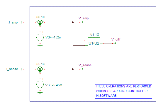

GOAL:
- "offset_calibration" shows the response of the circuit with the amplifier output grounded (no DC offset voltage). For this sim, the offset correction voltages in the Arduino were set to zero. The voltages stabilize to the DC offset of the circuit, and these are subsequently programmed into the Arduino to remove the effect of the small offset on the voltage ratio calculation.
- "Response_with_10mV_DC_input" is a sim of the circuit response with the DC offset corrections applied, and the amplifier set to have a 10mV DC offset (no AC signal present). The calculated ratio "V_diff" is very close to 1.0, meaning that the current value of Re is the same as when Re is at its "cold" value of 3.5 ohms (see loudspeaker model).

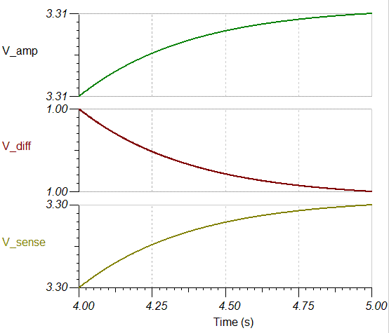

- "Response_with_10mV_DC_input_zoom" is the portion of "Response_with_10mV_DC_input" lying between 4 and 5 seconds, to more clearly show that V_diff is very close to 1.0.

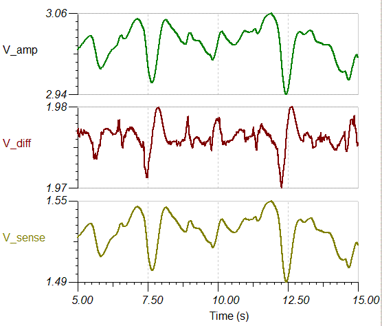

- "Response_to_music_input" is a sim of the circuit to a music input. This was done by reproducing the first 15 seconds of Tracy Chapmans' "Fast Car" by the amplifier with voltage swing up to about 40Vpk-pk. The response of V_diff still shows the correct value of 1.0.
- "Response_to_music_input_with_Re_doubled" shows the effect of doubling Re in the loudspeaker model using the same "Fast Car" sim as above. V_diff has increased to approximately 2, indicating that Re has doubled.
