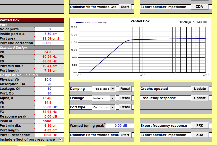

I will try simulate the L12 MB 300, in a 70 to 80 liter ported cabinet.

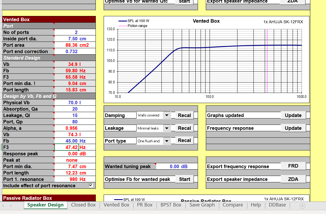

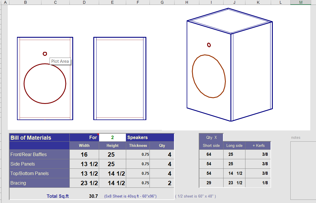

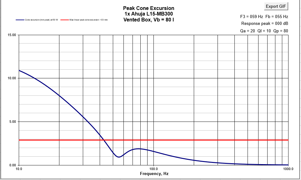

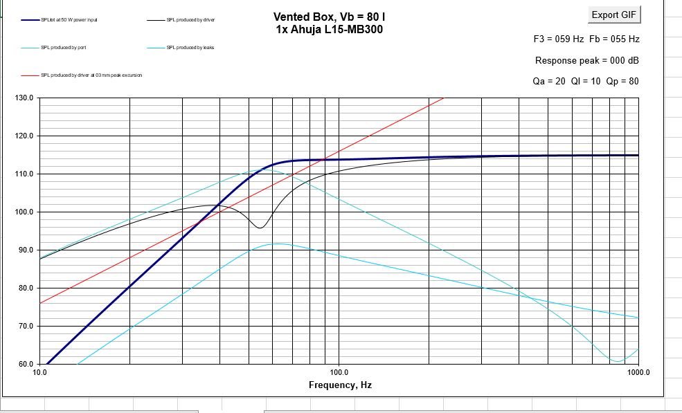

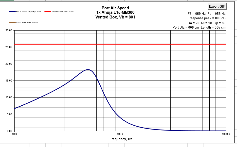

Here is a quick check of the ported box alignment in Unibox and box dimensions in Boxycad.
The woofer is http://www.ahujaradios.co.in/Document/0-L12-MB300_OM.pdf
The volume of box is 70 liters tuned to 45Hz. Weight becomes 20kg with 3/4" material and some bracing.
Adding driver weights (~10kg for woofer +horn), the total weight becomes nearly 30kg per box. Two people would be needed to move!
