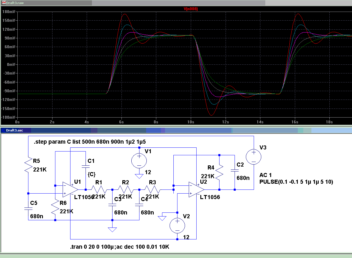

So the servo loop has a damped oscillation. This means that it is not far off instability, which is what I expected. You need to read up about feedback loop stability. Try running a Spice frequency response plot from 1Hz-10Hz - you will see a big peak somewhere. Or measure the actual amp.
Spice plot is uploaded to my website.. scroll to the bottom DIYhifi.dk - Forside
1mHz is +50dB and 20hz is -103dB a bit worse than I rembered..
I think the response is nice, but maybe the +50dB is to much, and that is what makes the swing..
That is a plot of the amplitude of the DC servo open-loop gain? Phase matters too. Can you simulate the whole amplifier? Or do a Bode plot?
50dB at 1mHz is not a problem, as this sets the DC offset error. The problem will be somewhere between 100mHz and 10Hz, where the servo has some gain but also lots of phase shift. If you plot the frequency response of the whole amplifier you will see a big peak in this region. Then you can adjust the DC servo to reduce the size of the peak.

Servo phase added: DIYhifi.dk - Forside
I can not simulate the hole amp, because there are too many components.. but as i remember the servo input to output gain in the transistor stage is 0.8 to 1.0 depending on level.
I have made real life measerments, and the frequency response is totally flat from 0,05 hz to 5mhz..
What is a Bode plot?
OK, it looks like the integrator dominates so by the time the phase has changed sign (to positive feedback) the amplitude is sufficiently low. I am surprised you see a flat response, as I would expect a peak somewhere below 1Hz. The damped ringing of switch-on suggests a peak somewhere. You could estimate the frequency by measuring the frequency of the ringing. Anyway, it doesn't look as bad as I feared.

I think that globally, Lars didn't make a bad job:
The Bode plot is pretty clean, and the analysis with a step excitation shows a mildly oscillatory response. Not exactly optimum, but certainly not alarming either.
The red trace is for a 500n cap in position C28; clearly too small.
Cyan is the original 680n: some overshoot followed by a small undershoot, but acceptable
With 900n (magenta), there is still a hint of overshoot; quasi-optimal
1µ2 (gray) is already too much.
In conclusion, I'd say 1µ is optimal.
Note: I estimated the gain of the various stages rather grossly, and for an accurate analysis, an exact calculation would be necessary.

That is some real nice work you did there.. Thanks 🙂 Really nice simulation results.. And it explains the behavior of my servo.
I am not able to do such fine results myself, so I am very exicited about this.. If there are any thing you need to now about the transistor stage, just ask...

The change of C28 as Elvee suggest will make that much better.
And the opamp protection diodes DF96 suggest, eliminates the startup charge of the servo filter..
The offset of the transistor stage without servo is still below 100mV.
