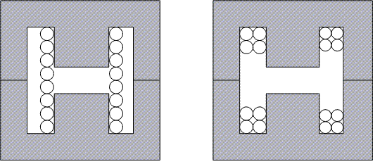

I can check and give my opinion but I am not a coil expert, but maybe it is still helpful.
Below I show what I mean by avoiding the gap area BTW (the left one is the lesser one, the right one the better) :
Regards

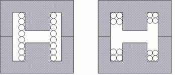

phase_accurate said:
I forgot to post this one which is less complicated to make but still an improvement but which would definitely only work with cores that only have a center airgap:
Wouldn't the total inductance of the inductor in your last diagram be reduced by not placing the windings directly next to the center leg because there's now effectively more air in the gap? (Which would also increase the saturation current and linearity).
