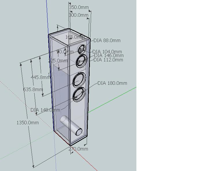

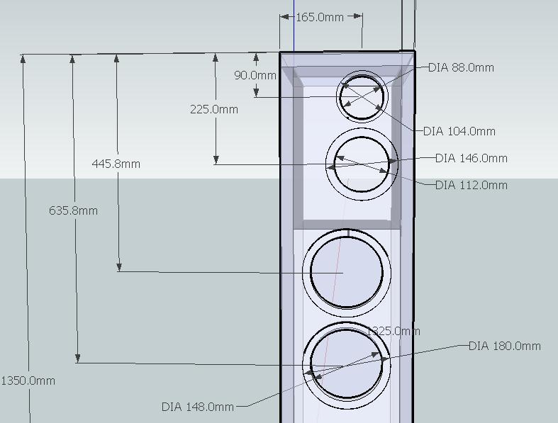

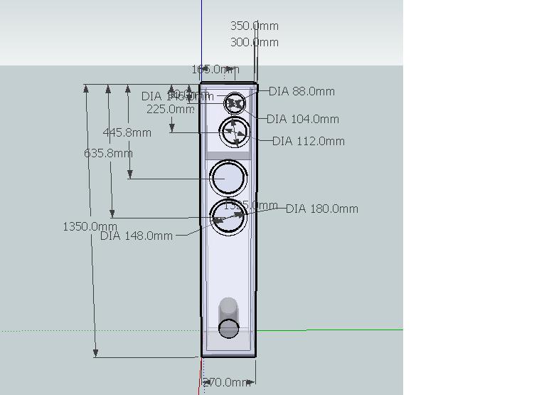

I've attached a few rough mockups of the final design, I'm thinking I may have to make some changes regarding driver spacing, I might try and bring the mid and tweeter closer and I might lower the midfwoofers and seperate them more.
What you might notice is the port goes all the way back to the rear wall, so i've got a few options here, I can either put a bend in the port, but I'm not sure if this is a bit of a no-no for this kind of design, or I can make it a slot port instead which you don't seem to see for Home Audio stuff. Is there a reason for that?
Plus it was my first time using any kind of design software so it's alittle cluttered looking but I have to say the program I used which was Google Sketch-up was nice and simple to use.

Ok so here is what i'm pretty sure will be the final design, i've left the back panel off so you can see the bracing and internal structure better.
The lower chamber is 50-52litres once you take into account space taken by drivers, port, and bracing. The port (35hz tune) shown isn't to length it's just there for reference purposes. the upper midrange chamber won't be as deep as that as there will be another panel in it that reduces the depth to achieve a final volume of about 4.5-5L's and there will be a rear exiting port that will most likely be stuffed to make it like an acoustic vent, I stole the idea from this design, http://www.troelsgravesen.dk/PMS.htm and if it works for him I have no doubts it's a proven technique.
The small chamber at the base of the cab is for xover placement and I can also put some extra weight in the base if I feel it's necessary.
The actual depth of the whole cab once the rear panel is in place will be 35cm and it's 27cm wide, and the construction will be 25mm MDF, and the front edges will be rounded off.
Now I believe the next step is to order my drivers and take some t/s spec measurements free air as well as some FR measurements and then to build the cabs per this design (unless anyone can point out any flaws in the design, please do if you think I've made a big stuff up) and once I have the cabs built mount the drivers and start taking impedance measurements etc... so I can start work on the xover design, as if i'm thinking correctly impedance measurements should be taken with the drivers in there cab rather then free air, or have I got that mixed up?

At a glance:
The driver offset isn't an acceptable acoustic ratio and of course there's no such thing as too much corner round-over until it becomes hemispherical.
Unless the XO is very low, the woofers should be offset too if narrower than the flat portion of the baffle.
Woofers should be physically butted together and either as close as practical to the mid or down at floor level if the XO point/slope is low, high enough. Note that their acoustic center is centered between them if the lower one isn't rolled off enough to be inaudible through the upper bass/mids XO BW.
Woofer chamber is long enough for 1/4 WL vent loading, so restrictive window bracing should be avoided and vent location optimized for best performance. Note that if port damping is used it doesn't need to be as long.
XO chamber needs to be damped enough to not have any audible cavity resonances, so at minimum a 2-3x thickness woofer chamber bottom plate is required to keep it from potentially 'drumming'.
Note that rigidity is a key element in cab design and if made from MDF, then it takes a ~1.125" thickness to match the base rigidity (MOE) of 19 mm Baltic Birch or similar void free plywood, so look to Dave p10's various bracing schemes to raise the relatively thin MDF's rigidity. Braced as he shows and you can get by using 3/4", reducing toxic dust and wear n' tear on equipment.
GM
GM
At a glance:
That's the first I've heard of acoustic ratio for this, do you have a link handy where I can read up on what ratio's are acceptable and how to calculate the driver offset from them?
Well I'm hoping for around 300hz xover point but I definitely want to keep it under 400hz. Do you still see this as an issue at these points? I calculated the Baffle Step issues to start at 425hz so I was hoping the Woofers would be far enough down not to reguire any BSC that the midrange will require.
My woofer positioning was purely based on looks but I can move them closer to the base of the cabinet and put them closer together, I just figured there current position would be ok since they were around a 1/4 wavelength (depends on final xover point) from the mid. If I move them to base of the cab, can I move the port up towards the top of there chamber or above them? As I don't think I should rear vent them due to them not backing up to a parallel wall, so I thought I would get uneven loading across the port face.
Ok, I can go with the vertical swiss cheese bracing, easy enough.
I can change that, only reason I put it there was to take up some space so I ended up with the correct final size for the woofer chamber.
As above I can change to the vertical swiss cheese bracing method. I'll stick to MDF though, as getting a decent grade ply may prove difficult, plus I'm quite comfortable using MDF.
