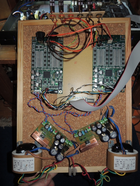

I'd like to very much reinforce Ulli's comment above! Giving the PDC really well designed DACs is a "budget" investment for a better sounding PDC device
I've taken the approach to connect the Soekris DAM1021 with 0.99 Firmware using SPDIF first and recently the AES Output of the DEQX DigOut Board my PDC happens to have installed. Result was a rather pleasing sound experience! More fine detail, (much) less harshness, simply put: "very nice".
The best thing: The mod to connect DAM1021 with SPDIF or AES Out is relatively simple! Here's a picture:

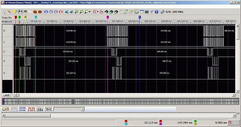

- Muting is an issue to be resolved with DAM1021, as it clicks loudly when DEQX PDC changes the sample rate synch or input.

I've just added 2 Soekris DAM1021 boards for channels 2 and 3, respectivelly.
Here how the PoC currently looks like
Hugh improvement.

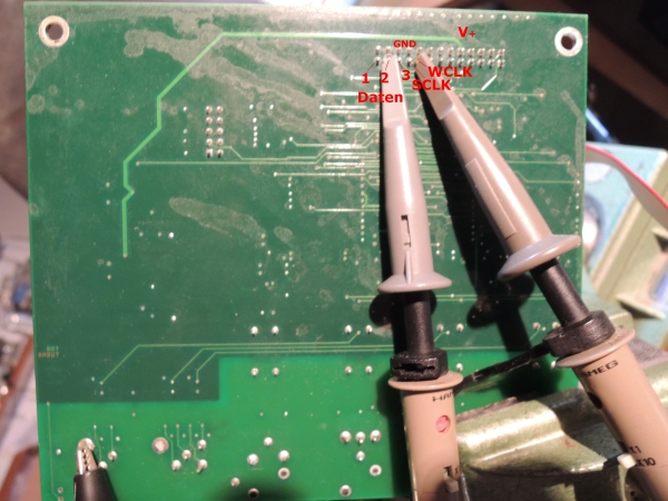

DAM1021 are connected to the PDC-2.6 main board the same way as the digital out board is connected: a ribbon cable carries a supply voltage and all i2s signals needed to feed DAM1021:
Some wires to connect the ribbon cable to the respective DAM1021 input - that's all needed

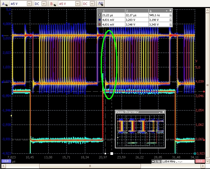

Closer look at the i2s signal reveals both, the reason and a possible solution:
Gain Adjust is set in my case not too many dBs below or above 0dB. In order to have +20dB head room, roughly the four MSB bits are off in this case (left side in the picture above). Gain Adjust set to +6dB gives another bit in the i2s signal (right side).
All fine so far - apart from not being able to use the Mute button anymore.
As DAM1021 muting is yet to be solved, the DEQX Mute will be on the list.
