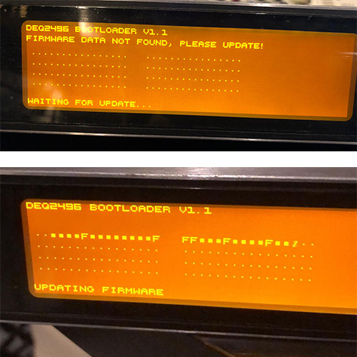

This is not a full eeprom dump. It's update file to upload it via MIDI interface.
This way not work for me 🙁
Sorry just saw you'd already tried this, and I'm still moderated so can't edit my post yet. [EDIT: Not anymore, thanks!]
The "F" on the screen means that EEPROM block failed to be written successfully, so it looks like somehow your EEPROM chip has stopped working properly. This would explain why the application disappeared in the first place.
You'll need to source a replacement EEPROM from an electronics supplier and flash it with the bootloader and application. (You already have the application in the .syx file, but not the bootloader.)
Unless someone else can post a copy of the v1 bootloader they took with an EEPROM reader, you might have to figure out a way of dumping it yourself. In theory you can use the code I wrote to produce a .syx file that will fully flash the new chip (so you can do a hot switch, powering up with the old broken EEPROM, swapping in the new blank one with the power still on, then performing the bootloader flash via MIDI to get it into the new chip, then reflashing the application into the new chip as you have already done), but I haven't tried this with a v1 device so I don't know if the encryption key is correct in order to generate a .syx file that contains the bootloader (if we even had a dump of the v1 bootloader).
EDIT: Actually, before you do that, it would be a good idea to open up the unit and just make sure there's no fluff or dust or anything touching the IC pins on the EEPROM. I have seen before that if some of the address lines aren't working properly you can get failures on some flash blocks but not others. It's possible the chip is defective, although odd so many blocks would fail at once, so there is some possibility it might just be some sort of conductive rubbish touching the wrong pins on the chip. The EEPROM is the large rectangular chip that sits in a socket.
Hello Guys Im new on the forum, hope youre well!
Ive a question , I try to update my DEQ2496 ultracurve pro from 1.1 vers to 1.4 vers with sysex, c6 on mac and midi ox on windows without result, the maschine is blocked on bootloader , I try to send syx file with RME Fireface 800 via midi , Audio 8 and Usb to Midi, but doesnt work , can anyone help me please? maybe send the firmware 1.1 or a correct update? how i can solve the problem? thank you in advance
Hi there, I have the exact same problem on my ultracurve pro also. Stuck on Bootloader v1.1 and I can't update it, can't do anything at all. Did you ever get an answer on how to fix this? I'd appreciate any insight you have! Thanks, Elena
