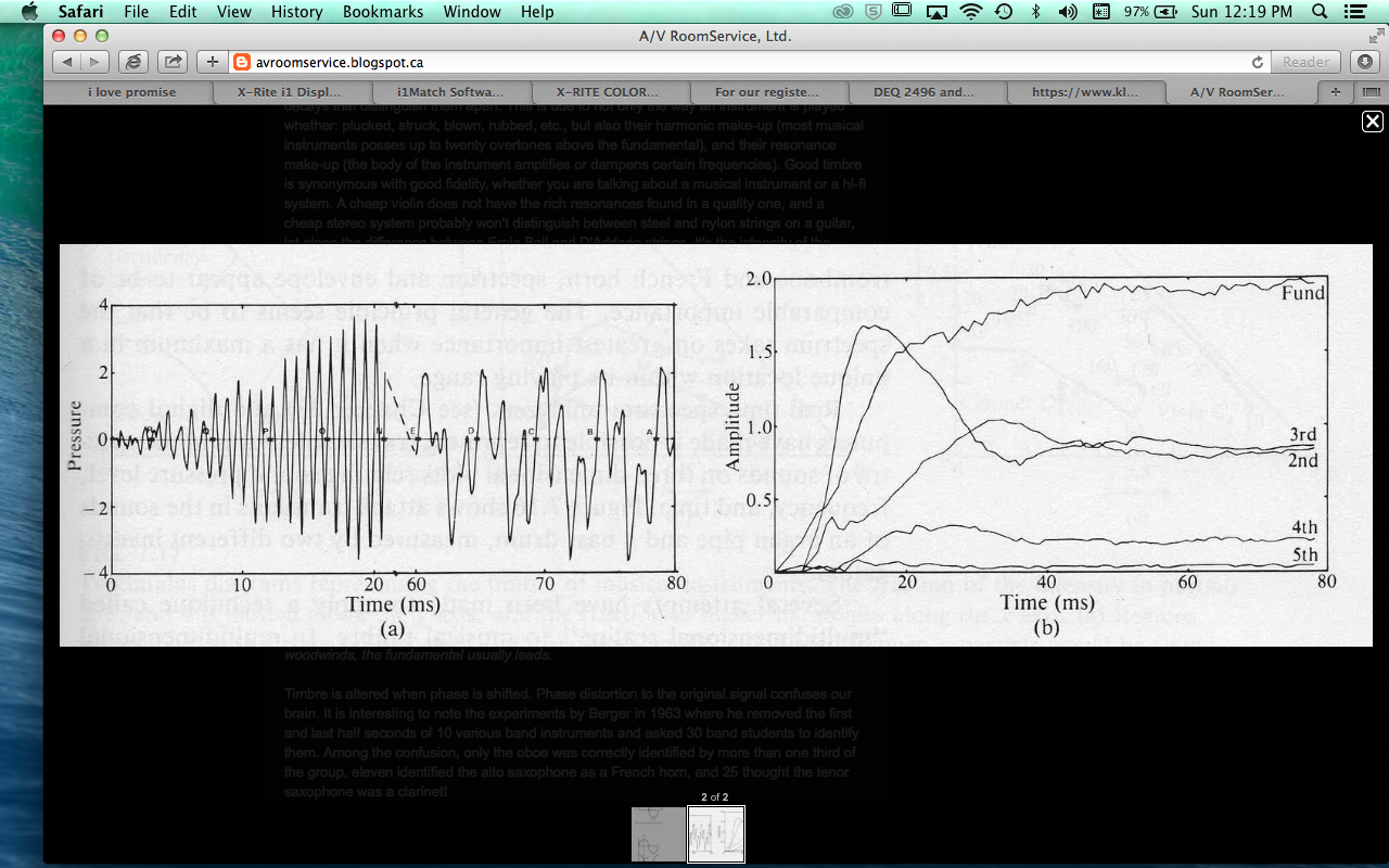

Perhaps the term that needs to be defined is Timbre
I believe it is the Timbre that has been so drastically improved by experimenting with dynamic EQ.
Read this description about timbre
"3. Timbre. Timbre is the subjective tonality or "character" of sound. It has nothing to do with pitch or loudness per se. When hearing a flute and a violin each playing the note Middle A (440 Hz.), it is the differences in their unique attack, envelopment of harmonics (partials) and decays that distinguish them apart. This is due to not only the way an instrument is played whether: plucked, struck, blown, rubbed, etc., but also their harmonic make-up (most musical instruments posses up to twenty overtones above the fundamental), and their resonance make-up (the body of the instrument amplifies or dampens certain frequencies). Good timbre is synonymous with good fidelity, whether you are talking about a musical instrument or a hi-fi system. A cheap violin does not have the rich resonances found in a quality one, and a cheap stereo system probably won't distinguish between steel and nylon strings on a guitar, let alone the difference between Ernie Ball and D'Addario strings. It's the intensity of the overtones, during various points in time, that make these distinctions. Plomp (1970) summarized: a) Phase has maximum effect on timbre when alternate harmonics differ by 90 degrees. b) The effect of phase on timbre appears to be independent of the sound level and the spectrum. Timbre recognition occurs in about the first 20-50 ms of introduction. "
- http://avroomservice.blogspot.ca
I had stated earlier that changing dynamic EQ appears to change tonal balance. I was wondering how this could be.
This would explain why changing dynamic relationships can alter the perceived tonal balance, because the tones are distributed throughout different amplitudes. The tones are different frequencies. So adjusting dynamic EQ literally is adjusting tonal balance based on each harmonics amplitude. It is like Equalizing in a relative sense and in a subtle way. It is also equalizing which takes into consideration the point in time of its application.
By varying the attack setting , you can determine at which point during the transient that the dynamic EQ takes effect. You could theoretically, eq just the transient, or just the steady state portion.
This obviously wouldn't be perfectly scientific (see the video about art VS science before you get upset), but more an artistic subjective approach. You don't have to set a value, you can variably roll the knob and listen in increments.
Personally I have found most benefit, with 0 attack. I will experiment more and post results.

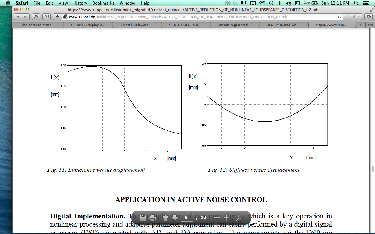

To illustrate why a speaker may act as an expander in a low excursion range, consider the graph of variable stiffness with displacement from the origin (speaker at rest).
Feel free to prove or disprove this.
graph taken from
https://www.klippel.de/fileadmin/_m...ON_OF_NONLINEAR_LOUDSPEAKER_DISTORTION_02.pdf
