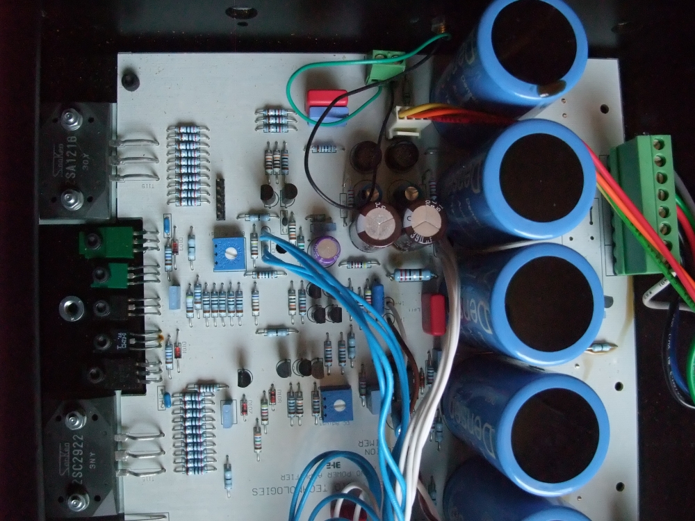

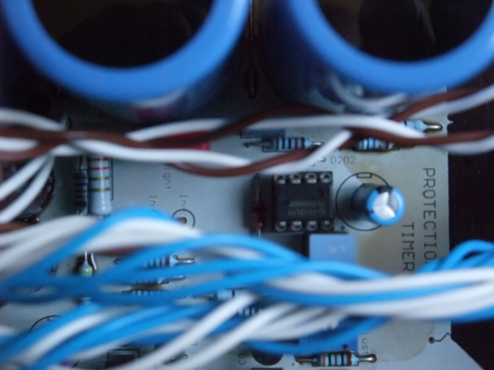

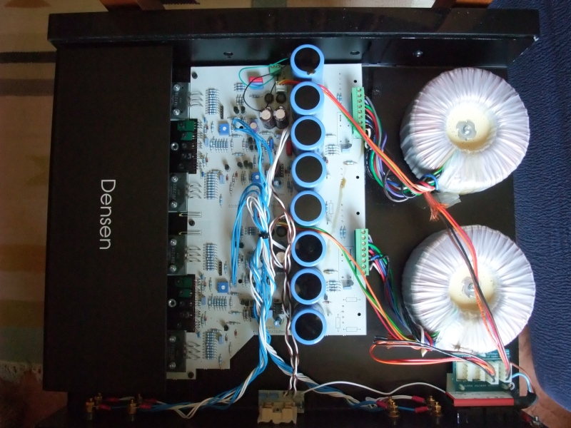

my DM30 inside
Here are shots of the inside.
The amp has been reworked by TS (so states a paper label behind it) so, I guess it might use newer parts than original one (the one in your photos that I remember before Densen previous repair).
Anyway, now at least one Elco leaked. As from the marketing materials each DM30 should have 80000uF splitted in 8 caps, so it's easy to know what is the needed capacitance. But what about the needed voltage?
I would clean everything, look for shorts, exchange caps (I fear all are needed)

Because I don't discover a relay I guess, there is no DC protector section for your loudspekers in use. By certainly kind of failures your voice coil of your speaker will be burn/damaged.
consequently, you may no longer operate the amplifier to a loudspeaker until remove all defective components.
Determine the supply voltage without connected speakers as follow:
Connect one plug of your multimeter to the neg (black) speaker terminal (DC voltage mode, 1000V aera) and the other both at the collector (center leg) from Sanken's 2SC2922 and 2SA1216 (MT-200 outline) The value of voltage must be the same, but with different signs.
If a CFP (Sziklai-Darlington) push-pull buffer is in use, you will read only a very low value (from idle current + CD offset).
Then you must use the emitter leg (right hand).
According this voltage you must choice the capacitors. If you measure 45V or below, use a 63V version. If you measure between 45V and 70V, use a 100V version. Capacity isn't critical - values between 4700 uF and 15000 uF are usual.
But watch out for the least possible value for ESR. Replace all electrolytic caps.
Mundorf is a good choice - go to
http://www.mundorf.com/deutsch 1.1/kondensatoren2.htm
http://www.mundorf.com/nationsite/italienisch/Condensatori-Amplificatore_ital.pdf
In front of both Sanken's 2SC2922 and 2SA1216 I discover 10 resistors in parallel mode. This reduces the parasitic (and unwanted) inductance. I don't identify the colors. If it is brown-black-black-gold, each resistor is a 1-Ohm version (at whole 0R1).
Please measure the voltage across one of this resistor. If you divide the value of voltage by 10, you read the value of the used idle current.
Concerning the disassembly of Sanken's 2SC2922 and 2SA1216 I can't give any advices, because I don't know the special futures that were used by assembly from Densen.
Thank you Jacco and Tiefbassuebertr,
I do hope my trusty Dynaudio Contours will survive the fault (yes, it was a Danish connection regarding output stage of the audio chain :) even if with Mundorfs it would be German juiced :) ).
I still have to measure voltages, but resistor colors seems to me brown-gold-black-black-red and I seem I see two areas on the board marked as "Protection Timer".
