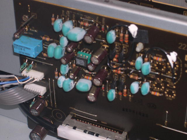

Denon PMA 2000RIV
here's some pics of the first version,phono stage had a ba4558 op amp,i replaced with a ne5532 - %100 improvement.

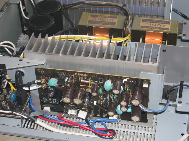

here's the power amp section,nicely built for commercial equipment,(compared to nad,h/k,musical fidelity :eek: ) i have a service manual for the first version,i can scan the schematic but will take some time (it's on a big spreadsheet).
Janka07 said:
WOW that s what I m looking for...
I want to upgrade my Denon Pma 2000 IVR... not the amp section because it s pretty good but pre amp... euuhhh not quite as good
will post pics later on
Preamp 'not quite as good' is a nice way to say it.
/&%&%$&%$ preamp. :D
Sounds really bad, kills the wole amp.
The power amp is quite good, yes.

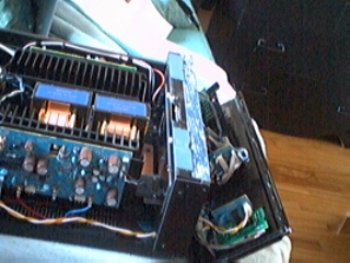

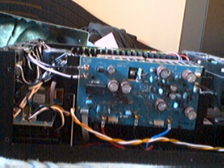

Janka07 said:
and pretty dissapointed to see that volume knob, and selector where mounted on a base of plastic and glued to the front panel... :confused:
Glued?
No.
There's a PCB behind the front panel. Not an easy task to dismantle all that, but I've done it, I bypassed that nasty preamp, volume pot direct to the power amps.
Without a schematic (I don't have it too) you need to follow all that wiring first to understand what are you going to do.
The current version (IV) has a switch on the back panel and a set of dedicated inputs to shunt input signal directly to the amplifier section, bypassing the preamp section entirely, including the volume control.
The posts in this thread regarding the preamp are only fully applicable to the earlier 2000R model... the 2000mkIVR is significantly upgraded in that regard but of course would still benefit from a good preamp.
