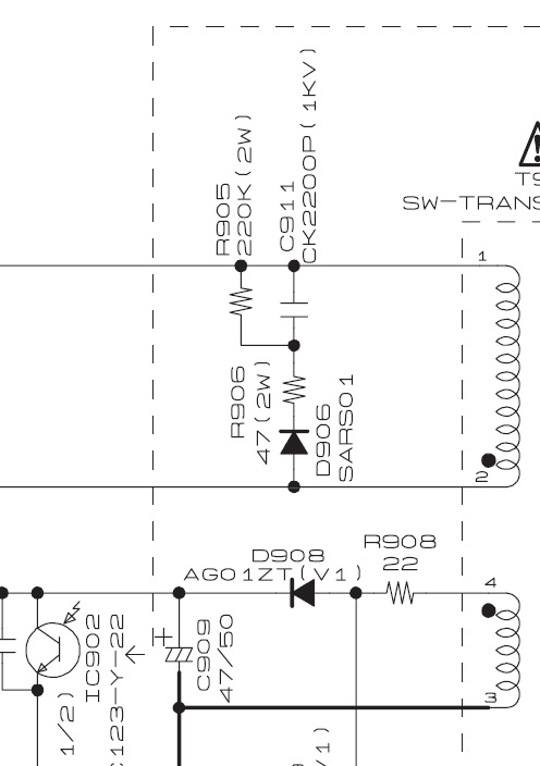

I removed the PSU board (nice and easy) and had a look. There appeared to be evidence of a hotspot around D906.
Detective hat on!

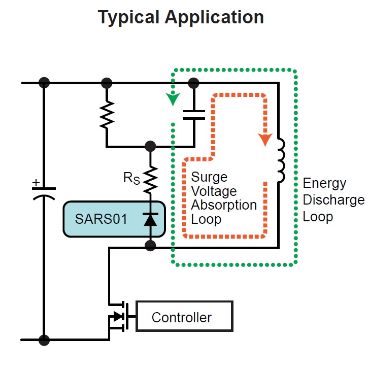

D906 is a SNUBBER diode. Part is SARS01T and the datasheet is here:
http://www.semicon.sanken-ele.co.jp/sk_content/SARS01_ds_en.pdf
The implementation on the datasheet is exactly as per the DVD2900.

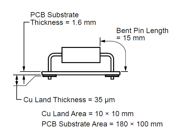

The datasheet clearly shows the snubber diode mounted OFF the board. This was not the case in the DVD2900 PSU that I have - the diode was hard against the PCB. Naughty Denon!
I've remounted the snubber so there is some airspace now. I'll get it into the system and report back. Hopefully, this will be a cure for some DVD2900 problems!

Rats!! The problem is still there. Probably a dodgy drive, then.
Trouble with this unit is that it runs warm - more so that I'd expect for such a bit of kit. That's probably upsetting the laser.
I'm using it as a transport only. Might look at a replacement laser, but before that, I'll give the lens a clean with distilled water. A replacement laser is £15 on eBay, so not too bad.
