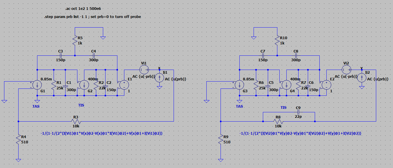

Moving the take off point of TPC (two pole compensation)
is TMC (transitional miller compensation).
rgds, sreten.
I'm struggling with this point. I can see that moving the TPC take off from the VAS output to the driver/pre-driver would include a proportion of the output stage and that moving the take off point all the way to the output would include the whole output stage. Is this not "two pole OIC (Output Inclusive Compensation"? I'm finding relating (the equivalence of) this form of TPC to TMC a challenge.

Hi Bonsai,
I have previously run a simulation of the major loop gain with TPC versus the total loop gain of the minor loop encompassing the output stage with "TMC" using a "real" amplifier circuit.
I think you'll find that there is no significant difference between the ULGFs of the idealised model used in the first post of this thread and those demonstrated here:

TMC have higher loop-gain and higher phase-margin?
Not that there`s any difference at the frequency where it matters thou.
But the TMC will have lover loading on the VAS and that, in my experience, will lower THD by it self.
What are the values of the caps in this example?
What if this would be output inclusive and a small (~2p) miller cap on the VAS? The TMC would be equivalent to miller in that case.

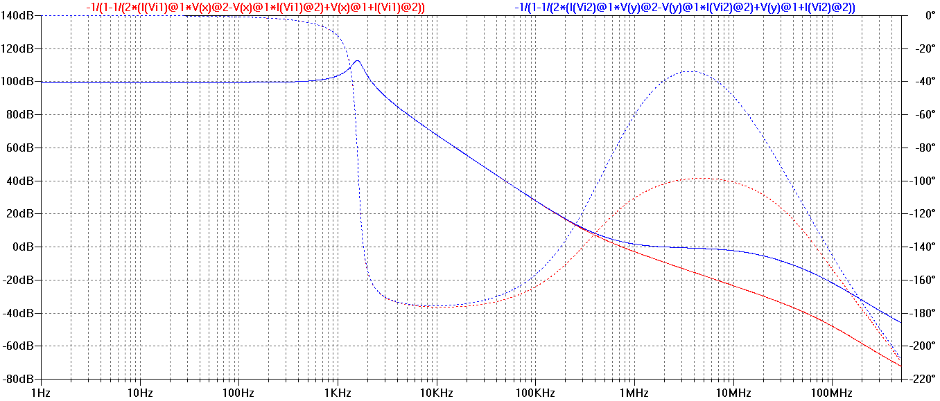

Hi Dave,
Modern output transistors, such as the MJL3281A/1302A, have ft in the region of 30MHz.
This suggests that their dominant poles are likely to reside at least a decade below this, at roughly 3MHz.
It's therefore wise to have your major loop ULGF below 3MHz for acceptable stability margins.
Phase margin, in particular, can be improved by the introduction of a zero in the vicinity of ULGF, with the major loop in TPC, and, interestingly, with the minor loop with "TMC" ; this is done by merely connecting a small capacitor (typically 2.2pF~22pF) across the feedback resistor.
However, care must be exercised with this approach as the zero near ULGF necessarily increases the ULGF, and may, simultaneously, reduce gain margin.
Refer to the attached simulation model of a TPC-compensated amplifier with the major loop gain given without phase lead compensation (red trace) and with phase lead compensation (blue trace).
It's therefore wise to have your major loop ULGF below 3MHz for acceptable stability margins...
Yes, it is almost universal to keep well below the Ft of the outputs.
Certainly a safe way to to it.
But it is not clear to me why ULGF can't be raised considerably with appropriate cancellation of the output transistor pole.
A phase correction capacitor in the feedback loop can be used to do this, or used as you have done, to improve the stability but not alter the ULGF much. Or some trade-off of both.
It seems to be the most effective technique.

...it is not clear to me why ULGF can't be raised considerably with appropriate cancellation of the output transistor pole...
The difficulty is that the location of the dominant output stage pole is unknown; unless you've figured out a method of establishing its location?
It is not OIC TPC. Now you can try OIC SPC (single pole/miller cap)
or indeed OIC TPC, (all compensation around the VAS and output),
but both are hopelessly unstable usually.
So TMC is a hybrid of TPC (on the VAS) and OIC TPC (on VAS and output).
The smaller cap applies feedback around the VAS only, like TPC, but
in TMC the other R and C apply feedback around the VAS and output,
like OIC TPC. Hence the transitional aspect to its naming.
