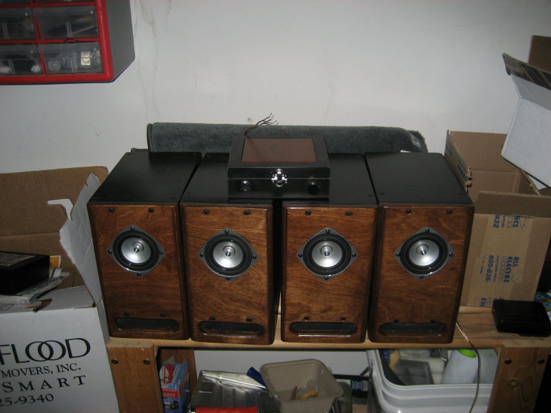

Finished My DelSols
I finished my DelSols. This was my first time speaker build. I learned a lot and I enjoyed the project. I built two pair simultaneously. Just in case I screwed something up, the odds were better I would have one good pair of DelSols upon completion. J To my surprise I completed both pair with out a hitch.
For my Delsols I modified the dimensions by lengthening the height by .75” and narrowed the width by .5" (internal dimensions stayed about the same: from 6.5" x 5" x 8.25" to 7.25" x 4.5" x 8.25). The reason for the dimension change was mainly due to my inability to track down affordable ½” thick hardwood that could be cut to 6.5” width. The irony is that I ended you using Birch ply for the faceplates in the end. I followed the suggested MDF construction for the body of the speakers, but enclosed bottom.
I used Tang Band W3-593s for the drivers. Most of the builds I read using these drivers suggested a notch filter, so I decided to add a notch filter to each drivers (R 6.8ohms, C 3.3uf, I 0.7mH). I tested the DelSols with and with out the notch filter and to my ears notch filter offers a more pleasant sound.
I tested the speaker with an unmodified Sonic Impact T-Amp (original version) and a work-in-progress SureElectronics 2024 Tripath amp. While I am not an audiophile by any means and I am very pleased with these speaker. They match up well with either amp. They reproduce clarity in the music that I formally did not notice. Their range is pretty respectable for their size. I must say they can adequately fill small to a medium size room at moderate volume (not wall shakes but good for the casual listening). I notice that they have a definite sweet spot in terms of listening location, so placement is key. All in all, I am extremely pleased with my DelSols.
I would like to thank Jesse for the great design and the helpful building suggestions.

Re: Finished My DelSols
what kind of finish was used on the faceplate? looks very nice.
gychang
nbrophy said:I finished my DelSols.
gychang
