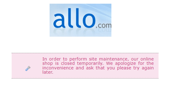

Allo have been a bit quiet of late so check what level of support is available, if you go down this route.
When you try to order any Allo products, this is what I've been seeing for over a week now:
