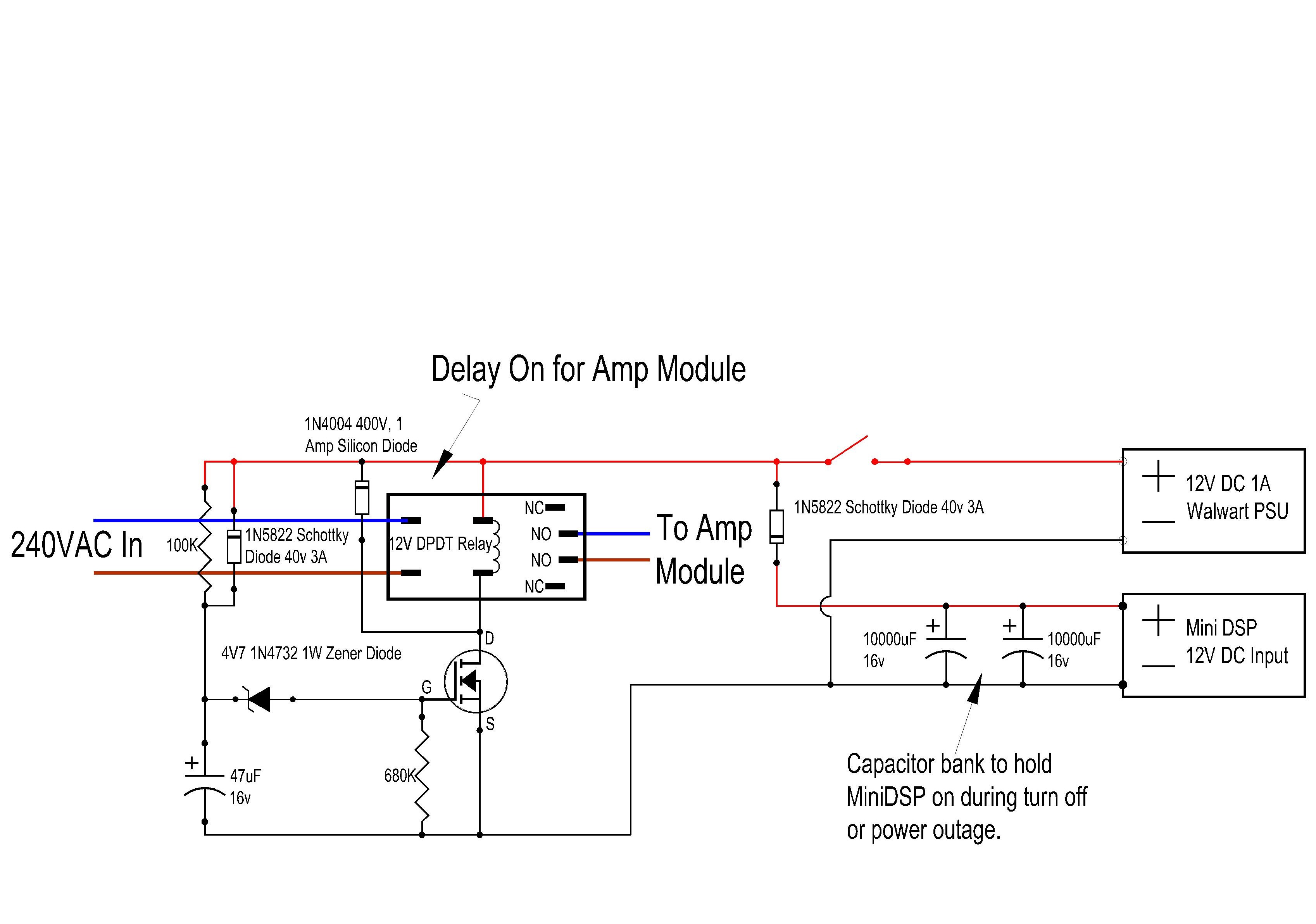

Delay On/Off Setup
Thank you All Again
I went for the higher voltage diode (D2) because that is what I get from the local supplier. I have rotated D3
I'd like to put this together in a few days so I will have to pass on the caps, thanks anyway.
I didn't notice the cap was changed to 47uf, I have made the adjustment.
I'm sure this electronics business is part black magic 🙂

Wattage is:
Either V x V / R
Or I x I x R
You know that the MAXIMUM voltage that can appear across the resistor is 12V
Therefore The MAXIMUM power that could ever be expected of it would be
12 x 12 / 100000 = 0.001 Watts
That's 1/1000 of a watt.
Your 0.6W resistor will be absolutely fine.

I'm attaching the schematic of a power-on delay based on the 555 timer that I believe would be the simplest solution. Given the values of C1 and R2 shown in the schematic, the delay of the output pin 3 of U1 (the timer IC) going from ground to +12V is about 2 seconds. If the connection of +12V to the circuit is disrupted, it takes about 1/10 of a second in theory for C1 to become completely discharged and ready to delay power again.
I built and tested this circuit. No matter how quickly I (manually) disconnected from and reconnected the circuit to the +12V power supply, the output pin was at ground when reconnecting and took about 2 seconds to go high to +12V.
Note that all the resistors are 1/4W and diode D2 is a small signal diode (1N914).
Now given that delayed power on is effected with this circuit no matter how short or long the disruption of the power supply, I would think that this would mean that there is no need to power the miniDSP through the power outage. That is, the miniDSP is always going to receive power before the power amp.

Thanks for the help, I have already ordered the part for the other design but you can be assured I will keep yours up my sleeve for another time.
Interesting circuit there MCPete. It's great to see novel circuits using the ever versatile 555 🙂
It will certainly work and the 555 can easily drive small loads directly (to source or sink current) so an external transistor may not be needed (depending on relay).
Perhaps a .1uf across pins 1 and 8 maybe if using the "original" version of the 555 ?
I haven't seen that used. What purpose would the 0.1uF capacitor serve?
A concern that I have about applying my circuit to DQ828's application that I didn't mention is that most versions of the 555 aren't designed to tolerate a supply voltage greater than 15 VDC. If his 12V PSU is regulated, then there is no problem. However if it is unregulated, then possibly the output voltage of the nominally 12V supply could go above 15V when relatively unloaded.
I know DQ828 says that he doesn't plan to use a 555 IC this time around, but I thought that I would mention my concern now anyway.
-Pete
Of course this is mostly straight out of a textbook. My contribution is the loop for rapidly discharging C1 including diode D2 connected in parallel with resistor R2 and resistor R3 connected from ground to the terminal of C1 connected to V+.
I haven't seen that used. What purpose would the 0.1uF capacitor serve? -Pete
The original Signetics NE555 had a well known issue inherent in its design of "spiking" the supply as the output changed state. I think a value of 400ma for a few microseconds was somewhere near the mark. That could cause false triggering and erratic behaviour. The recommended solution was a cap as close as possible to the supply pins... and I have just looked at some old data sheets and some mention it and some don't. Some suggest a 0.1 in parallel with a 1uf.
We forget how old these devices are at 40 years 🙂 and there have been many subtle changes and revisions. Later versions and the low power and CMOS versions pretty much eliminated the problem.
