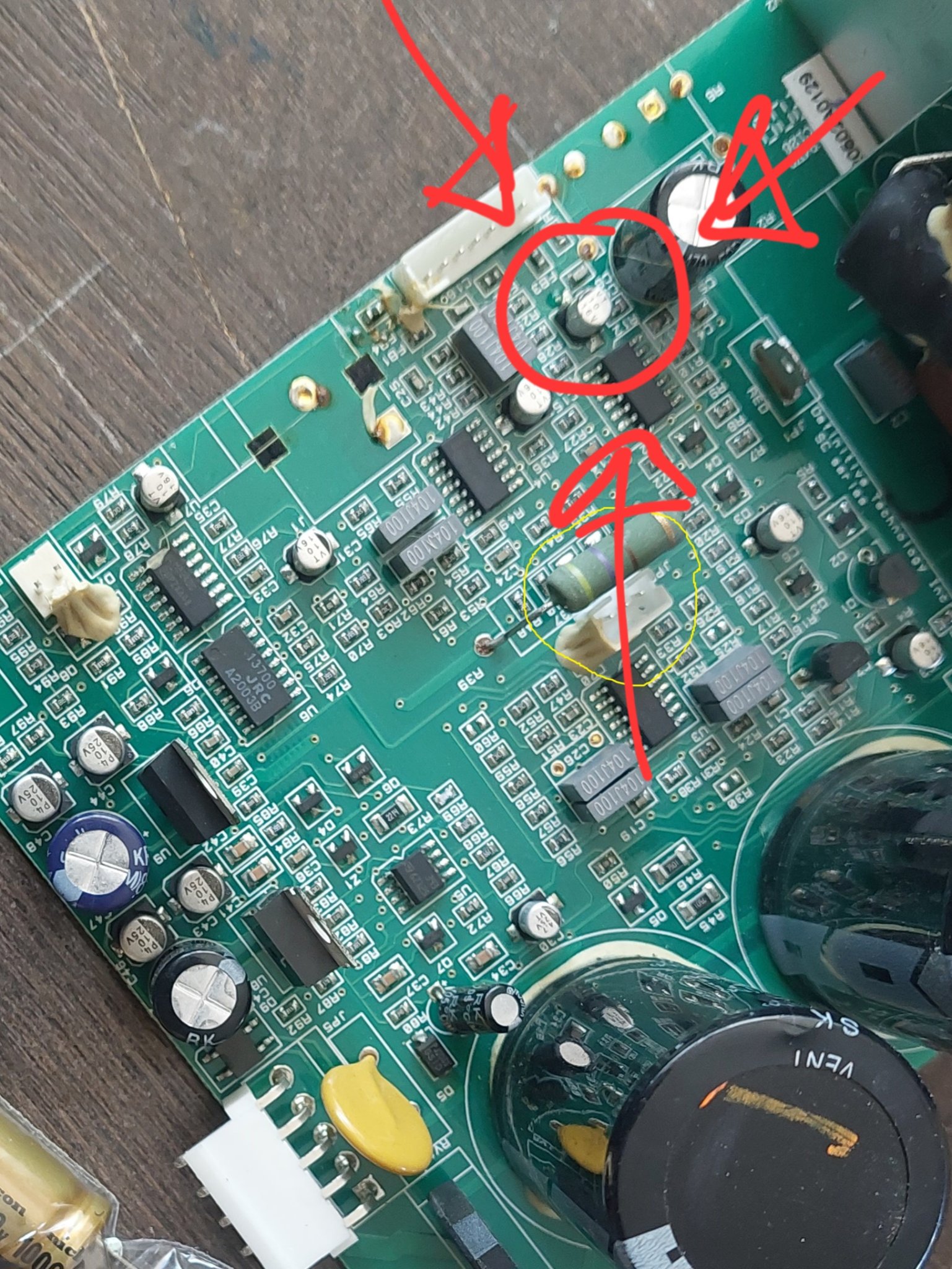

I opened one of the amps and having read many stories with problems about them, I made some upgrades to the known capacitors which tend fail. That had no affect on the auto power on feature, but now when the amp starts, I don't get a loud popping sound . I changed the caps for bigger ones, following an advice from video on YouTube, about a repair of an def tech amp.

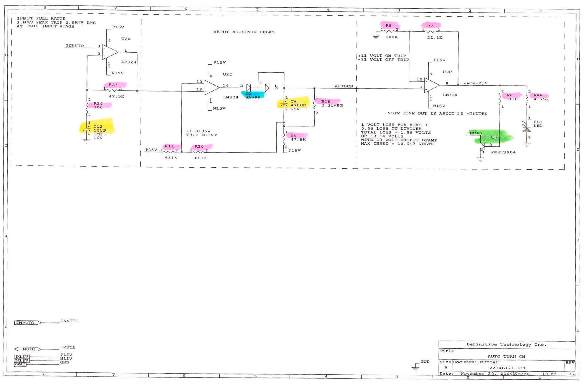

I have encircled with yellow the place on the board where the two wires giving the auto on signal connect, coming from the wire connectors of speaker cables. They are red and white and one of them goes to the big green resistor and I still haven't found where the other one goes.
Here is schematic of the auto on part.
Here, as well as in the manual it states something I fail to grasp : 40-60min delay - is that turn of delay?

What components on the board should I check so that I repair this issue. Or any hints would be appreciated :)
Here is a gallery with more photos of the board :

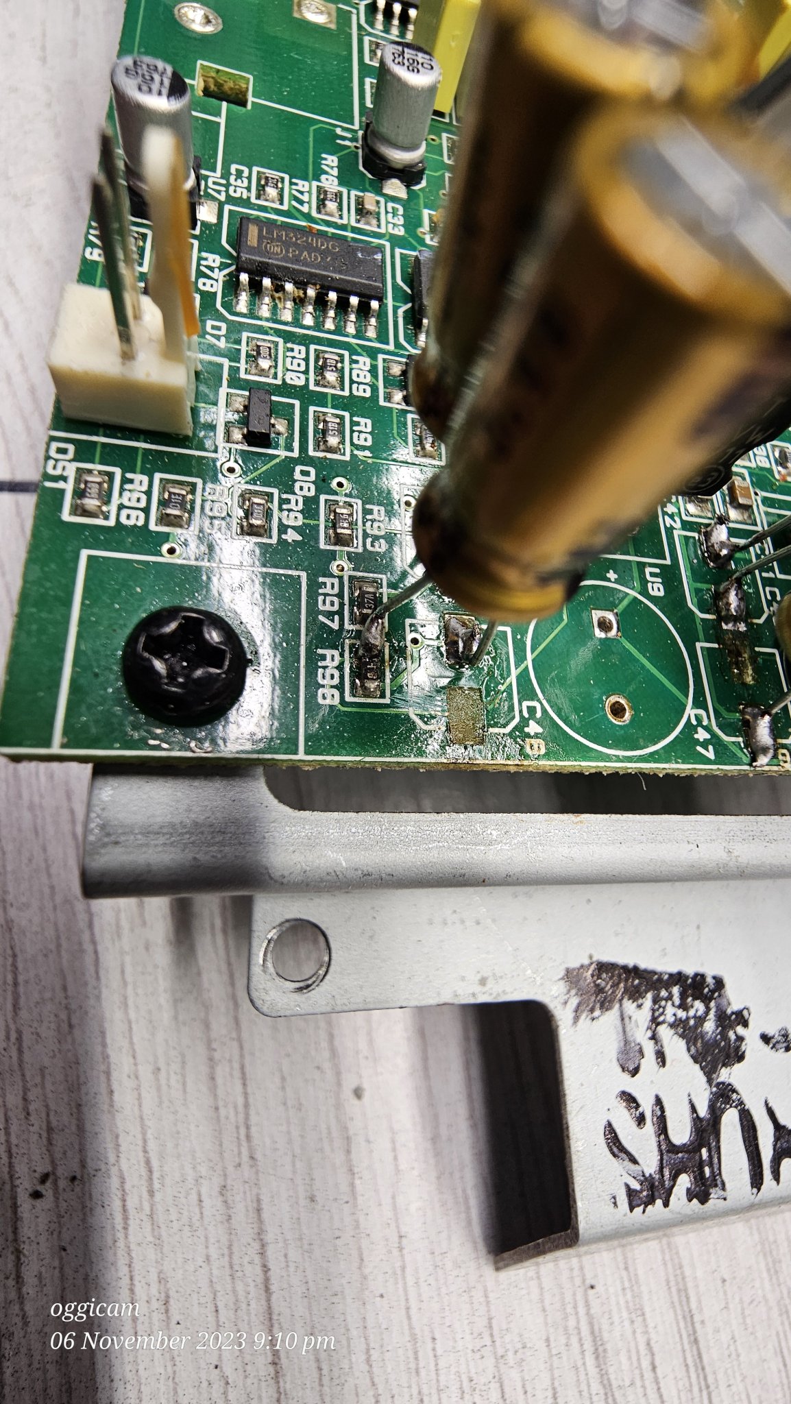

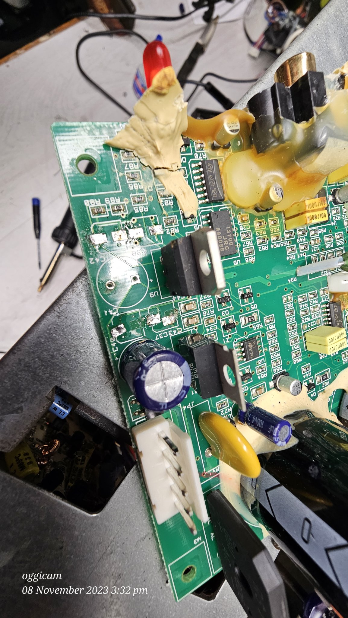

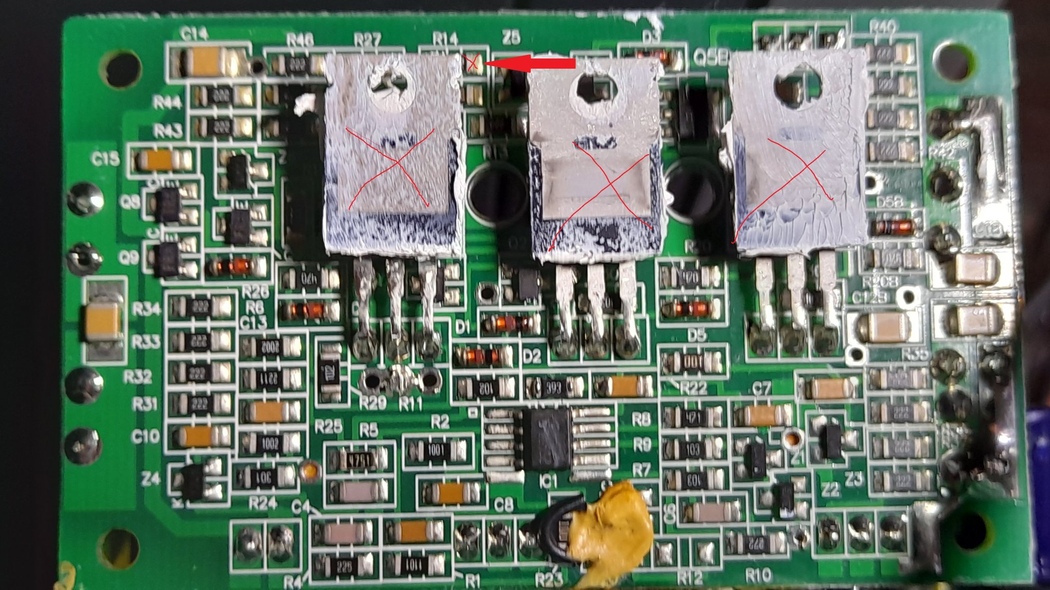

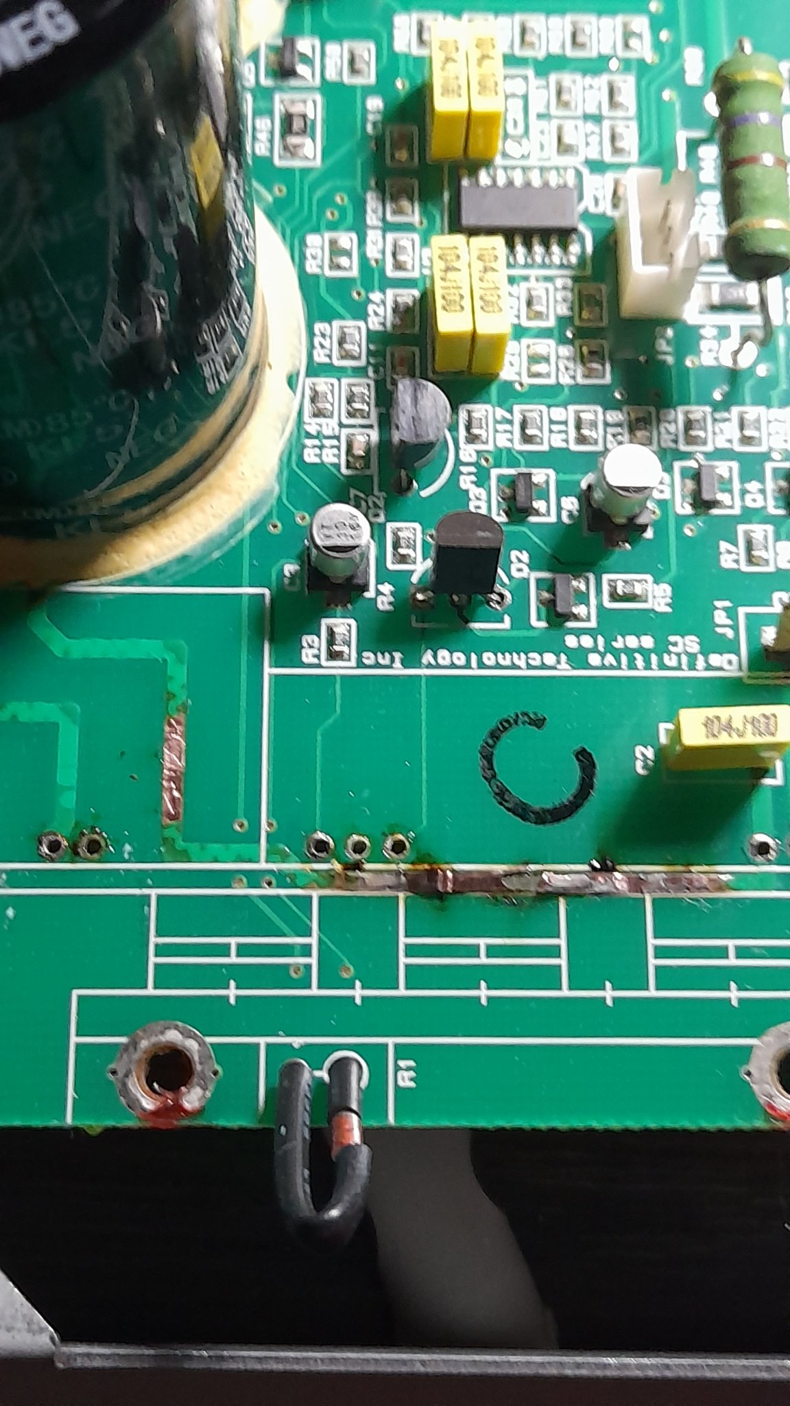

Have tried the same on my BP 7004 amp. That seems to had serious failure, since one line was burnt of on the main board.suspect that smal coil might have shortened the mosfet legs. Since it's placed just over the legs.
Fixed it.
Changed all mentioned caps.
Changed 3 mosfets.. Amp turns on, Red led lights up. But no sound. Can measure sound signal on the input leg, small vertical amp board...
Still have a mythos amp, that I will do the same with. Hopefully it will start working again..

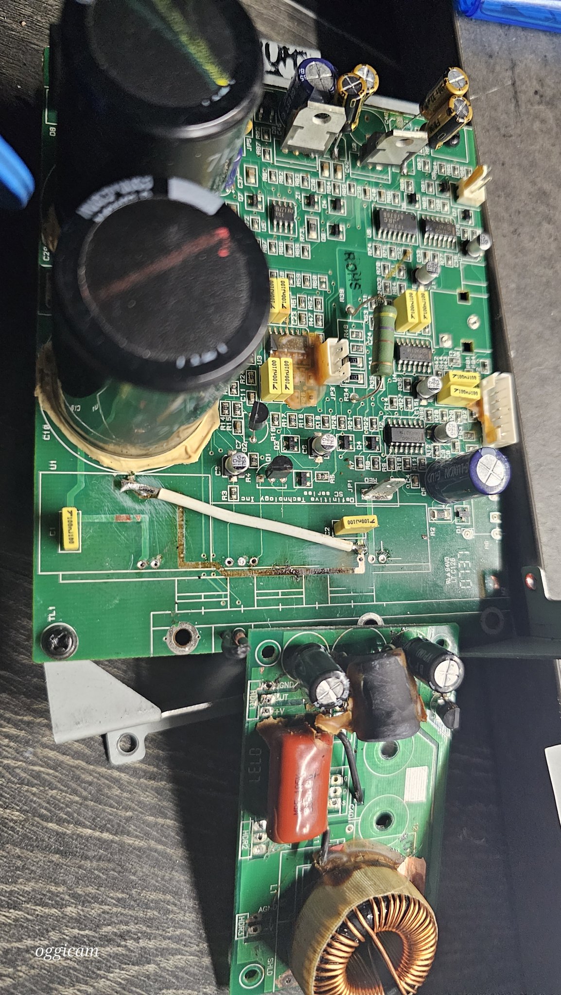

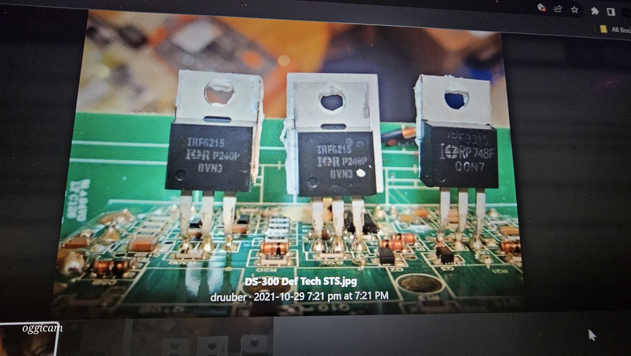

Hi, all the output transistors burned out, after replacing them, the amplifier worked, but there was a strong background and distortion, it turned out that the 3.3kOhm resistor on the small output amplifier board burned out.
I recommend to first check the soldering and serviceability of all passive elements, the printed circuit board, then check all supply voltages, the presence of +- 66V, +-15V, relative to the ground with a multimeter, an oscilloscope is needed for more complex repairs, check for a supply voltage of +-15V on all operational amplifiers of the preamp board

the tracks on the board burned out, they are under the output amplifier board

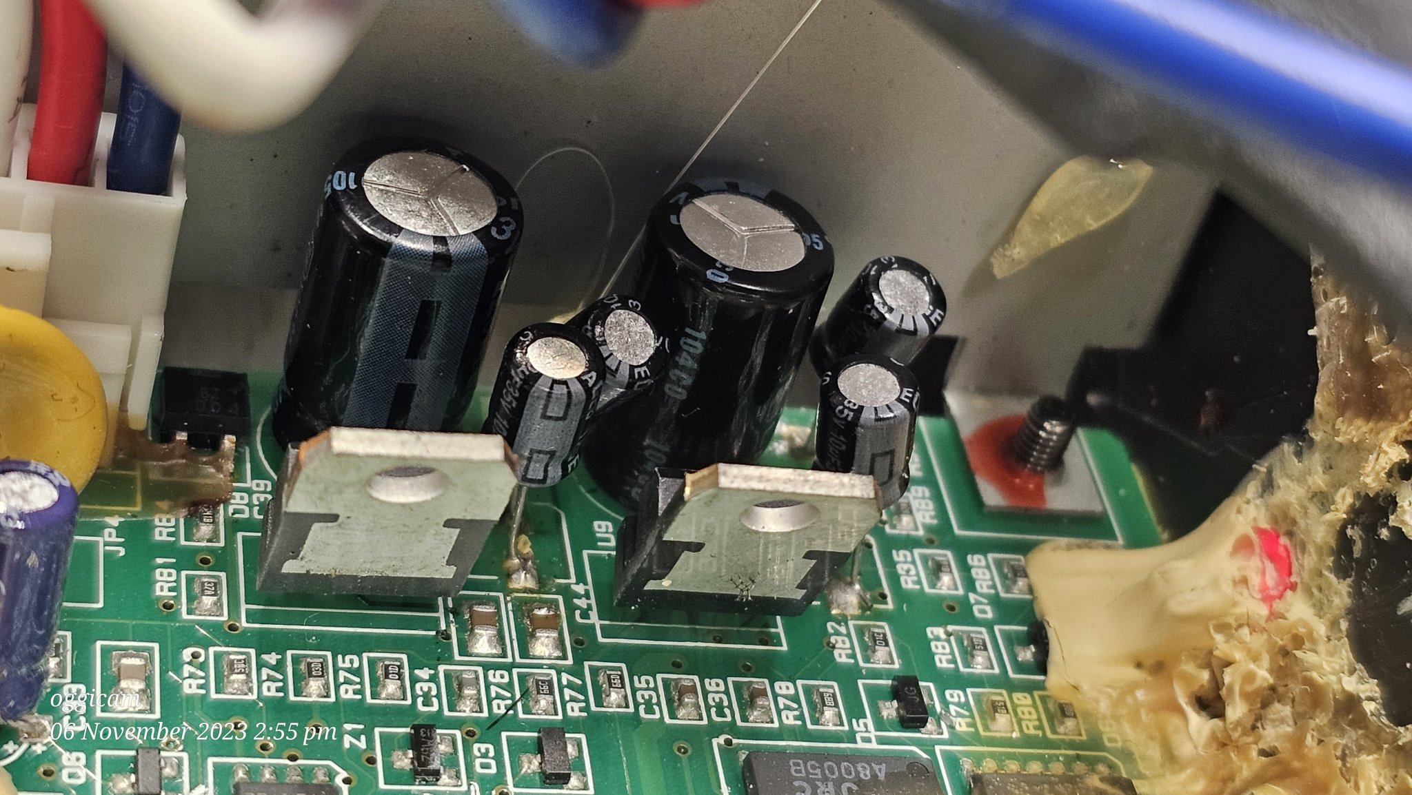

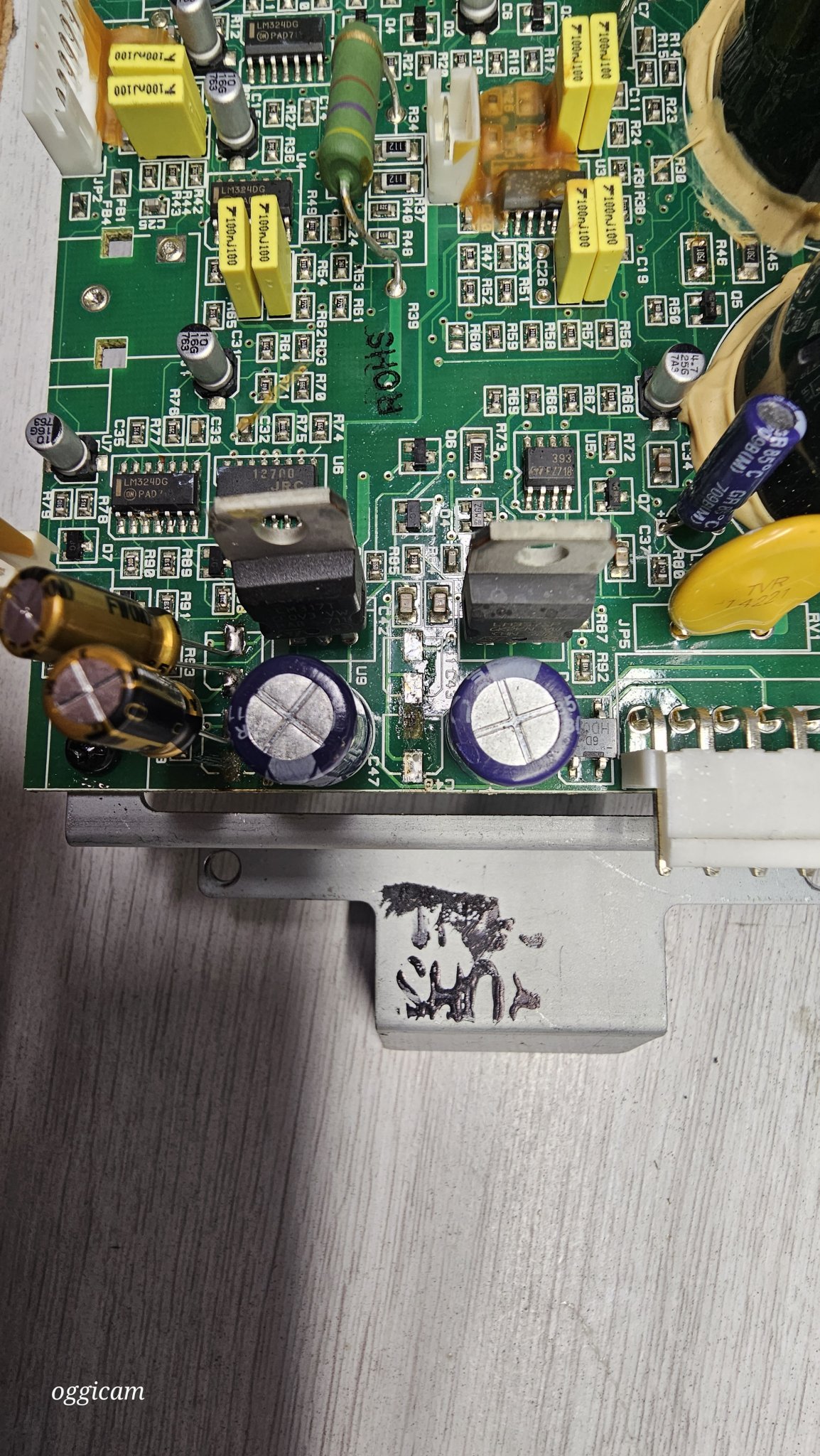

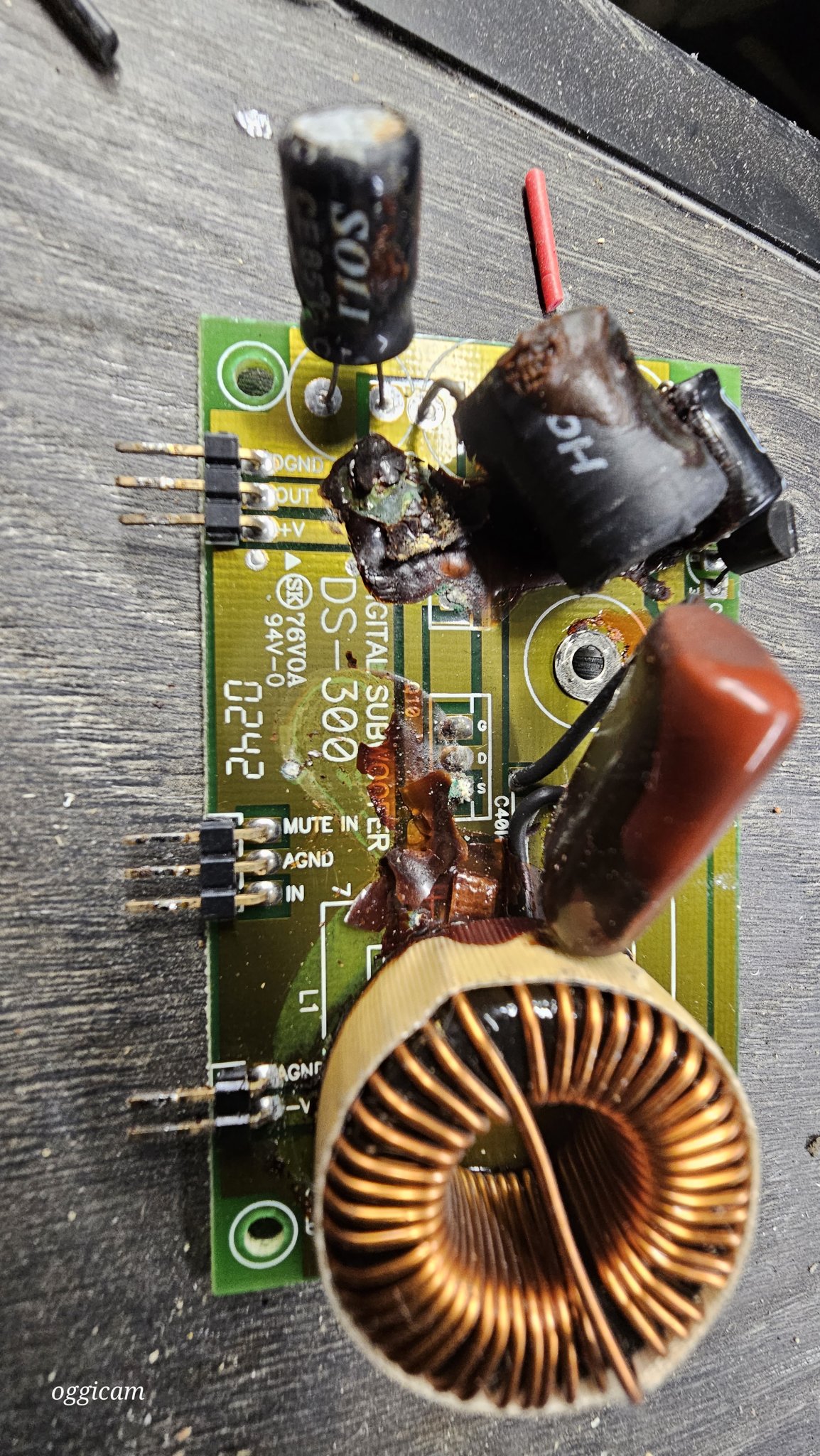

Some pics of my broken amp.
And a amplifier board from a audio vector subwoofer, seems to be the same...
I'll managed to get a working amp from UK, changed all caps. But would be great to actually manage to repair this problem.
Also have similar amp from BP7004. It turns on, but no sound, no trace of burnt parts. Changed those caps, but still silent

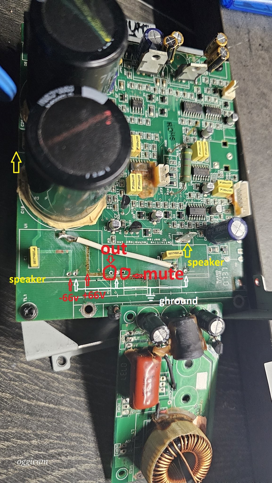

Hello, yes, this is the same amplifier, and my track also burned out, by the way, it’s better not to leave the +66V wire like that, the amplifier is very sensitive and this wire should not intersect with “out” and “mute”. Is there voltage + - 66V at the indicated terminals?

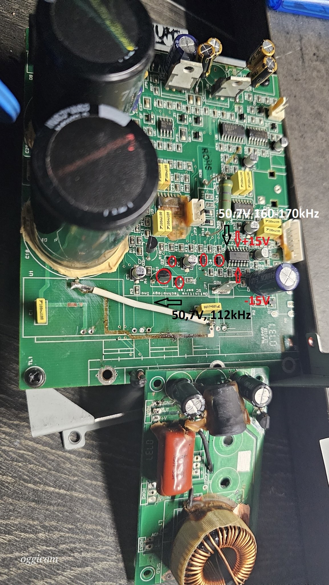

I don’t see any point in changing the capacitors, I think they are reliable, by the way, the LM 324 operational amplifiers are also durable, the amplifier does not seem to work without a small output amplifier board, if it does not turn on, then you need to look at everything that is connected to the “U2” chip, capacitor C6 in conjunction with resistor R18 is responsible for turning off the amplifier in idle mode for 40-60 minutes
As I understand it, the “mute” signal comes from a small output amplifier board, it can be seen with an oscilloscope, in a working amplifier its amplitude is 50.7V 110-112 kHz, Take all measurements relative to the ground, the shape of the signal in my opinion saw

Hello, I would start with the power source, check the presence of all voltages + -15V, + -66V, if everything is ok, look at the diagram at the beginning of the page posted by the respected windv. I would check the capacitor C6, C12, and transistor Q3, then check the soldering under a microscope and ring all the resistors in this circuit, practice has shown that in these amplifiers they are of poor quality, if everything is fine, we proceed to check the operational amplifiers, but here we need oscilloscope, although operational amplifiers are quite reliable and the problem is often in passive elements. Also check diode D2 with a multimeter
What replacement transistor did you use. I am thinking of preventively changing mine.
