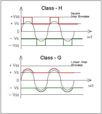

Workhorse said:Hello GOLD_XYZ,
In your diagram you shown the waveforms associated with the working of classes is wrong......
Class-H has Square Step Envelope....
While
Class-G has Linear Step Envelope
This is the correct one....

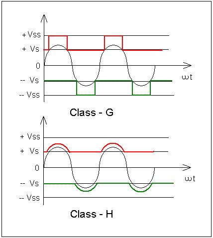

I believe that the US and Japanese definitions of Class G and Class H are swapped.
I can never keep track of it myself. I think Duncan covered it in his book.
I worked on the Crest 8001, which had three sets of rails. The upper rails moved in an analog fashion (they were not hard-switched). Crest referred to their amplifier as Class H.

Hi KanwarWorkhorse said:Hello GOLD_XYZ,
While
K a n w a r

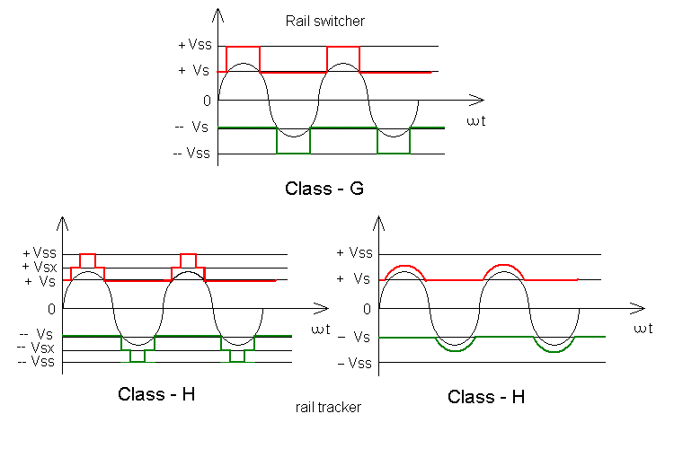

I know well what you say.
In this site it says (class H) "electronic switching between multiple rail voltage levels"
http://ieeexplore.ieee.org/xpl/freeabs_all.jsp?tp=&arnumber=117926&isnumber=3398
the problem is that in many sites he is otherwise written..
http://www.rane.com/par-a.html
it says
"class G = rail switcher, class H = rail-tracker"

It would seem that there is need of a standard...Originally posted by Bob Cordell

The STANDARD is well maintained as
Class-H = Square Step Envelope
Class-G = Linear Step Envelope
Class-TD= Rail Modulating Envelope...[Tracking Rail]
And stick to it as its Right.....
The other references are just an example of confused or misunderstood concepts...

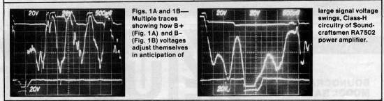

I think that the first definition of the class H is with a multilevel switched supply... to see Pat. 3.319.175
In Soundcraftsmen MA5002 (Class-H) I see only a rail-tracking by Q19 - Q20 - Q21
http://www.soundcraftsmen.info/Class H/Amp AL.png

If you look at the waveforms of Soundcraftsmen Class-h amp...they exhibit square step type envelope, not a linear envelope , therefore its Class-H

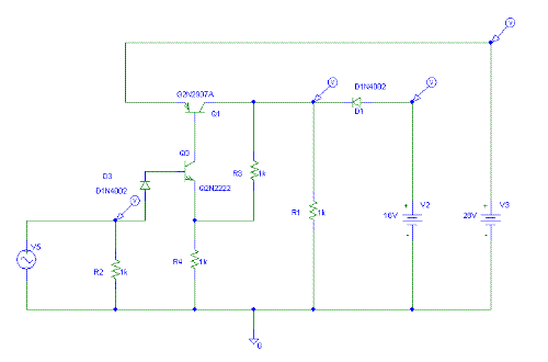

A little simulation with pspice of supply "lifter" of Soundcraftsmen MA5002 (Class-H)
this is undoubtedly a rail tracker...
and Pspice schematics..
From : http://www.diyaudio.com/forums/showthread.php?s=&threadid=68415Workhorse said:...I mean to say in simple words "The Rail Switcher Amp" benefits from the elimination of wasted heat incase of class-AB , by splitting the power rails into 2 or 3 TIERS, and choosing the appropriate Rail according to the Voltage Swing at output.....So that the output transistor has less VCE across it to do the job with less wastage...
Hi, Workhorse,
Your definition is right !
With two or more rail switcher (that approx. the envelope) or with a
rail tracker is a class H amplifier. (to see Pat. 3.319.175)
With a single rail switcher is a class G.
bye
