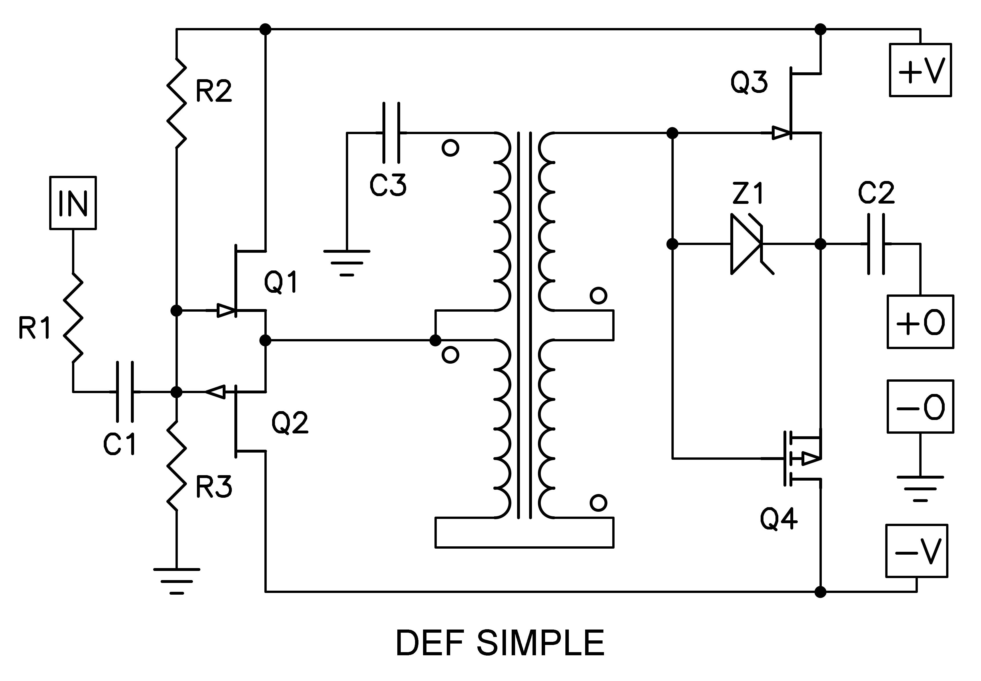

Any hints on the technical specs of this particular amp?
It is similar to the DefiSIT, but is direct coupled and uses the SemiSouth
depletion mode R085 Jfet coupled with the Harris IRFP9240, and Jensen
transformer driven by Toshiba Jfet input buffer.
I am preparing a set of curves to accompany this offering, and will post
them shortly.
The one and only
Joined 2001

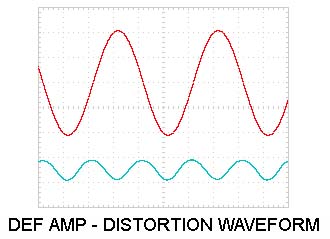

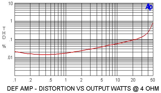

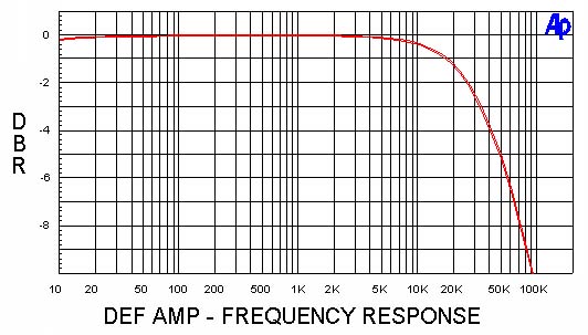

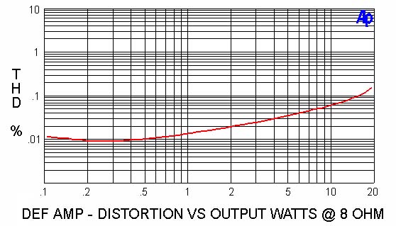

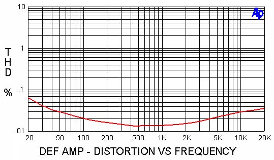

Here are those curves, taken from a BAF talk a couple years ago.
They were taken from this amp or its brothers.

Vgs, Mr. Pass?
Nice thing about the DEF is that it is only the difference in Vgs that is
critical. That Vgs would be taken at expected operating current and
voltage for perfection. That Vgs difference will alter the bias current
as divided by the sum of the inverse transconductance of the devices.
For example, if the depletion mode device Vgs is 1A at -4V, and has a
transconductance of 2 and the enhancement mode device is +3.9V with
transconductance of 3. The the increase is bias would be seen as
increase I = .1V/(1/2 + 1/3) = .12 amps
If the depletion mode Vgs is greater than the enhancement mode Vgs,
then your bias is high, which is better than otherwise, as you can insert
a little resistance so as to bring it down.
I got some of my pairs down to .1V or so, and the extra bias doesn't
bother me.
