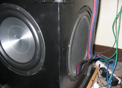

khanh12 - which one are you interested in? Those were just some ideas that WinISD told me would work. That's usually what audio DIYers do before they build their subs - building and testing prototypes is prohibitively expensive, and the simulations of modern programs are very accurate. If you need me to make you some plans for any of those, I can do it. If you want to see the WinISD response curves, I can post those as well. The drivers used in both subs should handle a 100 Hz crossover with aplomb, but I don't recommend crossing that high as a general rule unless you are planning to build two and use them in stereo.
Or are you interested in MY sub?
This is the last sub I ever built without the aid of a router and a circle cutting jig. The one I built for my friend with my old 10" driver looks a lot better, but its performance is not as awesome. This photo shows both the driver and one of the two 15" PRs, to prove that I have both and that they are in a box and working, and I'm not just blowing smoke when I say I've done this before. Typically the driver and both PRs are covered with fabric grilles, which produces an interesting effect when you can barely see the shine of the aluminum cone through the grille fabric.
The room was very messy that semester. That black, blue, and white strap you see is from one of a set of drum cases that one of my roommates stored his drum kit in.

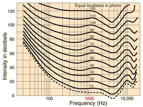

90dB or 90phons :
/sreten.
but bizarrely very different, if only these were true:
90dB or 90phons :
/sreten.
