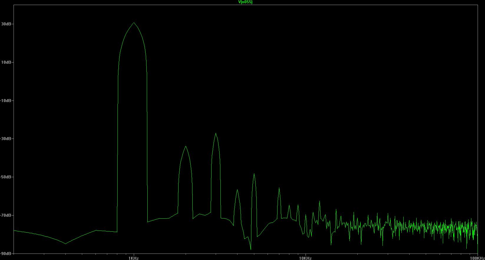

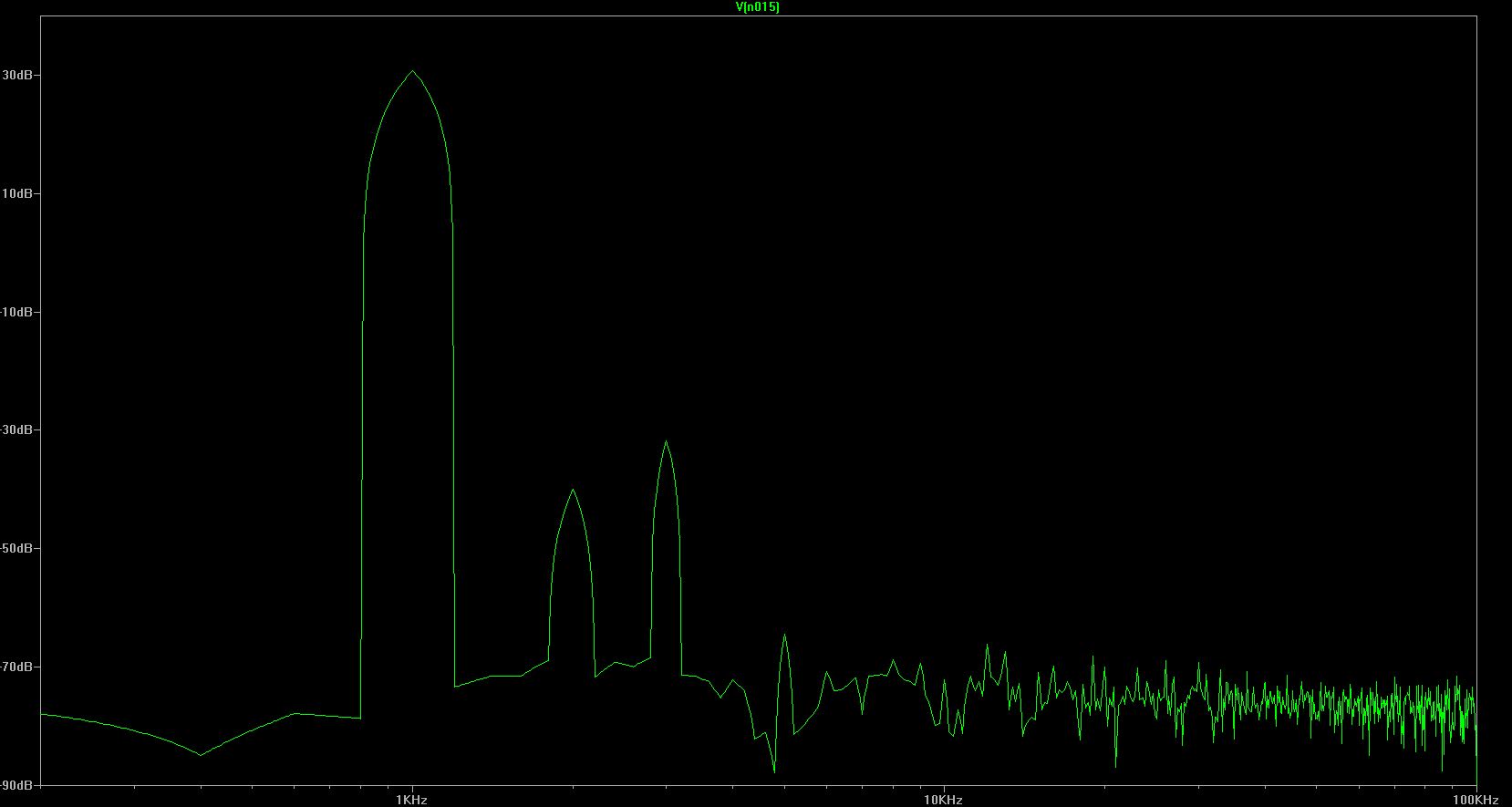

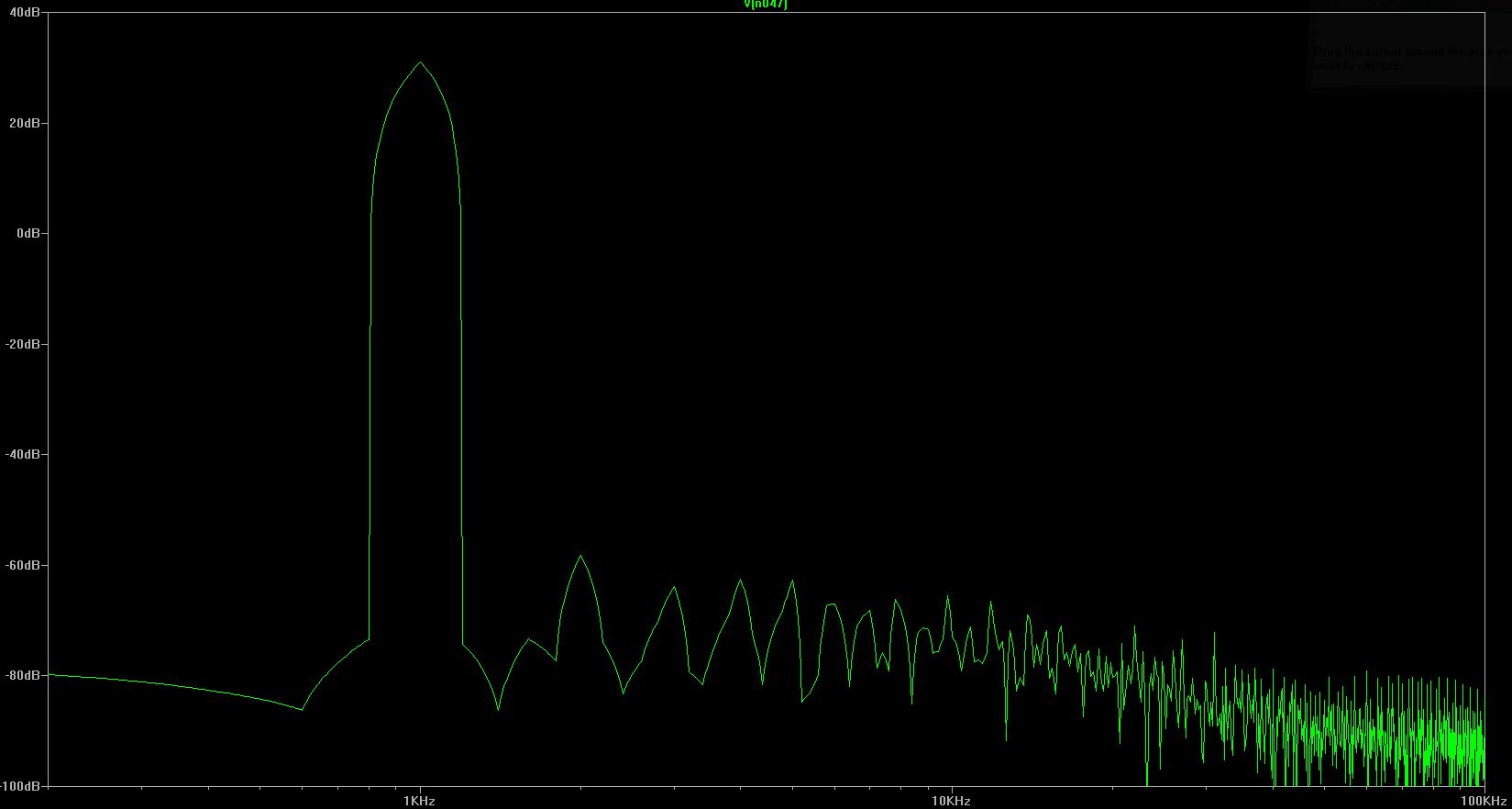

I simmed both Mk2 and Mk3. Unsurprisingly, most of the distortion is generated in the output stage. It seems excessive, so maybe something is not quite right with my sims. The "stasis" pair is certainly the most critical part of the design. I couldn't find models for the 2SA1073/2SC2523 originally used and replaced them with 2SC2922/2SA1216 which should be at least as good. The servo is omitted for simplicity but would normally connect to the grounded side of R36 on Mk3 and R41 on Mk2.

And here are the distortion spectra where VAS indicates distortion prior to the output triple in the Mk2 and at the bases of the "stasis" transistors in the transimpedance version.

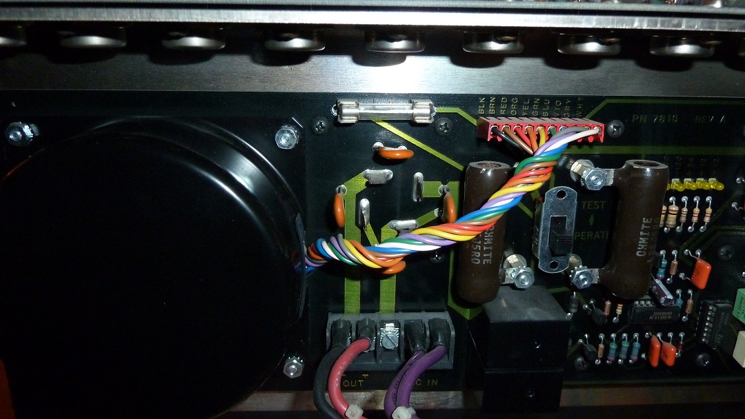

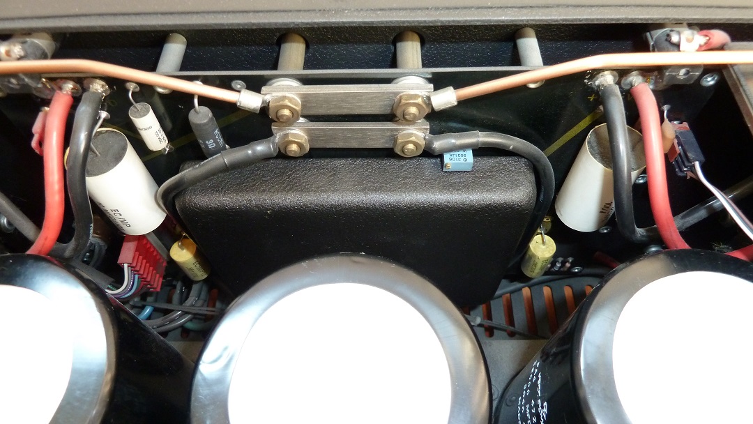

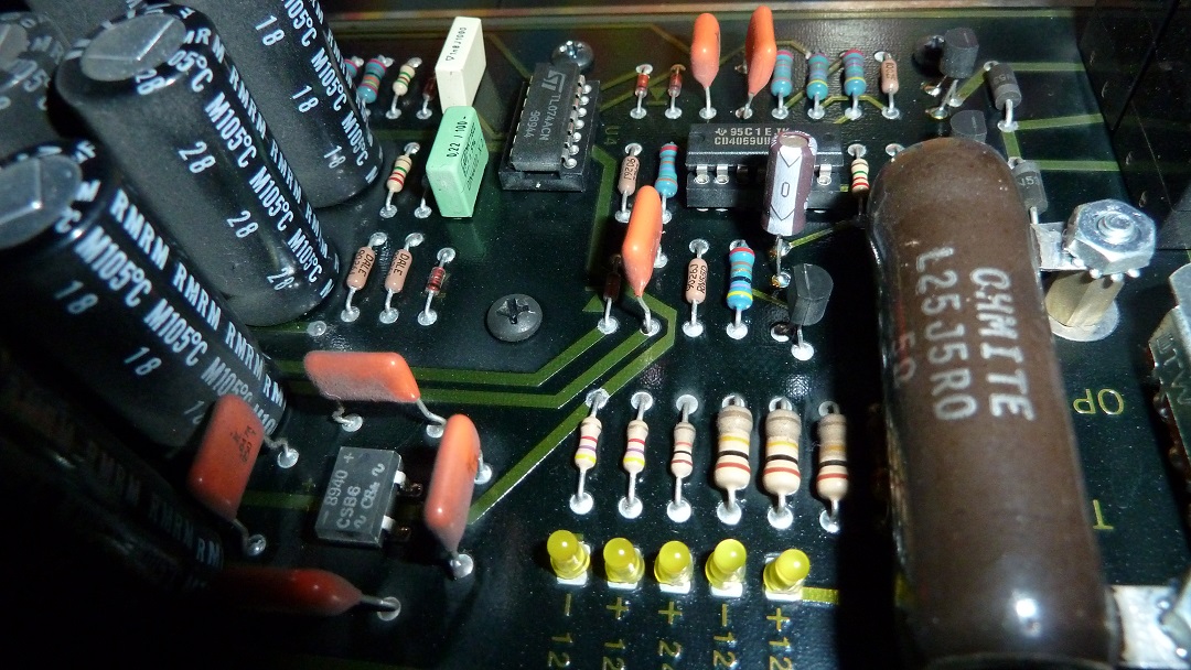

Hi Analog_Sa.
To clearup the matter I used the name 'BrianEno' at first and for obvious reasons I changed it to RobertS61.
The 400uF per rail you talk about is situated on the powersupply assembly constituting of eight times 100uF/200V electrolytics (C15-C22, RMRM 105 Celcius). As far as I can see the epoxy audio-board is fed by it's own regulated powersupply with its own potted toroidal transformer, bridge rectifier CSB6 with snubbers and the 400uF smoothing caps per channel to get a +/- 120 Volts regulated line for the mainboard.
Then trough a Jumper J8 it's indeed fed through wires to J2 jumper on the mainboard that holds the epoxy filled audioboard.
In contrary I believe I'm not a technician, there are some filmcaps on the mainboard. The +/- 90 Volts has its own 10uF/100V and 22uF/150 filmcaps (white) and the +/- 120 Volts has a .56uF/200V filmcaps (yellow ones) added. Wouldn't you consider that as a form of decoupling? The pre-driversection with the opamps is fed by the regulated +/- 120 Volt and the driversection with the +/- 90 Volts.
