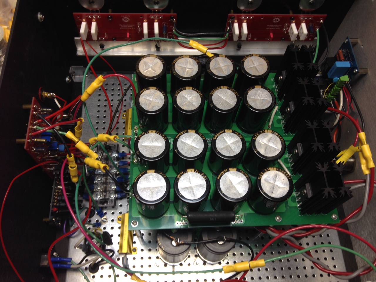

recepky:

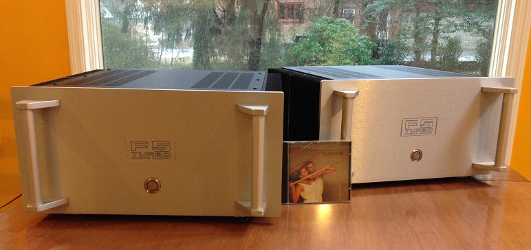

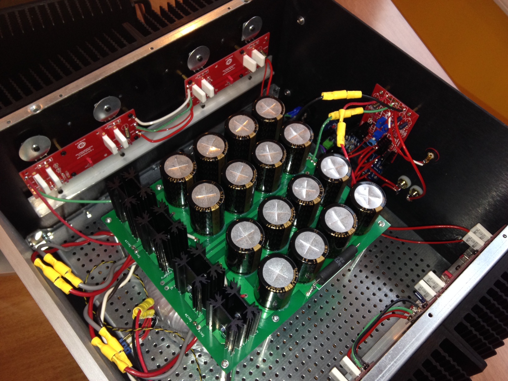

I built F5 Turbo V3 monblocks a few years ago and am very happy with the results, but I also have the good fortune of living near another diyAudio member who has built and/or has access to other Firstwatt amplifiers. In your second post, you noted that space considerations necessitated your building two small monoblocks instead of a centrally-located stereo amp. I suspect you could build 50 watt F5 Turbo V3 monoblocks in a pair of the store's Deluxe 4U chassis, but I would also urge you to consider building a lower-powered monoblock version of the F6 instead. The difference between 25 watts and 50 watts is far less than you might imagine and the F6 strikes me as a design that is more consistent with Nelson Pass' "house sound" than the F5 Turbo. Either way you will be happy, but you might be able to find a chassis smaller than the Deluxe 4U to house one channel of an F6.
Just a thought...
Scott
Just a thought...
Scott

recepky:
Thanks! My F5T's are currently biased for about 110 watts per channel into 8 ohms. I'm pretty confident that I could bump them up to around 200 watts per channel, but I don't need the power or the heat (or the energy consumption).
Good luck with your project. Please post photos!
Scott
Scott

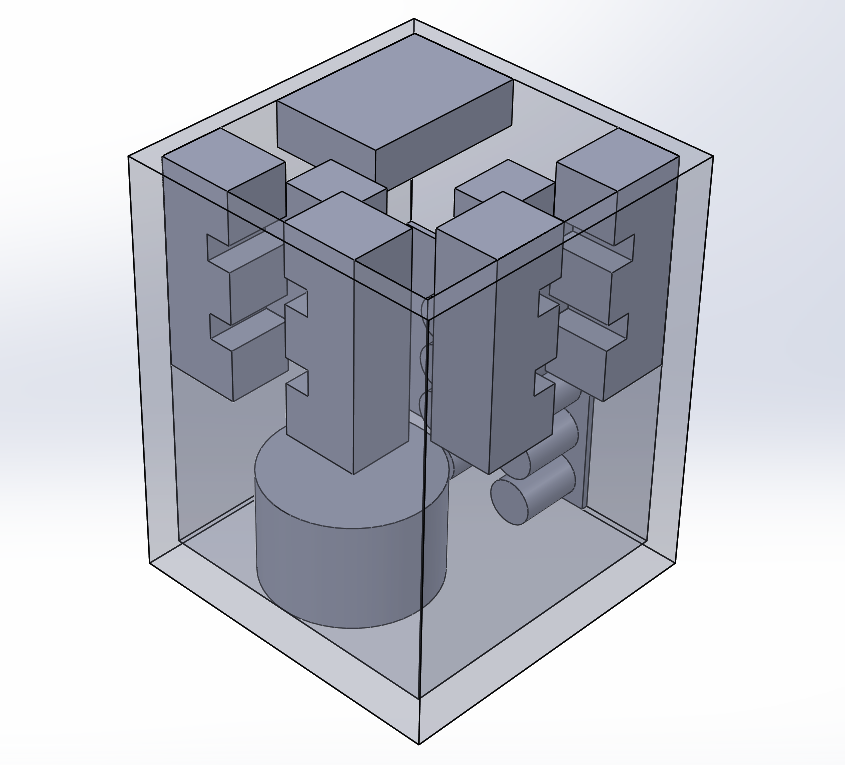

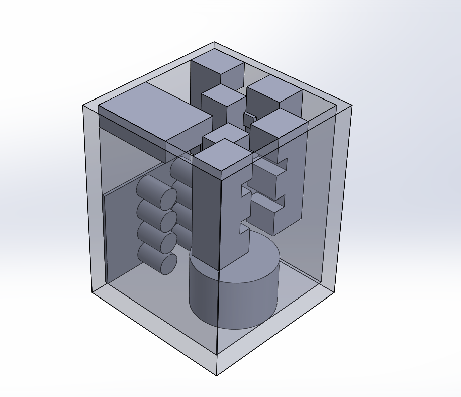

thanks for the reply SRMcGee
I want to show you my chassis design.
Here you can see the plan
you can recognize the toroid and psu pcb and caps. the box in the upper corner is front end pcb
From this perspective you can see the N channel and P channel boards, the big foots are the cooling heatsinks that have more than enough surface area (8xCPU heatsink)
One side of the box is left for the electricity input, rca input, speaker output and 140 mm exhaust fan.
This is the chasis that I want to use for each mono block.
What do you think? Am I missing something?

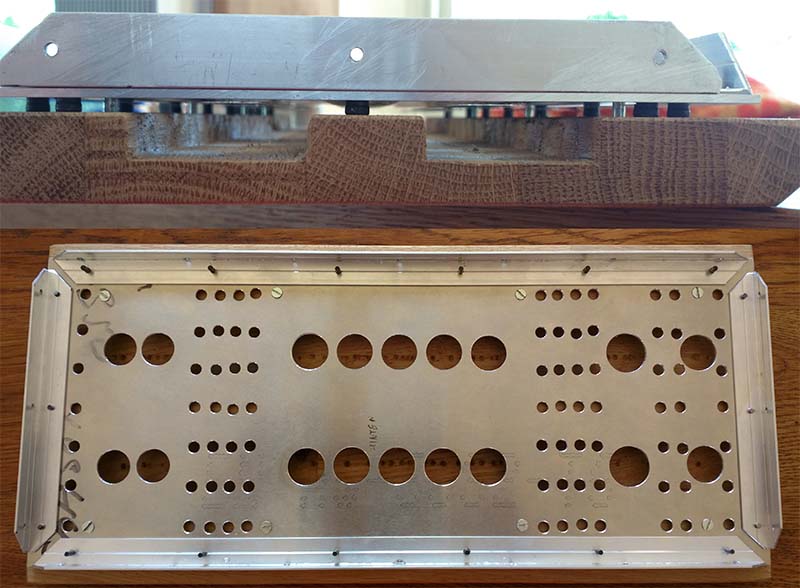

i build a vertical arranged f5t, take a look here http://www.diyaudio.com/forums/pass...-your-diy-pass-amplifier-280.html#post4050787 , i can get up to 2 x 44 watt max. i don't think that will work with this case, even with a fan you will look for a vertikal uninterrupted airflow.
my case has a lot o ventig holes and airflow channels to suck the hot air out. the concept i had needed some afterwork to run fine. i learned a lot with this amp, vertikal heatsink this high are 2/3 as efficent as horzizontal arranged. the two most important things are heat sink size and free flow of the air, i think you will run into troube with trapped heatspots in this case even with a monster fan.
the cold air intake comes from bottom of the chassis and leaves hot air from the back of the chassis in the design. actually I rely on 8 x AMD cpu heatsinks, because you now cpu's get as hihg as 70degrees in normal operation and with heatsink it stays with that heat. I am planing to use one or more fans over heatsinks if I get in trouble, anyway like your example if I get in more trouble that means I will drill holes on the chasis side panels in the CNC
by the way I saw your pictures, what a cute design!, but it seems your chasis is smaller compared to xigmatek chasiss that I will use.
chasiss has about the same footprint ca 27x30x45,
actually it looks like smaller than yours but you designed the chasis for stereo right?
mine will be mono, two box system
yes for stereo. but the pcbs are with 2*6 mosfet smaler then the standard f5t with 2*8 mosfets. i planed to get easy 2 x 50 watt but it runs to hot, i maxed out the chassis to get 2 x 44 watt, and this amp weight over 30kg/66 lbs most weight alluminium for cooling/heat transfer.
if i build this amp for a friend i would lower the bias a bit (38-40watt), the heatsink can get up to 60c on a hot summer day, safe if you keep a eye on it but a better target is 55c. what's not so nice with a hot case is that the caps aging a lot faster, the rest is fine.
