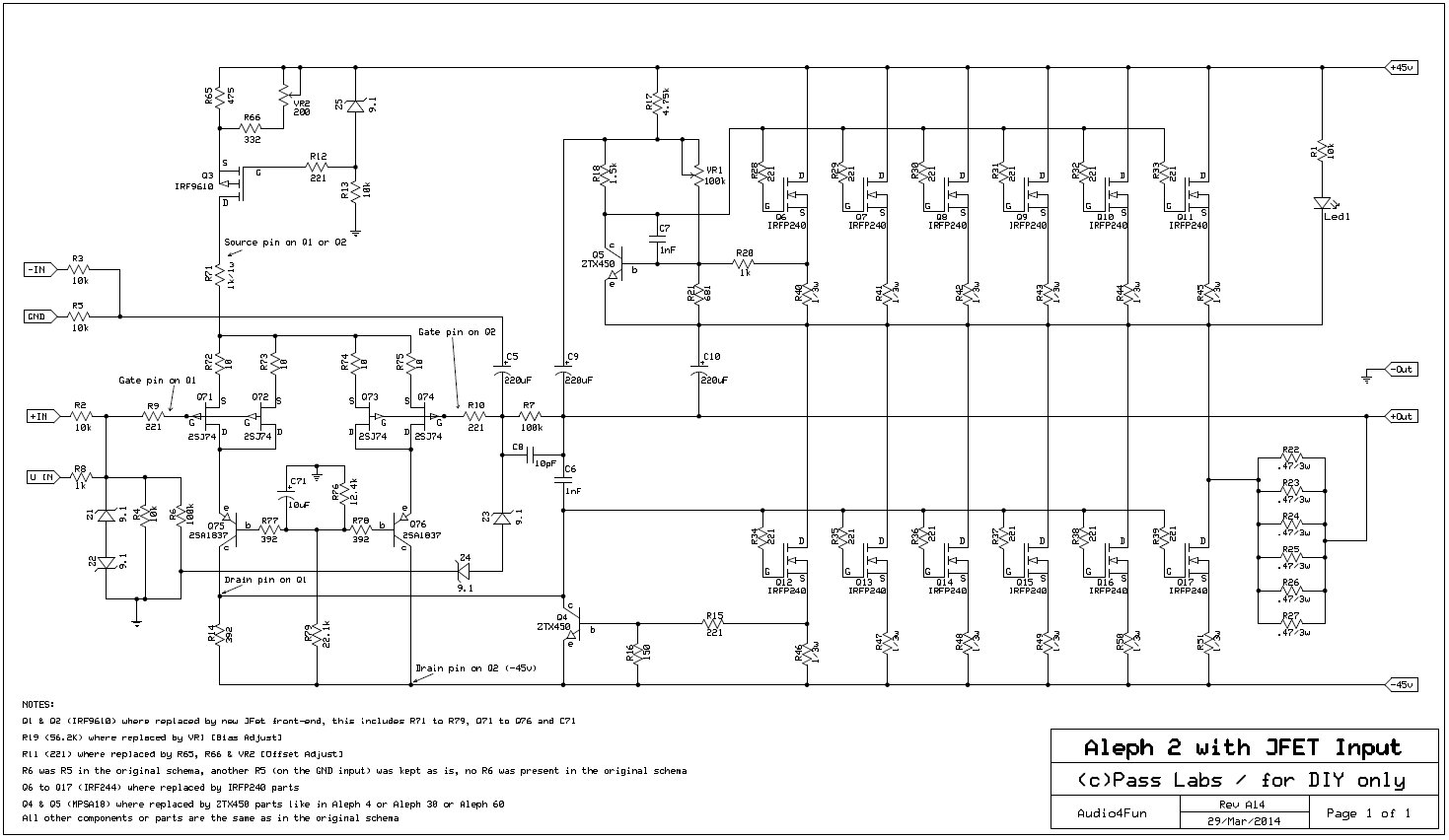

May be you could try the JFet updated version of Aleph 2 that I build with the great help of some forum members :worship: (have a look to http://www.diyaudio.com/forums/pass-labs/252230-help-wanted-jfet-front-end-aleph-2-a.html)
The changes are small, but the sound improvement was outstanding. :)
Attached you will find the A2J schema in jpg and pdf.
Alejandro
