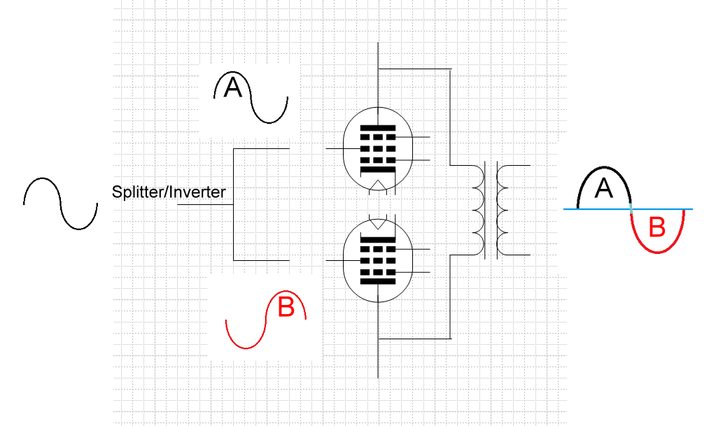

I put together a graphic that shows some information from the US NAVY electronics training manual to help explain where I am confused. I understand that the original signal, let's call it a 1 kHz sine wave, goes through the splitter, and it ends up at two outputs. Each is the sine wave but each is 180 degrees out of phase with respect to the other. In timing, they begin at exactly the same point, and they are fed to the output stage. OK, so now look at the block diagram at the bottom right corner. My confusion is how the first (positive) half of the waveform in the + portion of the leg (green at the top) ends up at the output in its same phase, while the second half of the waveform, handled by the - leg (red, at bottom) ends up at the output inverted again, so that it is in proper phase relationship to the first half of the waveform.
Think of it as if the two out-of-phase signals are input to a transformer with two primary windings. Say the primaries have pins 1-2 and pins 1a-2a, such that a pos signal at pin 1 or 1a causes a positive signal at the secondary.
Start with the '0-degree' signal, connect it to pin 1 and ground pin 2, that causes a pos signal at the secondary.
Now we connect the '180-degree' signal to the other primary but this time we connect it in the opposite way: we connect the '180-degree' signal to pin 2a and we ground pin 1a. This again causes a pos signal at the secondary! Connect both signals and you get a nice clean signal on the secondary.
That's what actually happens in the amp, except that there's some tube between the signal from the splitter and the xformer to provide some extra muscle, but the principle stays the same.
Does that help?

I have an additional question that I could not find the answer for. Push pull amplifiers require phase splitters at the input stage, but in the output stage, the signals are in phase.
One side handles the + portion of the waveform, and the other side handles the - portion. Why is it necessary, then, for there to be a phase inverter/splitter at the input stage, and how are the signals made to become in phase between the input stage and output stage?
As you say, one side handles the -ve going waveform. But to create that -ve going waveform you need to switch on a tube, which requires a +ve going waveform. Hence you need a phase splitter.
The output transformer winding for this tube dedicated to -ve going waveforms is then wired out of phase, so the tube's +ve going output is once again phase inverted to a proper -ve going output.
I.e. the phase inverter + transformer connection on the -ve going tube allow the tube to operate in a +ve going way to create the -ve going signal.
Positive: 1:Buffer, 2:amplifiy, 3utput
Negative: 1:Invert, 2:amplify, 3:invert
in the 1:splitter, 2:tube and 3:transformer sections
I'm not an expert but have picked this stuff up over about 30 years, you should read the books pointed out at the thread as you need to gain that knowledge in a short amount of time - it will make a huge difference in how you explain stuff.
In addition 'crossover' in this context means the handing over of signal from the +ve side to the -ve side - the transition and subsequent crossover distortion. This also relates to class A, class AB, class B operation.

Explaining single-ended is easy, but I am having a tough time with the balanced and push-pull, because I can't find an explanation of where the phase inversion occurs at the output to make the negative half of the waveform in the proper phase as it was at the input before phase splitting/inversion. It sounds from the latest posts that this is something that occurs in the output transformer. I have attached another diagram. I know it's hard to put into writing an explanation that would best be served by something like a webinar where we could draw things on top of the diagram as the explanation occurs, but take a look at the diagram and state where the taps might be from top to bottom on the primary winding and which parts of the waveform come out on the secondary winding.

You are missing the center tap for the B+ i n your transformer primary.
The phase inversion is necessary because the transformer primary is wound such that the steady state bias current from the two tubes cancel each other. The windings are out of phase to accomplish this. Since they are out of phase, the driving signals from the output tubes MUST be out of phase with respect to each other to add (double negative) to produce a useful output.

Imagine plates of a pair of push-pull tubes driving the phase splitter output, as an input.
It seems what you're really missing is how a transformer works. In that case you may as well forget about the tubes for a while until you recognize how the voltages appear on various transformer windings. The tubes don't have anything to do with that and are probably just serving to throw you at this point.

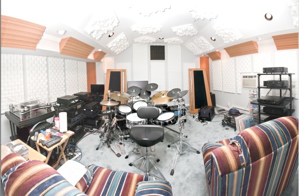

A photo of my main listening room is attached. I have my drums in there as well, and use them to play along with my classic jazz LPs. When I do critical listening, I loosen three clamps that attach all the drums together via four chrome tubes, and move it all against the rear wall.
