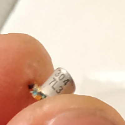

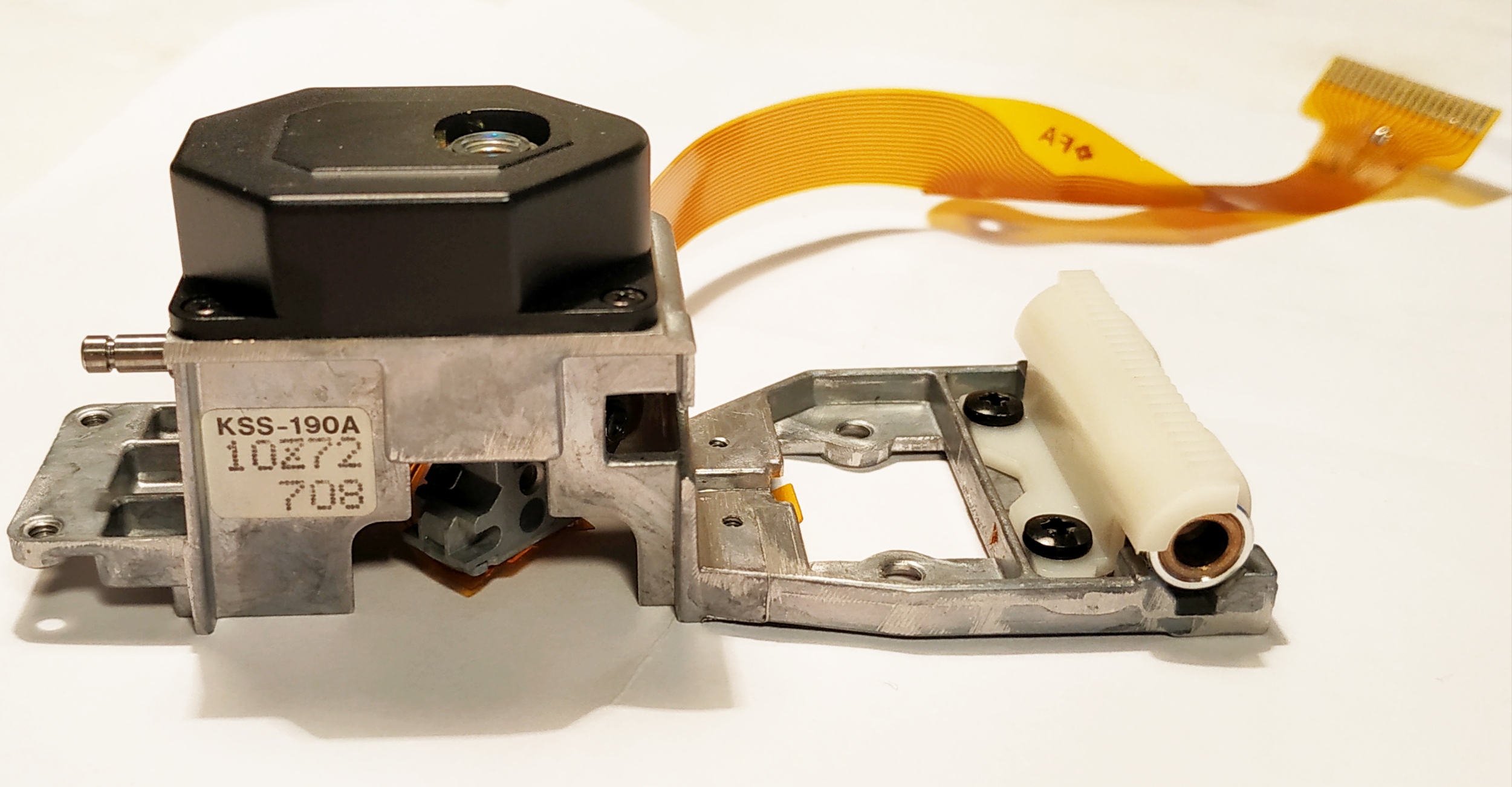

I also had a question about replacing the diode in the KSS-190A and KSS-271A. I will buy diodes, I will take 5 pcs. and I’ll try to do it myself. But most likely, in addition to adjusting the diffraction grating, the position of the photodiode array can be rearranged, and this greatly complicates the situation.
Since the diffraction adjustment is not possible in these blocks, it is glued, the diode itself needs to be adjusted.

The diode in KSS-190A has so far returned to its place, it is still working, but the radiation power is very weak, it will not detect the CD-R at this radiation power. In feedback, the RF amplifier CXA1081A (between pins 2-3) increased the resistance of the resistor to 47k. To artificially raise the level of the RF signal, CD-Rs are now detected, but this is a temporary measure to use it at least somehow ...

Maybe. But I was playing around with a BU-1 that did not need repair.
After removing the original diode and after putting it back, the Eyepattern was still there, though very blurry. Only after I touched/moved the grating (which was secured by thread locking fluid) things did not work any more.
So I assume, if there is some room for the diode to move, there is a chance
to do an alignment by positioning the diode.
Does the KSS-190 give some room for the diode to me moved?
Ist there also a spring that fixes parts like the diode?
In the BU-1, the spring gives pressure on the grating as well as on the diode, so things cannot move out of alignment...
