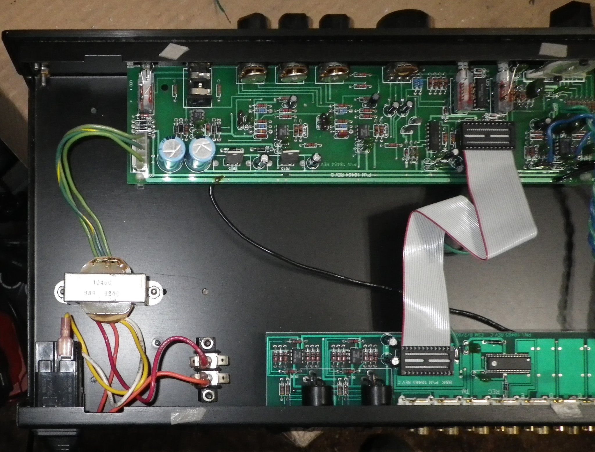

Here's what I have with the thing plugged in.

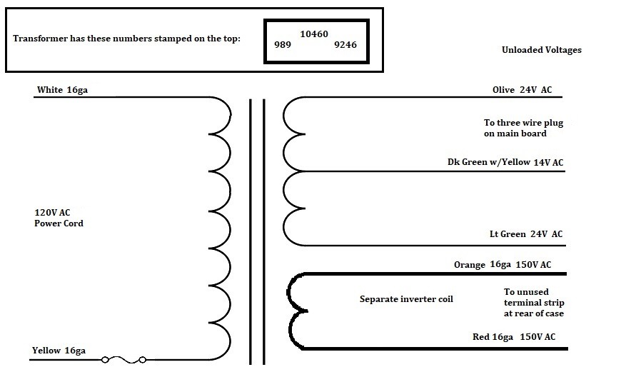

The transformer has three sets of taps.
120v in, and the three green outputs go to the main board,
as shown below as viewed from behind and above
There are also two more wires, a heavy red and heavy orange that come out of the lower windings which
go to a two pin terminal block that's not used, both of those wires read 148v ac, both higher than line voltage.
The transformer gets rather warm pretty quick but nothing on the board gets warm and it doesn't light the dbt.
No lights were lit when I had it on the bench the other day.
The tape monitor indicator is now glowing all the time, its a momentary button with no latch but otherwise the same button/swich as the bypass switch, must minus the flip flop lever or spring. Both boards are grounded with 12ga wire soldered to the chassis on each side.
If I unplug the power plug from the main board, I get 23.9v and 13.3v ac with the transformer not connected to anything but the voltmeter.
Wall power is reading 124v ac today, usually its a bit lower, closer to 117 or so here.

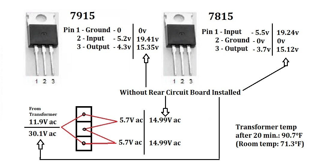

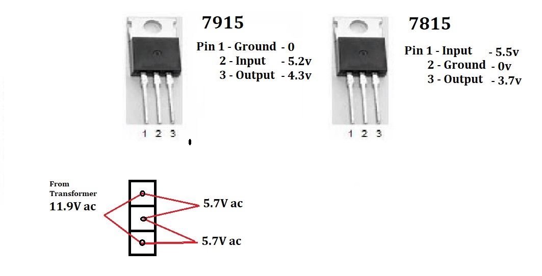

Here's what I have for volts on the two regulator transistors.
Re post 3 : so the voltage with unloaded transformer seems OK ? It should be about 15 + 15 volts or more.
Loaded down by the main board it is less ? This can destroy the transformer in the long term, hence the advice
to try an external supply. I do not completely agree with the suggestion that the "short" is "after the regulators"
(7815 and 7915) - you can check the four diodes near to the connector as next step, but probably the transformer
is already damaged. It is switched secondary only and so connected to the mains all the time.

The transformer appears to have an inverter leg for no reason?
The red and orange wires go to an unused terminal strip.
This is what I'm seeing at the transformer, unloaded:
The transformer still gets warm even when unloaded. its not too hot to touch but it gets warm fast.
I'm not sure what I can use to power the board directly or what voltages I should have where?
I can see the two regulators are rated at 15v, but this thing appears to have two voltages on the board at that plug.
Or is what I'm seeing the result of the damage?
I have no schematic for this.
What are the transformer voltages supposed to be on the secondary wires?
Nothing on the board gets hot, not even slightly, there's zero temp rise on any components using an infrared thermometer.
I would think if there were a short, I'd have something warming up fairly quickly?
I'm really not understanding why its got the 150V high voltage tap there? Its not used but why bother?
Could it be for a Euro version and the higher volts are something I'm reading as a by product of unused windings?
I also find it odd that the terminal strip, which has several unused spade connector points on it, is left out in the open like it is with no
insulation. If I follow the leads into the transformer, the yellow and white leads turn upward into the paper wrap, the red and orange go straight into the lower windings which are wider, but shorter than the rest.
Could the red and orange by an unused 240v input that's somehow giving me an inverted voltage on those wires? (Either way, its likely unrelated to what's going on here but I though it odd that I got such high readings off those wires).

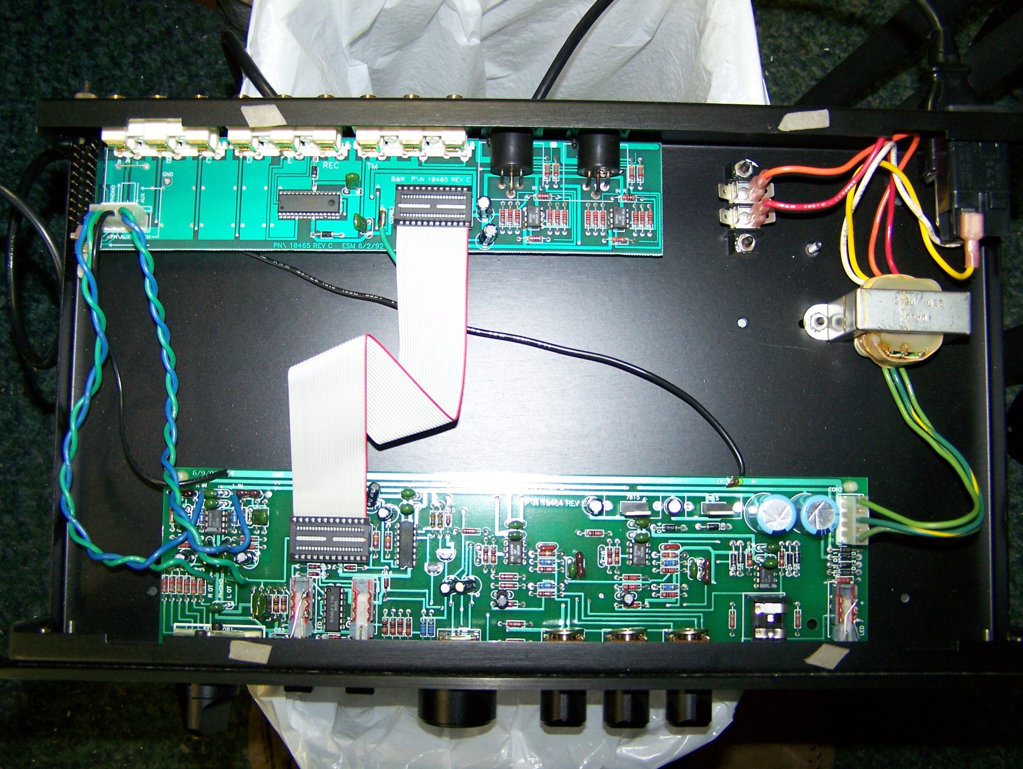

I gave this some thought all night and got to thinking that the volts on the transformer didn't make sense, the loss was too great for any power supply, and the erratic light operation had me puzzled a bit.
I noticed that if I unplug the main board power connector the Tape Monitor light would flicker and go dim, but never go out, regardless of whether or not I was holding the button in or not. (I still don't get the momentary function of the tape monitor button, which is using the same model switch as the others, but with the flip/flop lever and slot not present).
The transformer was getting warm enough that I could smell it but it wasn't too hot to touch, but hotter than I'd expect something that size to get.
With it powered up, I started to unplug the cables to the rear board and found that when I unplug the ribbon cable the volts jumped up to 30 and 15V AC at the plug and the heat dropped on the transformer. Removing the wire plug near the phono jacks made no changes.
After the transformer cooled down completely, the standing volts remained the same, no loss due to load.

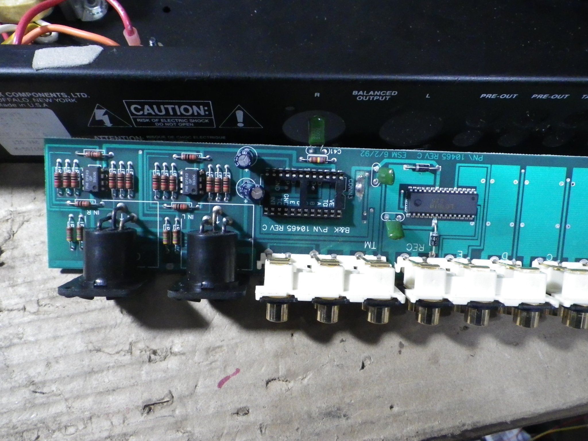

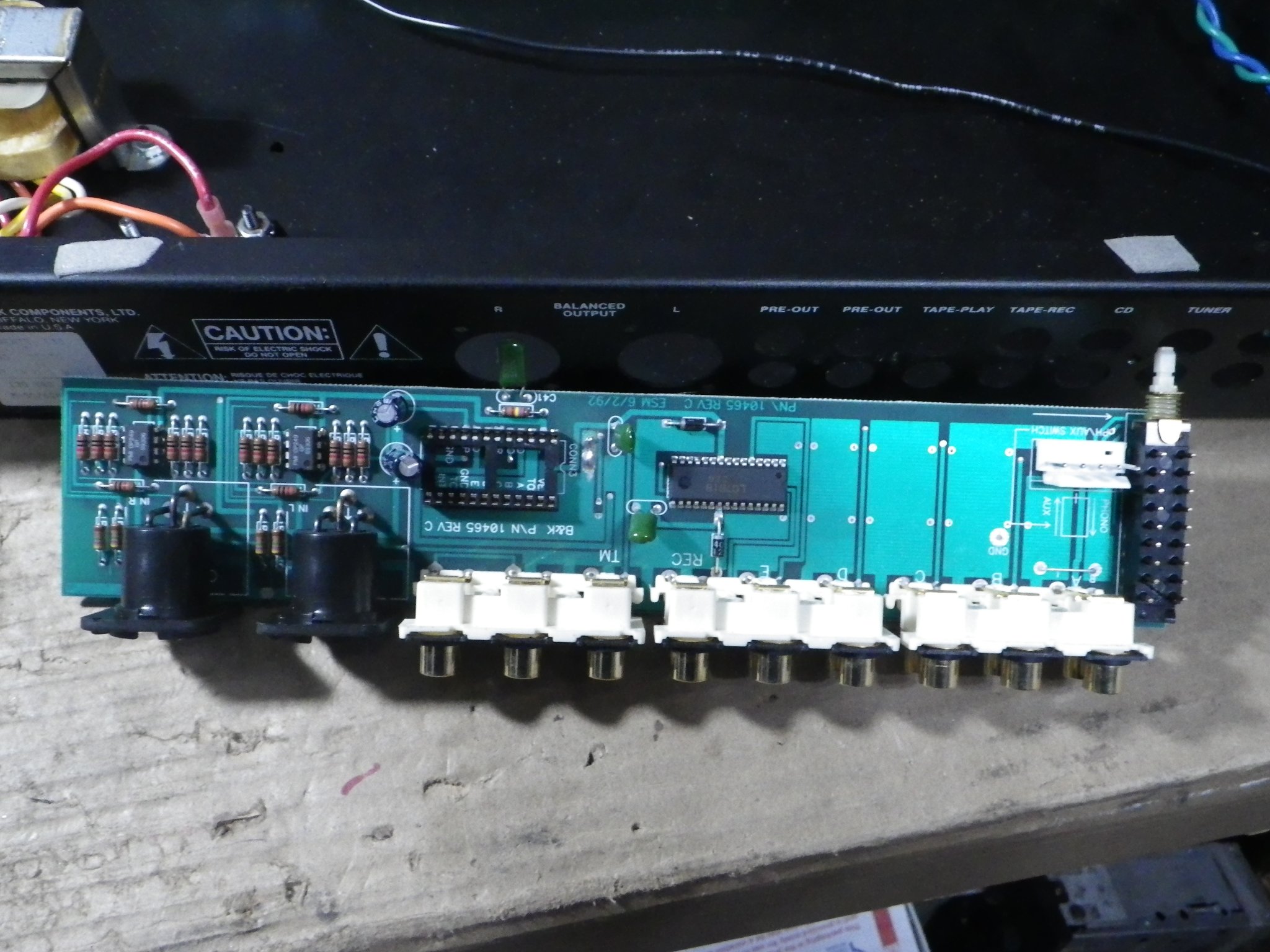

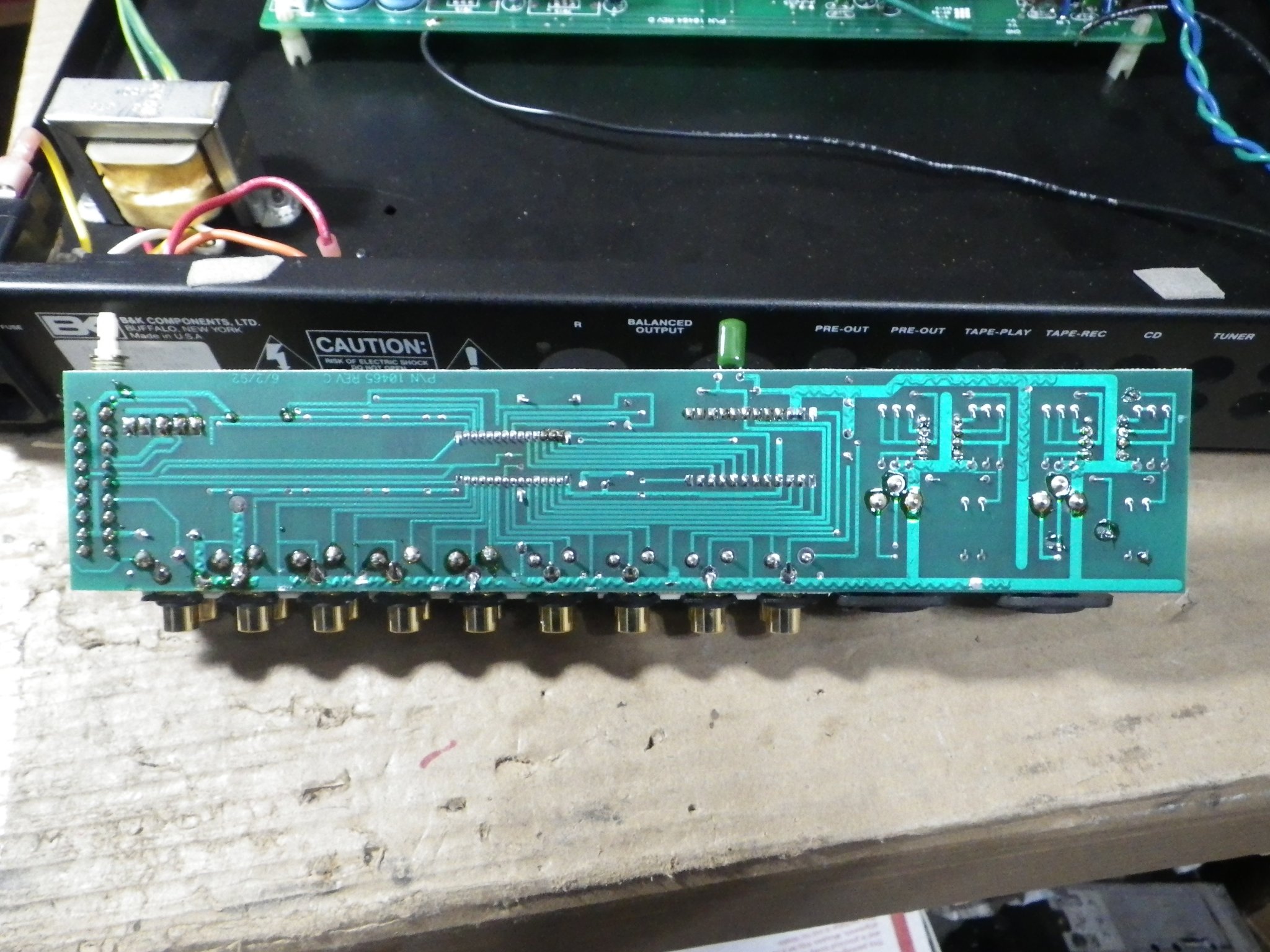

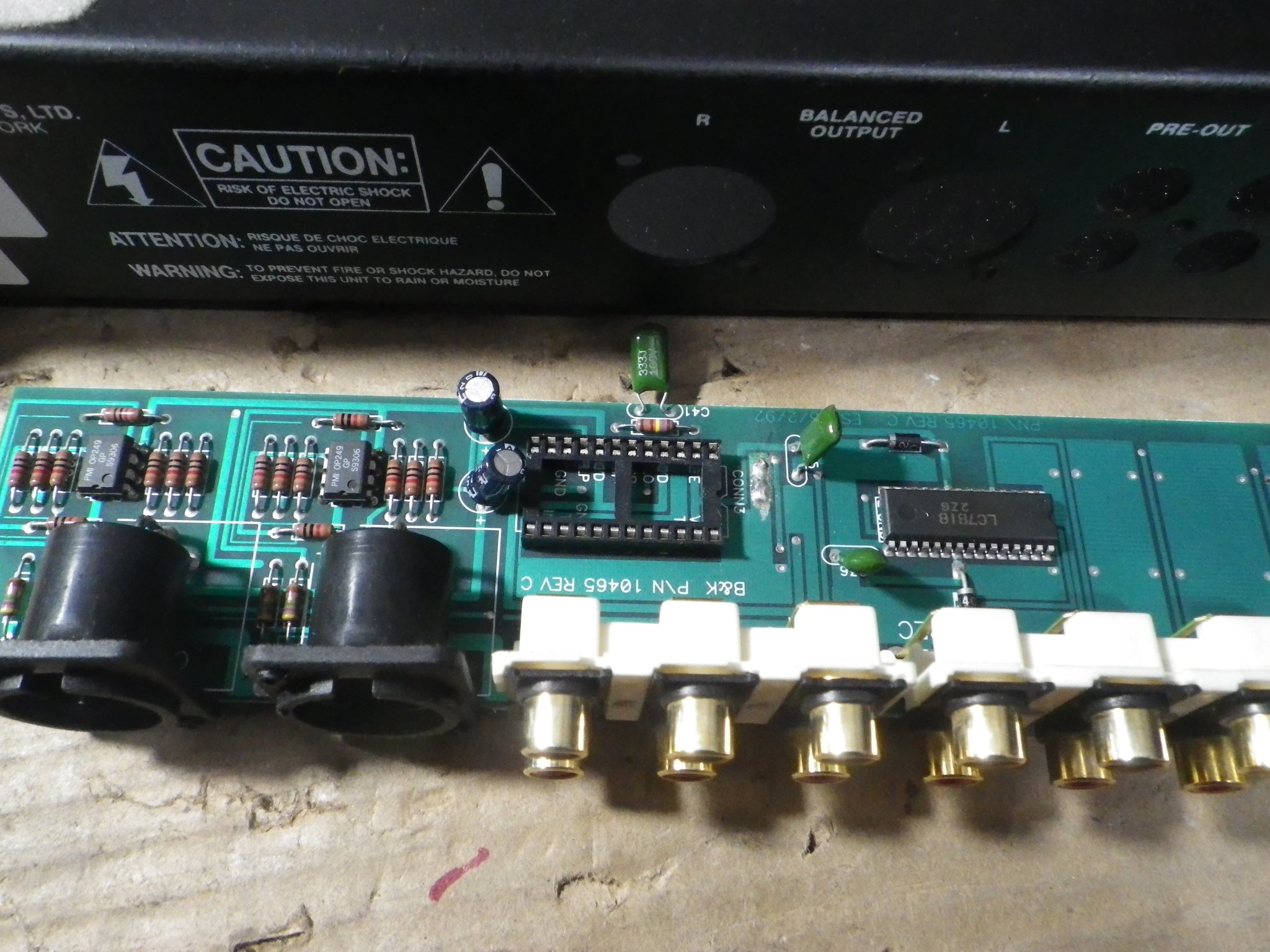

I pulled the rear board to have a closer look and found a good many of the traces wrinkled up, and three pins darkened on the LC7818, those correspond to pins B, C, & D on the ribbon cable.
That end of the chip is warmer than the rest of the chip.
I'm thinking that something took out LC7818 by overload and it failed? Its only slightly hotter than the rest of the chips when powered up but I believe it would prevent the thing from switching to bypass mode too.

Well, did you notice this before and did not tell us ? You can read about defective B&K CS 117
transformers in other threads and that it may be caused by dead IC LC7818 on the rear board.
Disregard "wrinkled" traces on the board, this is caused by excessive solder in solder bath.

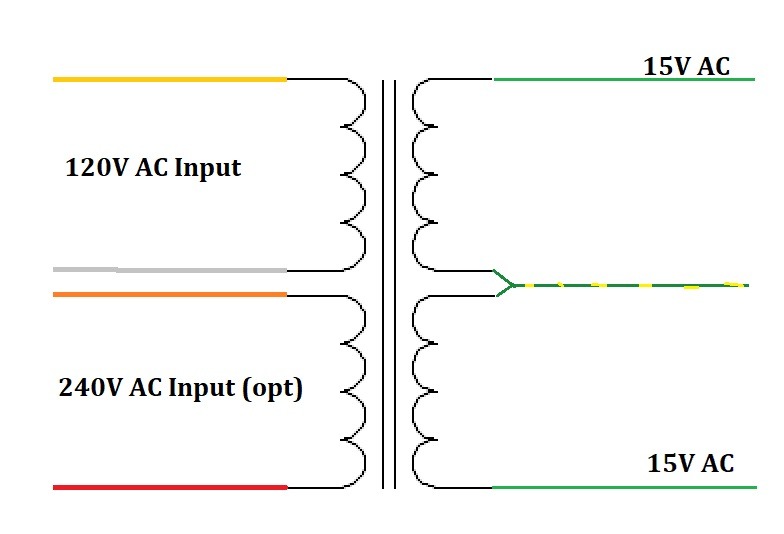

I finally found something on the transformer, its supposedly a 30v (15-0-15) .65a unit with dual inputs for both 120v and 240v.
I'm now not certain that the unused 240v taps should be inverting voltage like they are?
I can't say I've ever dealt with a dual input transformer like this, and certainly not one that had voltage output on the unused windings like this? Its apparently not affecting the output though and I'd pretty much have to figure that the 14.99v I'm seeing at the green wires is in spec. I would likely swap it out though if I had one or could find a suitable replacement without spending more than this thing is worth, but I think swapping out the LC7808 is likely going to be the fix, unless there's other damage along the way.
What I can't figure out is why when I pulled the power connector off the main board before I got lower voltage unless it was being affected by its being overheated.

I think this is a more appropriate schematic for the transformer?

I removed the LC7818 and powered it up without it and the short is not there.
I dug through as many boxes and drawers as I could but couldn't find the LC7818 chips I know I've got somewhere, so I ordered some more.
Do you think it will hurt this any to install a socket to hold the new LC7818? Those I did find.
My thought is that these things seem to be failure prone after reading about so many being bad.

I think this thing was worked on before, those three pins on the LC7818 that looked darker in the pics above were re-soldered at some point. They were coated in dried up flux. When I took the chip out, those three pins and the printed circuit traces around them were corroded, as were those three pins. The pin holes in the board are actually made larger with the ferrules gone that went through the board to the little pads on top. It shouldn't be an issue though as the top traces don't connect to the pins there.
I honestly think this thing would have been better off without that chip there to handle the switching functions, but the circuit to take its place would take some doing to build, so it gets a new chip for now, and likely a socket to make any future replacements easier. It'll also make cleaning up the board a bit easier without the risk of future damage removing the chip if another were to fail.

As far as I can tell the transformer is fine, I'm getting 15-0-15v on the outputs in AC volts, and there's 19.2 V ac after the four diode rectifier and over to the two regulators, and I figured that a few points over 15v is likely well within their spec.
Other than checking voltage, I'm not sure what else I can do to check the transformer.
The LC7818 is just a switching or selector chip, so it shouldn't be drawing down anything.
Being its a preamp, there's not a lot going on in there, which is likely why its got such a tiny transformer.
