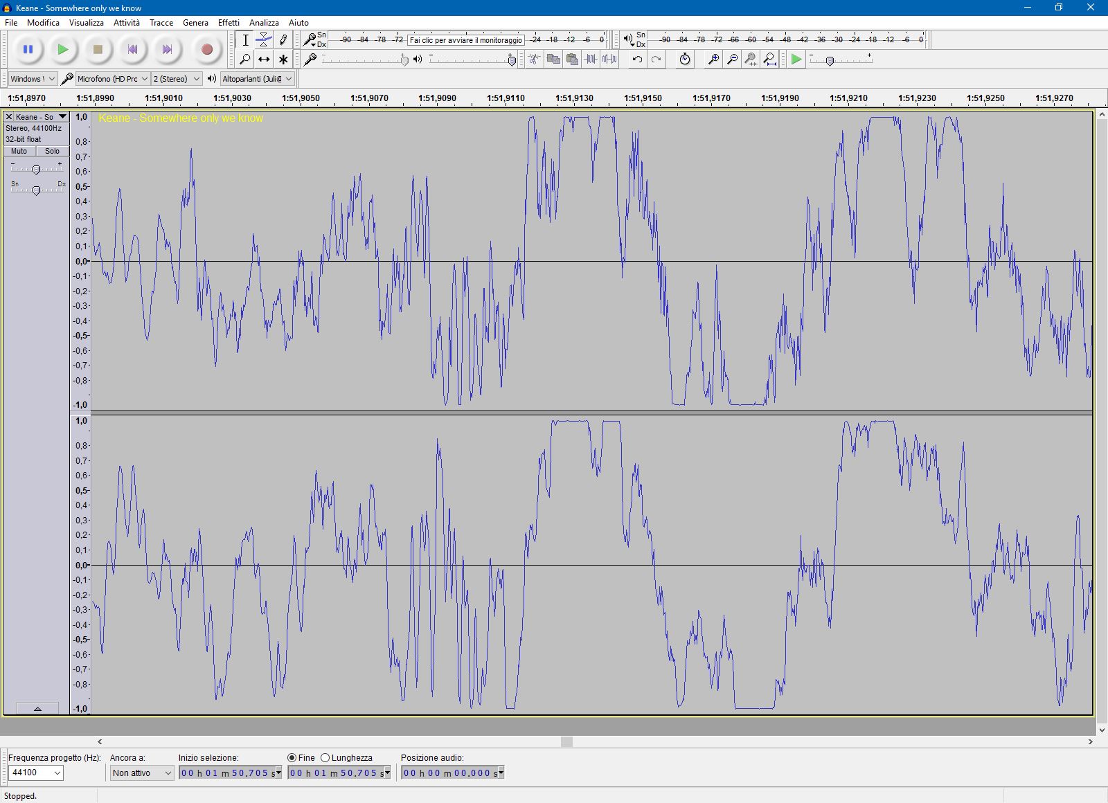

De-mastering smashed recordings with Stereotool (Loudness War)

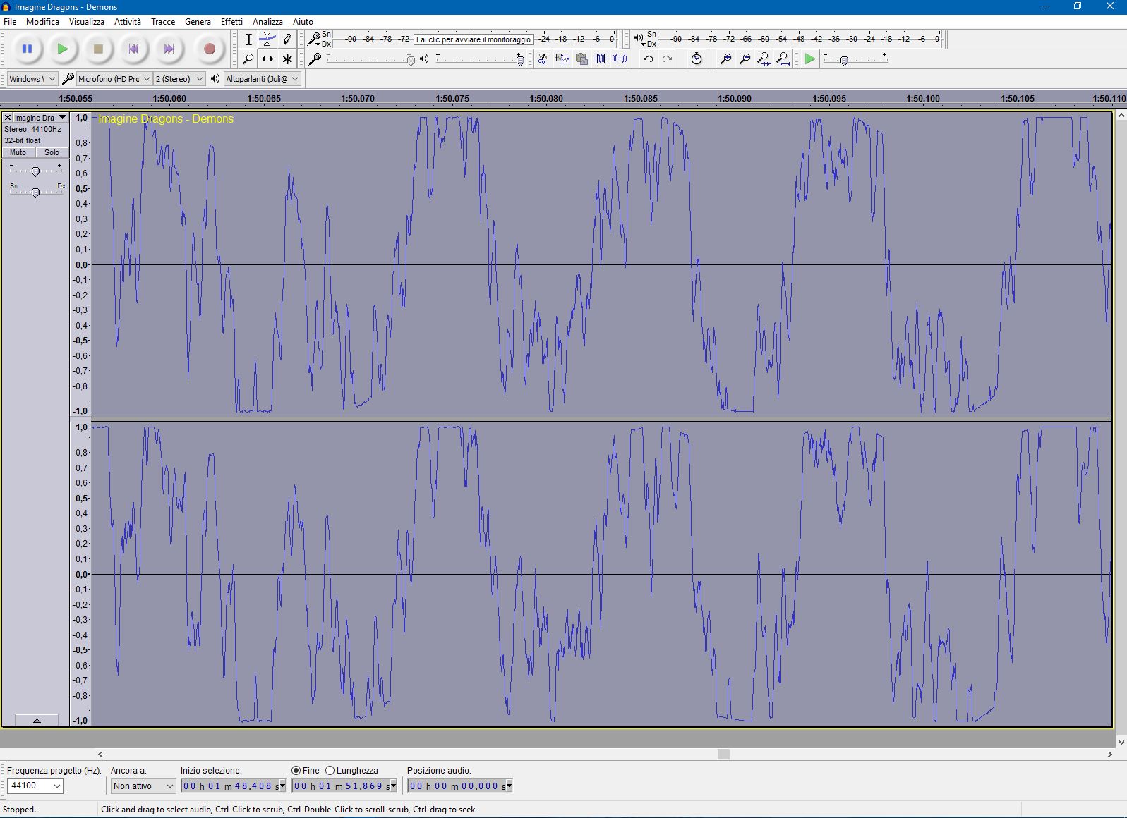

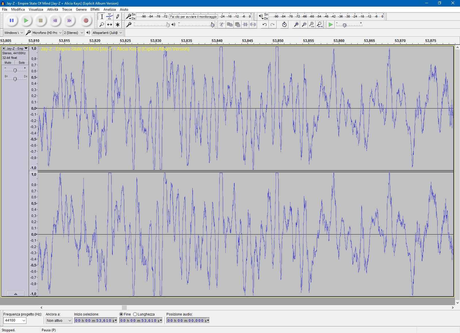

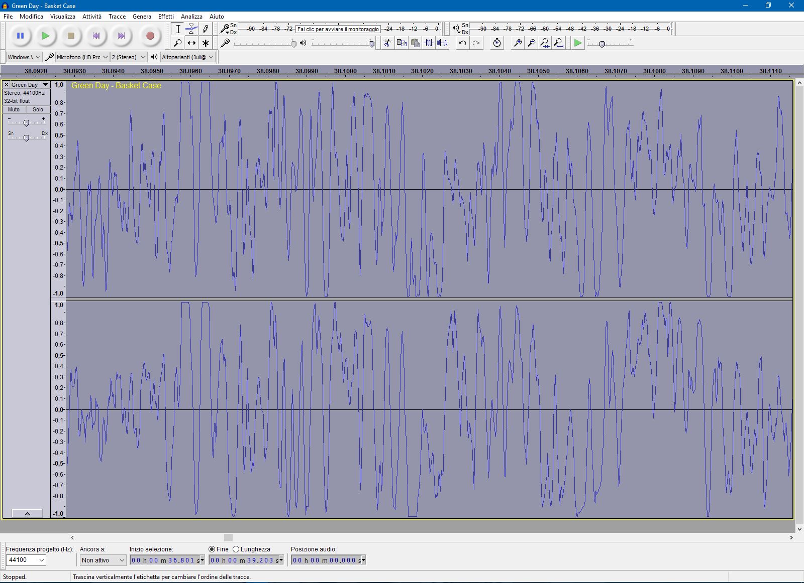

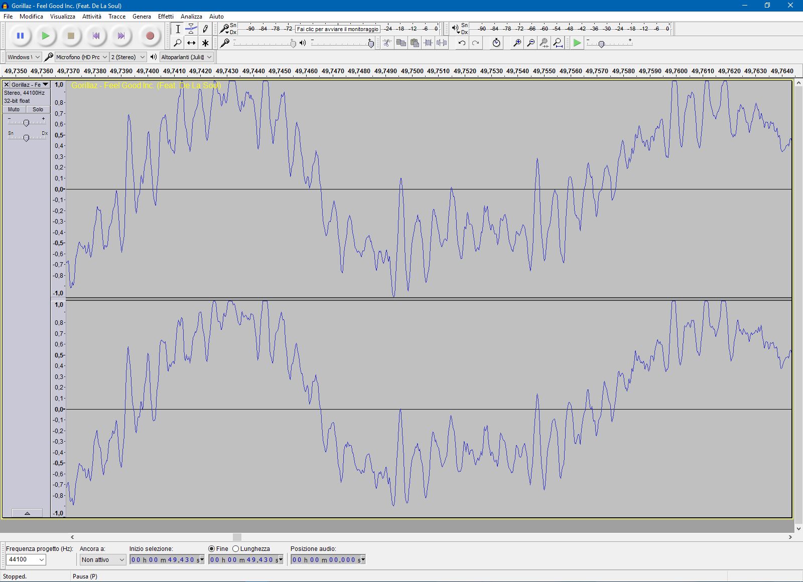

No mixer or mastered will deliberately hard clip a track. This is basic audio engineering 101. Take those original files and expand the time out till you see the peaks you will not see any table top waveforms. So I have no idea what a declipper does to signals that weren't clipped but actual soft limited. Your are using an effects box. Companding only works because the parameters of the compressors are exactly mirrored in the expander. Since you have no idea what the multiple stages of comp/limit parameters were there's no way you can properly decompress/delimit the signal. Sure you can increase the dynamic range but the dynamics will not be the same as the original. You are using an effects box. That said, if you enjoy the outcome go for it. Just wanted to warn people that this is a bandaid for a hemorrhage. It's not really a fix to the problem.
It was audio engineering 101... no more and from more than 20 years... sadly...
Never heard about brickwall limiters?

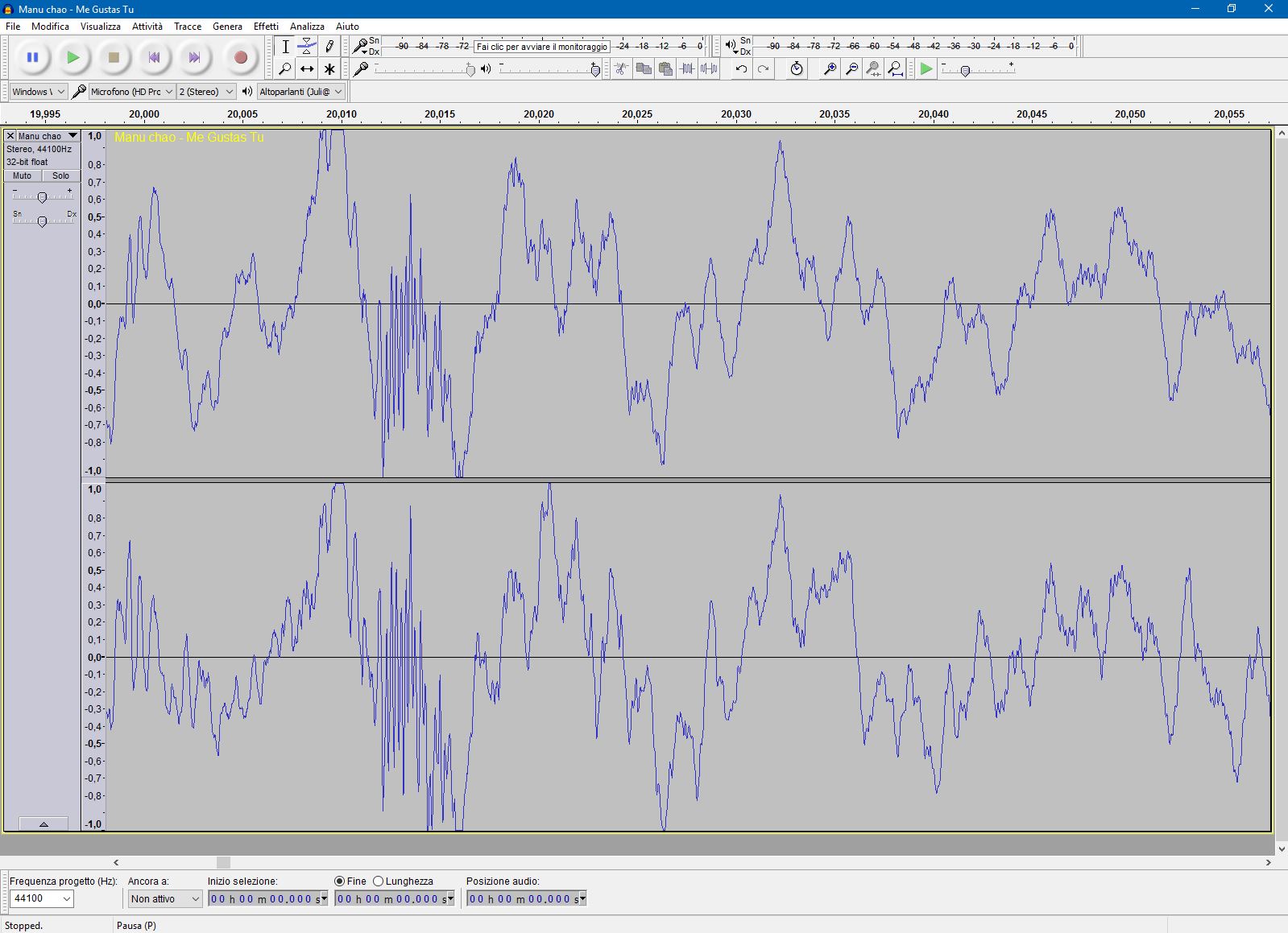

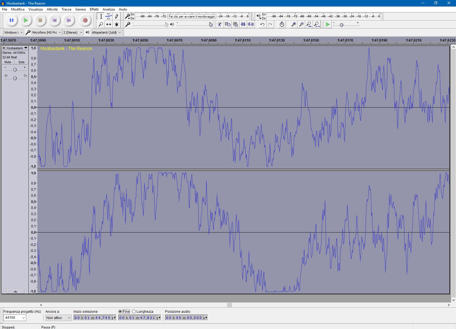

This last one is more interesting because it shows a multiband brickwall in action.
Bass content is clipped but some high frequency content is preserved.
attachment.php

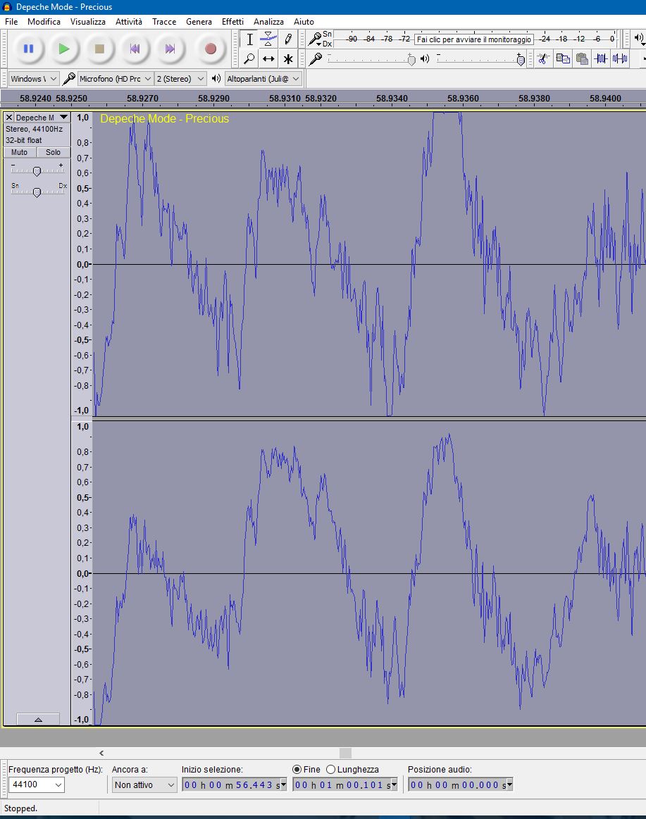

Sorry, no... a declipper does nothing on soft limited waveforms... it tries to reconstruct the clipped part of the waveform based on various tecniques like interpolation, spectrum analisys, surrounding unclipped data.

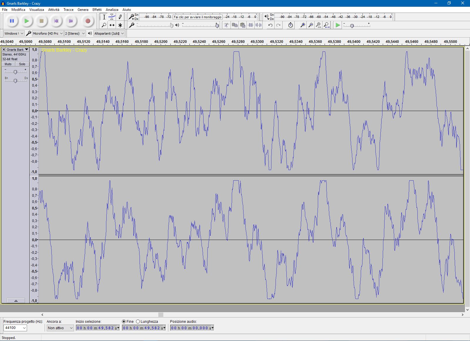

Since I've already 'warned' people from the opening post it seems to me pointless... BTW I think you missed the point of the whole thread.

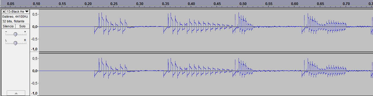

We agree that we can't recover completely the original waveform before the crazy mastering 'best practices' of the last 20 years but something can be done to reduce distortion and recover some dynamics.
The result is not an 'effect box' but a waveform which is less distant from the original and more enjoyable to listen to.
Maybe you should try and tell us your opinion after. ;)

So far we didn't lost resolution since we worked at 32 bit resolution but the output, usually at 16 bit, will loose some details.
The waveform can (and should) further be optimized maximizing the waveform to 0.1-0.3 dB ceiling and applying dithering so to loose less details as possible.
StereoTool Clipper do a nice job but Wavearts Final Cut do better and have a professional ditherer too.
Also we should apply some soft-limiting (1 to 3 db under the max peak), the software don't necessarily recover all peaks.

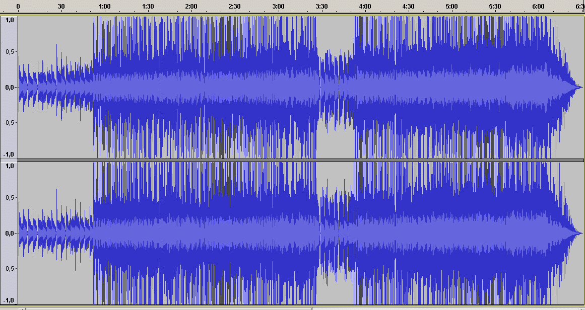

You'll be surprised how much of todays "remasters" are full of clipping, I've had to show examples to numerous persons not believing it. For sure you'd think that "mastering engineers" should know how to do their job, well if they do they don't want to show it to the public..
A great example of this behavior is the Eagles' "Hotel California", in samplerate of 192kHz and 24bit resolution, HDtracks SELLS this one and people are buying.
An example of the title track from the Eagles' album:
On 1984 CD release theres lots of headroom, although "only" 16 bits of resolution, peaking at -2.48 dB, while holding dynamic range of DR15.
On 2011 192kHz release with whopping 24 bits, peaking at "over" 0dBFS, dynamic range of DR12..
I've attached few screenshots for "backing up" these claims. First one shows the overall waveform, second one is "zoomed" to show the "tops of the pops". Third pic is a spectrogram of part of the song, those vertical lines are clippings which hold "infinite" frequency. This makes the music fatiguing to listen to..
I do not have any pics from 1984 release, but I presume its fine..
I don't know and don't care to know who "mastered" this high resolution release.
Unfortunately this is todays "common practice" in "mastering", from what I've seen. But not all mastering are done this way, the good ones are usually from "audiophile" companies such as MoFi, Audio Fidelity etc..
Some great HD downloads I've come across are George Harrison - All Things Must Pass (2010 24/96kHz) and Joni Mitchell's (192kHz) releases in general, to name few...
