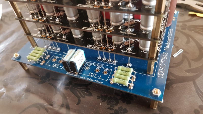

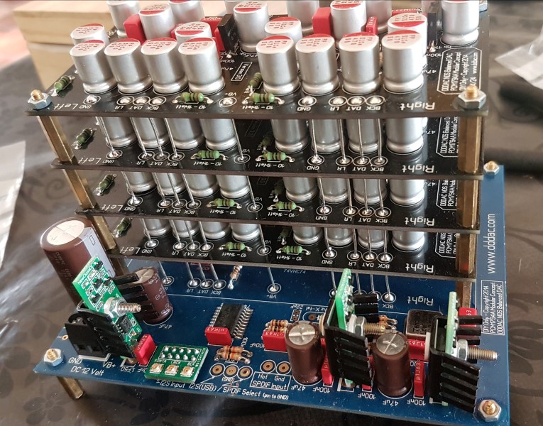

Up for sale is a DDDAC 1794S Mainboard V3.0 with a Tentlabs low jitter clock. Caps are replaced by Elna Silmic II. There is a UFL adaptor on it for the I2S input.
Regulators are New Class D UWB's
All never used.
The DDDAC has 4 dac boards. These are the boards right before the Tent reg versions. I bought these last october from a fellow DIY-er here. These boards have been upgraded with Nichicon FP NS series polymer electrolytics and the pin 20 resistor is a Charcroft S102J. .001%.
Output resistors are Kiwame´s and the optional filter uses Amtrans amco.
The original switch and the small pcb for the LED´s are included. I think three led´s where used for another project. So not all of them are there. Original cabling is there.

G'day,
just looking at the pictures supplied
Those Amtrans AMCO capacitors mounted across optional HF filter are wrong. The lowest value Amtrans AMCO is 0.01uF or 10,000pF. The filter should have a value of 5-10pF per deck so 40pF max in this instance.
Johno
uhm, no it is correct: 5-10nF is the correct value per deck
where did you got the info it is pF? If it is wrongly stated somewhere it need to be corrected
thanks
