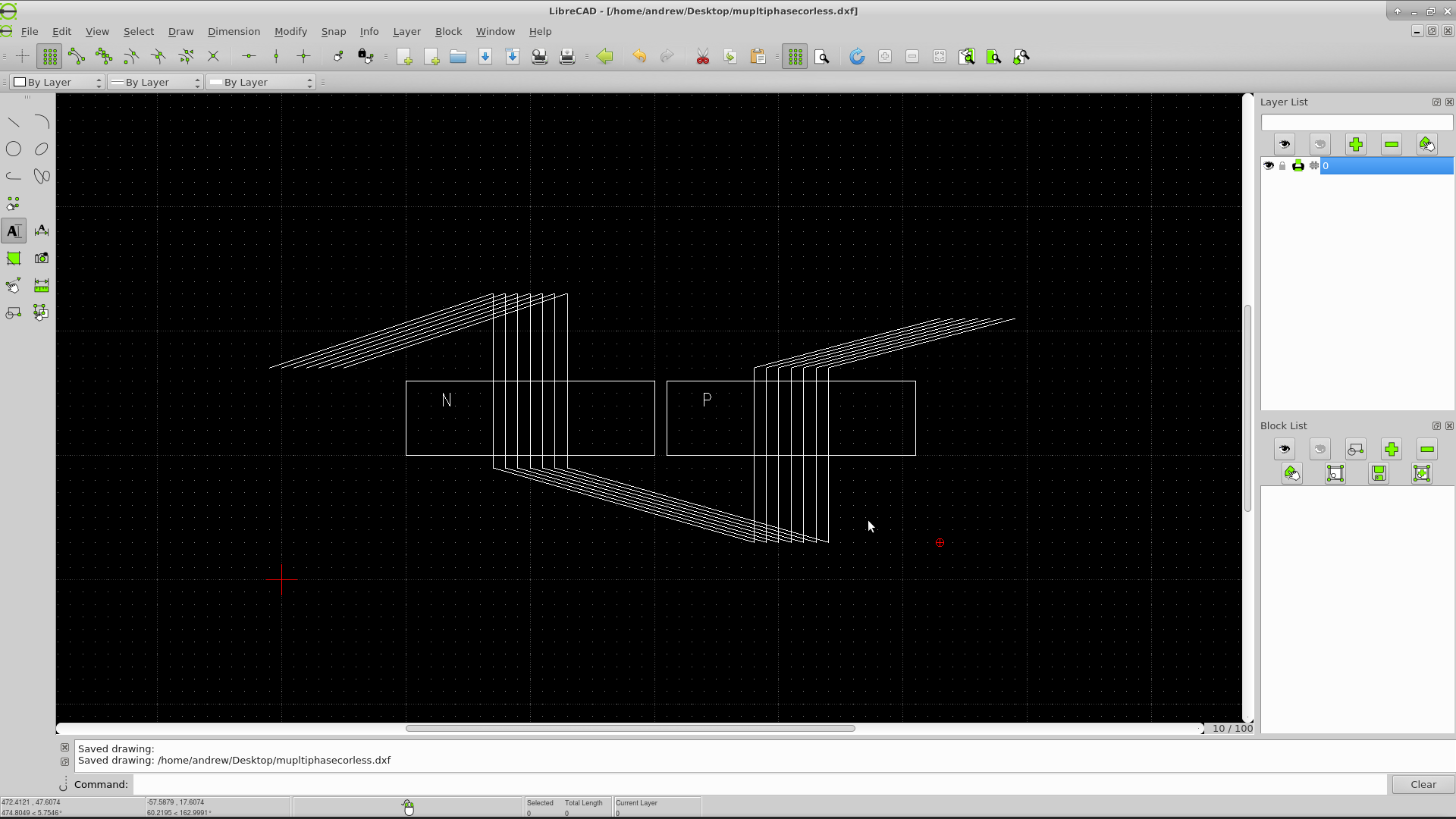

I don't know whether this is completely obvious to everyone already but I've never really seen hardware like I was talking about in the field. I'm also not a huge CAD whiz so I made a really simplified drawing to show.
The example drawing appears to be a linear arrangement with 7 phases, but the actual implementation would be a circular axial field PM array with contiguous windings.
However, drive would be 7 phases at a time (for sake of this example). Gap flux density in this center region of the pole faces should be fairly constant. So long as the back-end winding were ramped down with current at the exact same rate as the leading winding were ramped up, you'd have nice low torque ripple. Of course the more phases you have, the less average force is involved with the 2 that are switched at any particular time. Power density would be low compared to having all phases under the poles active, but we are probably not as interested in that, or efficiency, compared to smoothness of output. End windings are large so again efficiency would take a hit. Shielding is a serious problem.

I may have missed in previous posts, but is there a certain magnetic topology you intend to explore first? Another benefit of the coreless arrangement is zero "off axis" force, so no weird ancillary flexures to contend with. We are, after all, talking about extreme performance?
