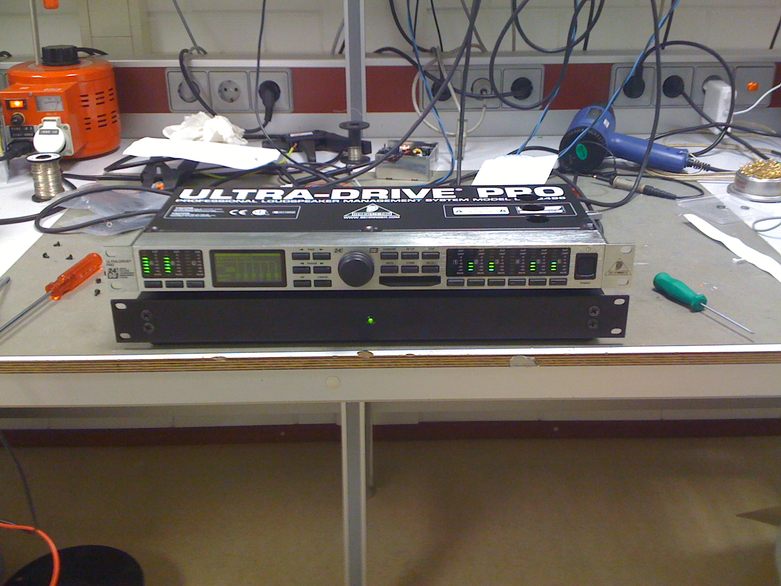

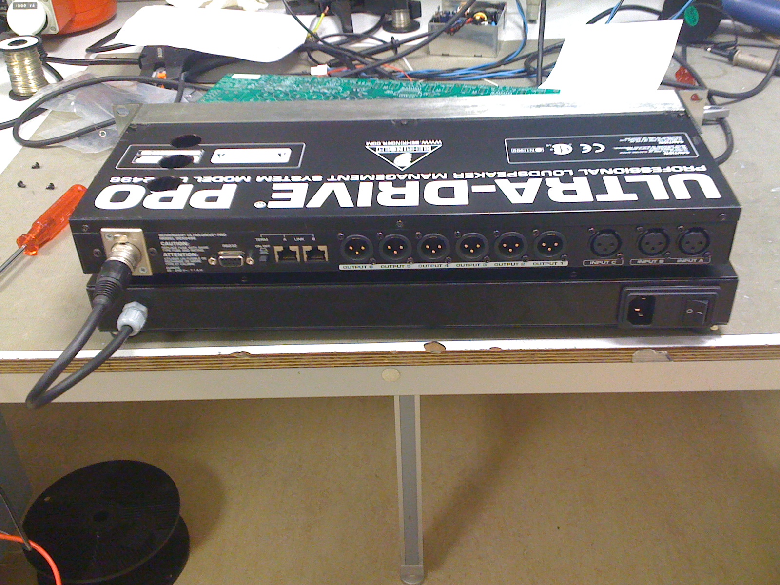

Dear,

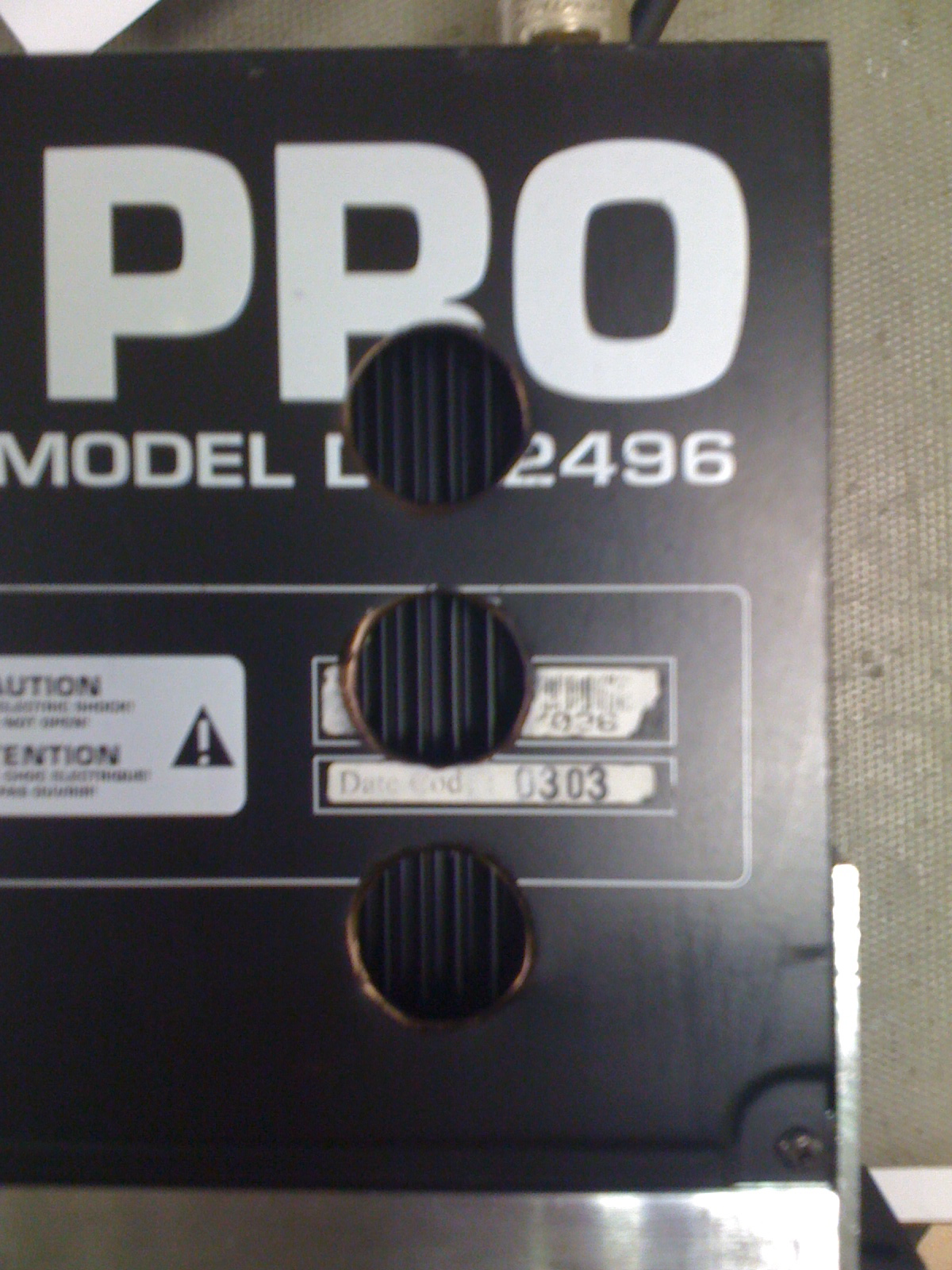

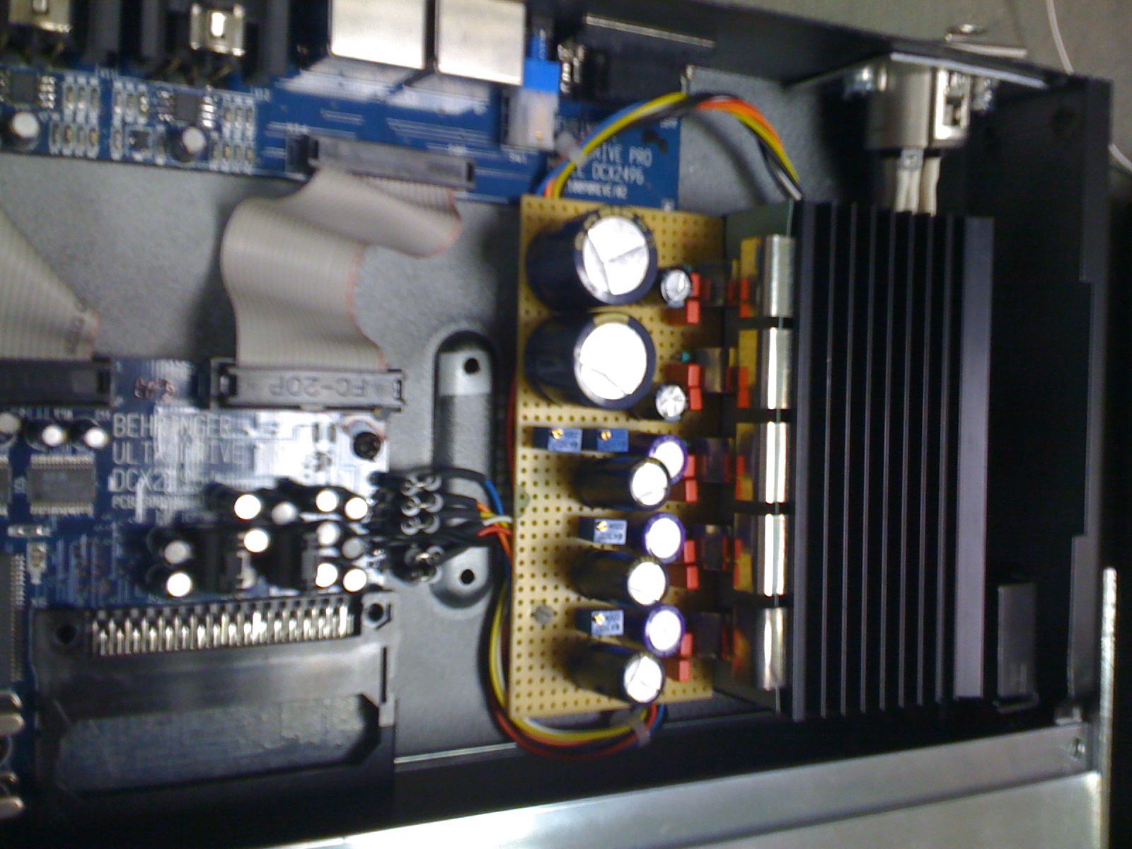

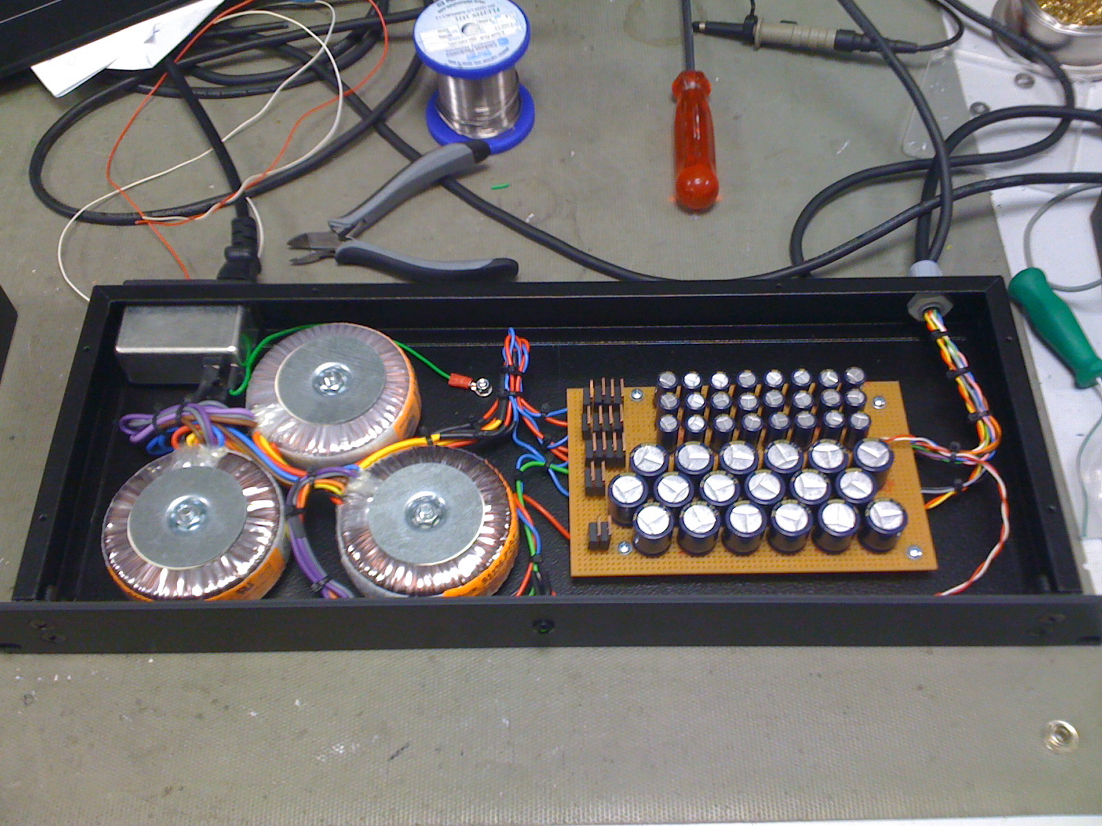

Here a modification of the DCX2496 for one of my clients.
Besides the usual mods (opamps and capacitors) I replaced the whole switched PSU by a linear design. The regulator stage is mounted inside the DCX. The transformers and rectification in a separate enclosure.
Sorry, no schematics or drawings since I build it from scratch out of my healthy mind :D
With kind regards,
Bas
