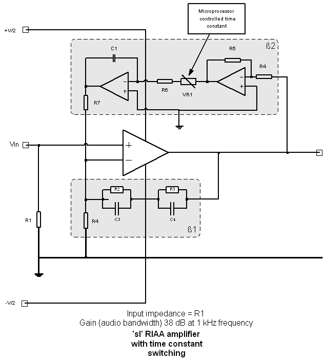

There was once an Elektor circuit that used two additional poles within the servo circuit.
IMO they shouldn't add any phase-shift to the audio signal but they should reduce negative effects of the loop like THD from the OP-AMP.
IMO any circuit with a servo should have an input cap as well which determines the lower cutoff frequency of the circuit. The time constant of the servo should give an additional highpass-pole that is at least an order of magnitude lower than the one given by the input cap/resistor. So it wouldn't do too much damage to the signal itself. The additional poles of the servo should again be significantly higher than the pole given by the integrator (as mentioned by SY) to maintain stability.
Anyone ever thought of a servo with two selectable time-constants in order to achieve a shorter turn-on settling time ?

As I found, settling time is not a big problem, if the output of the servo is close to the 0V, during the operation. This means almost 0 voltage over the output filter cap, and there will be no audible effects.
The passive output filter reduce the turn on anomaly too.
I found some ringing only when the time contant are same. but with two poles, there was no oscillation.
Sajti
Sajti
The Audiolab / TAG-McLaren phonostage.

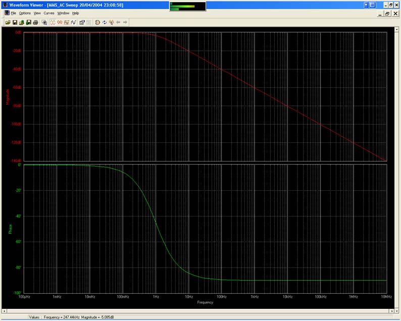

Bad Servos?
Servos are normally badly implemented due to the -3dB point being far to near the audio band. The -3dB point should not be at 1Hz as a lot of audio is still being fed back into the amp at higher frequencies as can be shown on the graph with a -3dB point of 1Hz. It should be around a -110dB point at around 10Hz for the servo to have no effect on the audio signal but this causes another set of problems which take extra circuitry to solve. I would not feed any signal which is not from the source or is direct feedback from the amps output into one of the differential amplifiers inputs, certainly not a -60dB signal at 1kHz as shown on the graph. This is bound to cause serious alterations of the original signal.
Each line on the Y scale is 20dB.
Regards
David
Regards
David
