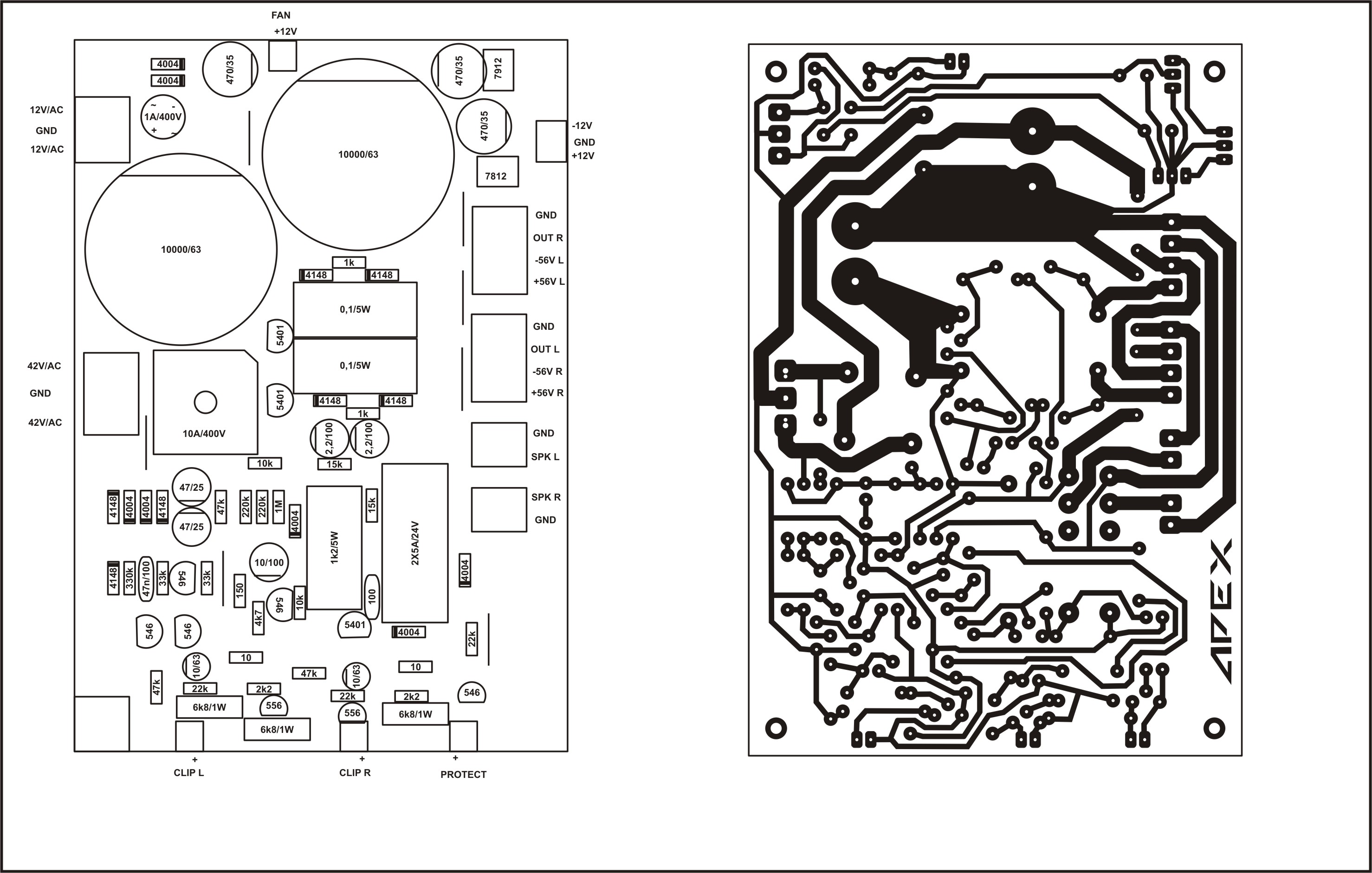

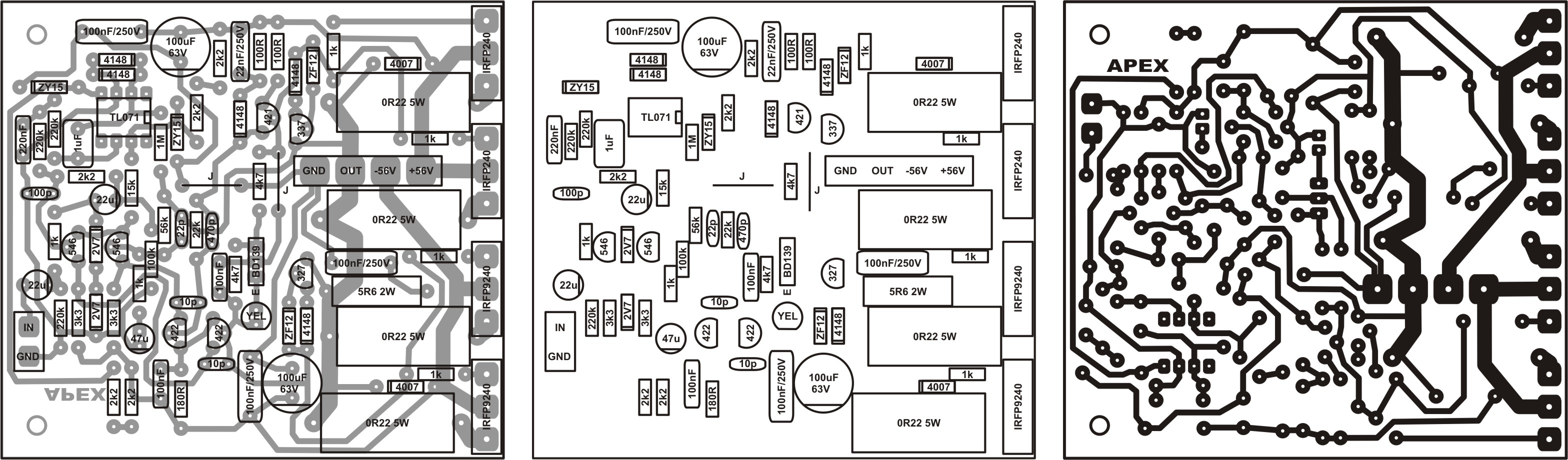

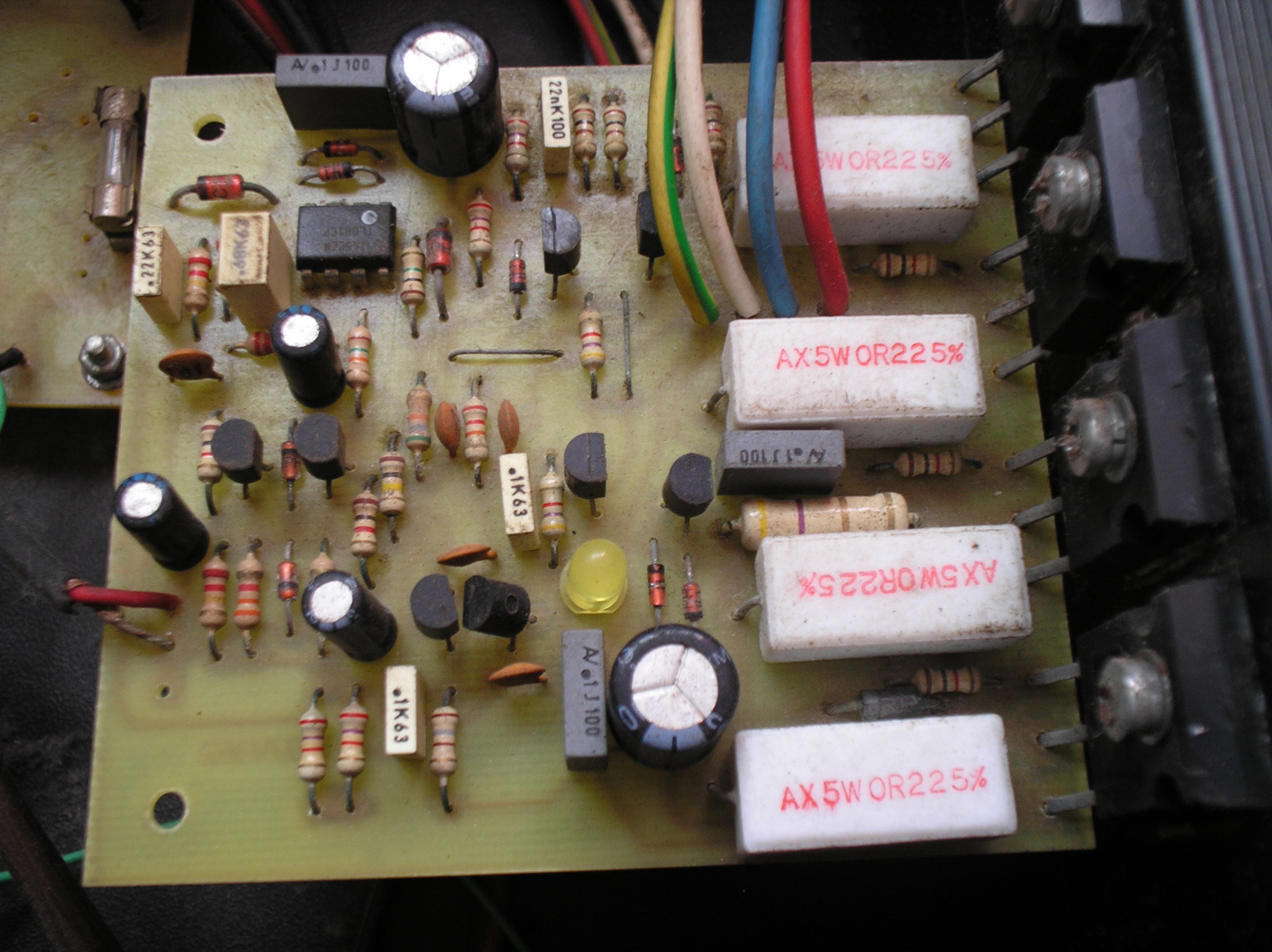

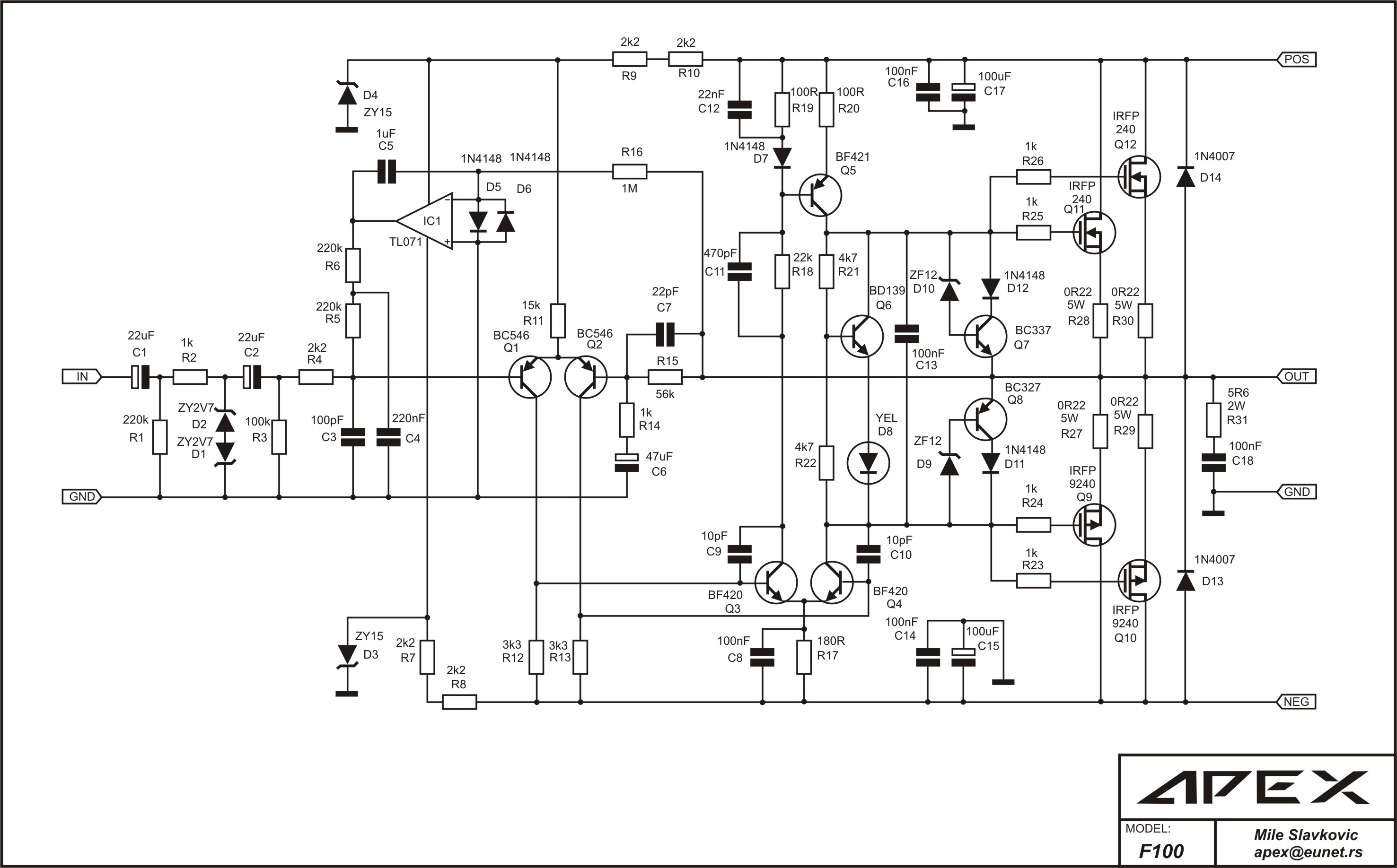

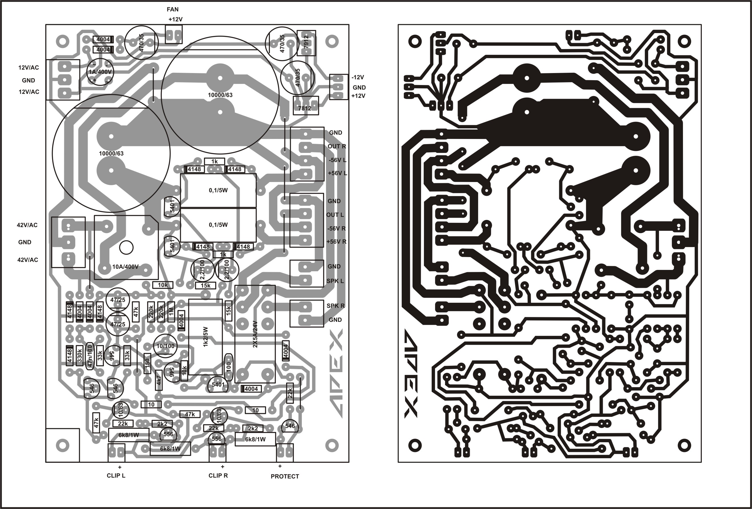

DC Servo MOSFET Amplifier

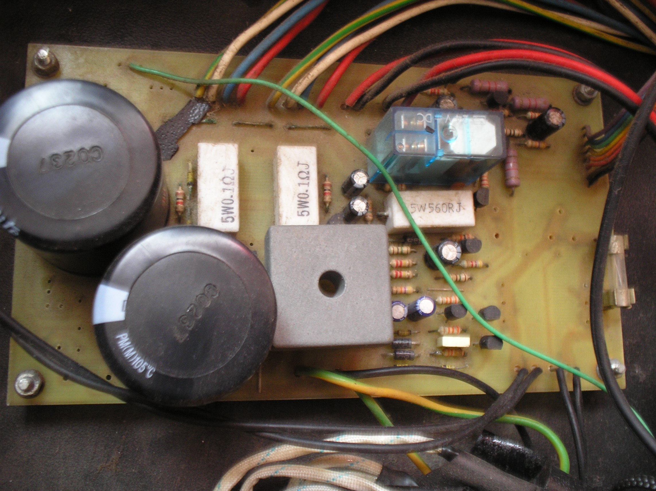

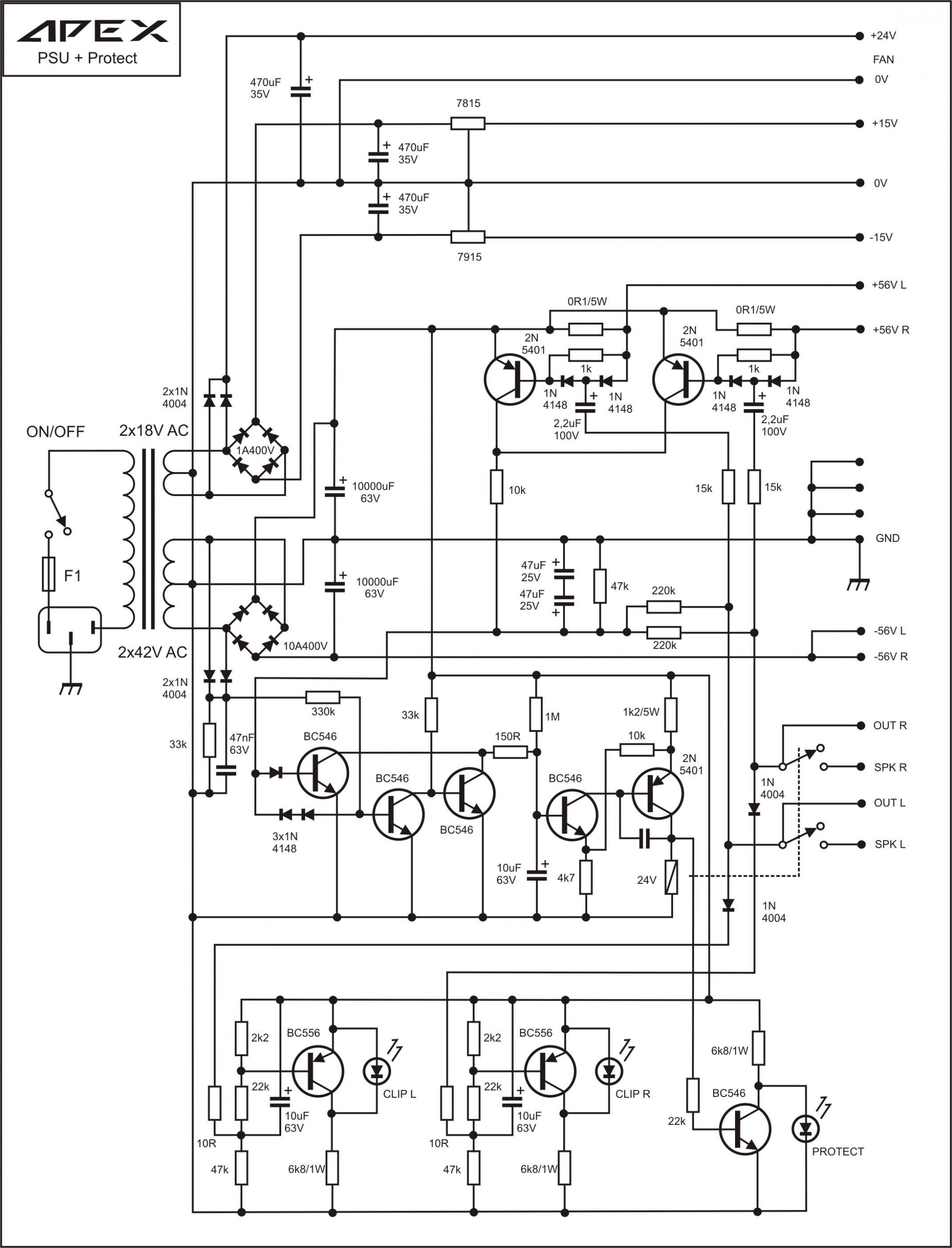

F100 psu
On this PCB exept PSU is short-circuit and DC protect, clip indicator...
I'm not a big fan of solid state, but I have some questions!
I do not understand why you have C2 as well as C1.
What are the big 0.22R resistors for?
What is the loop feedback gain/amount?
What is the crossover distortion with the loop feedback removed?
I think you need a bias so you can also run in class AB (my opinion)
Why is there no bypass cap for the zener of the driver circuit?
Why is there no Zobel network (LC) on the output?
