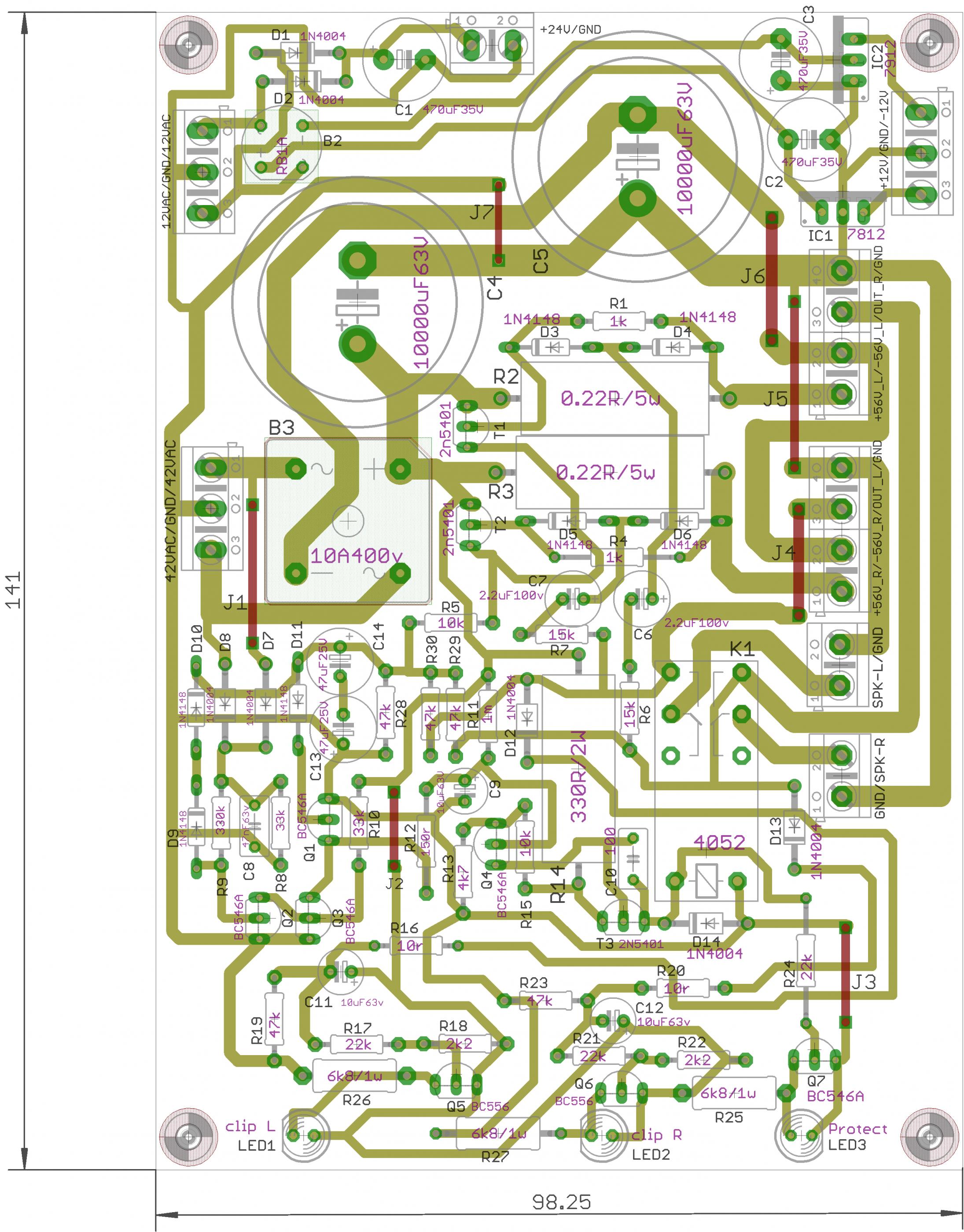

On this PCB exept PSU is short-circuit and DC protect, clip indicator...

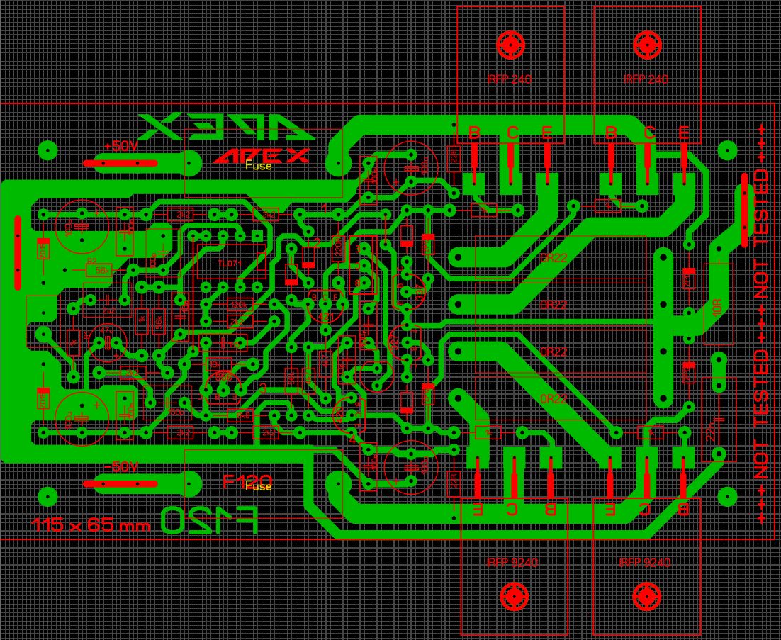

Dear Mr. Mile,
here is my eagle version of your PSU+Protect+Clip PCB. I found a few discrepancies in the schematic, but I laid the PCB as per your PCB layout. pl inform if there are any errors.
regards
prasi

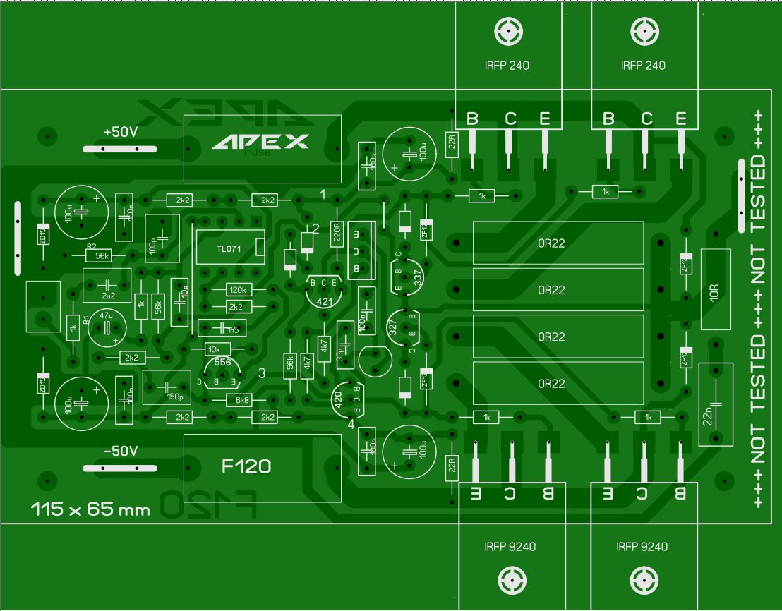

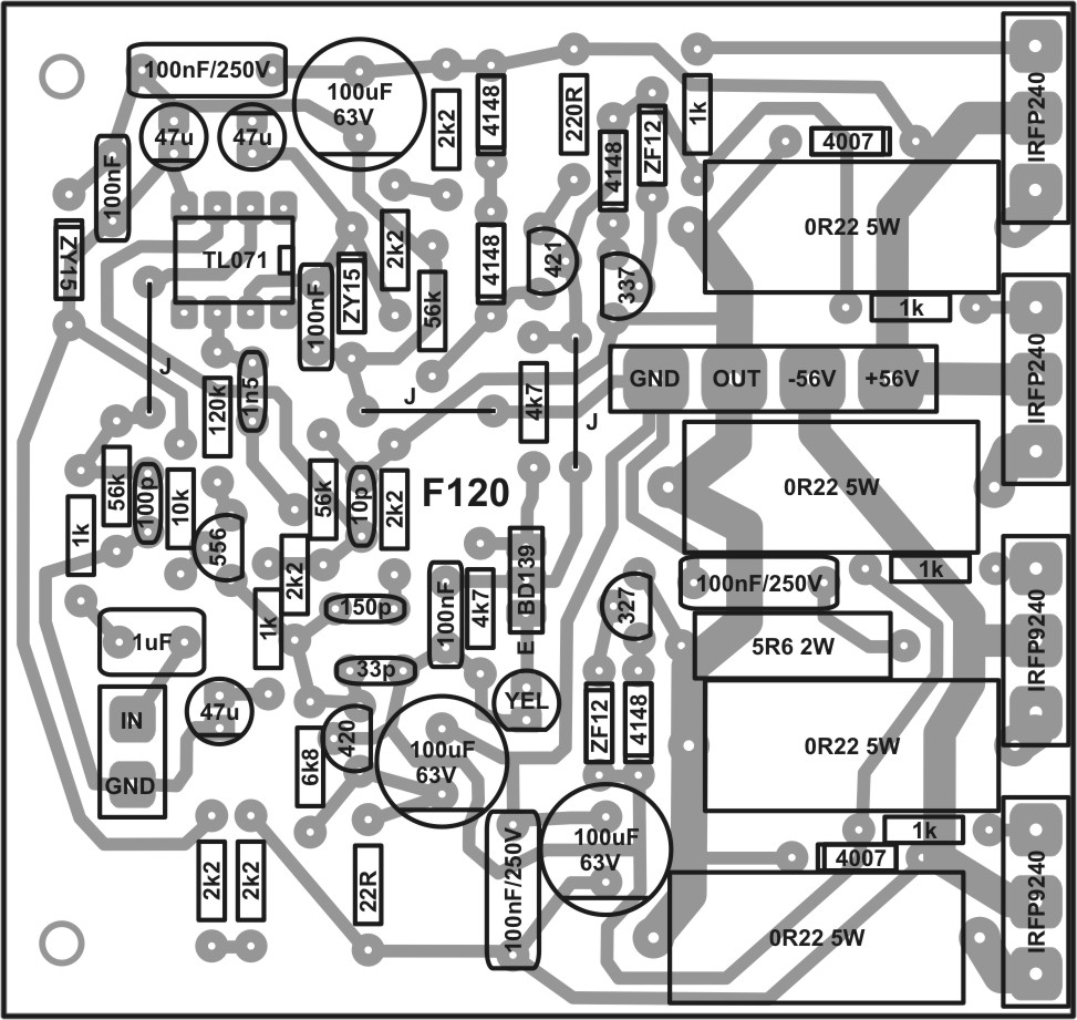

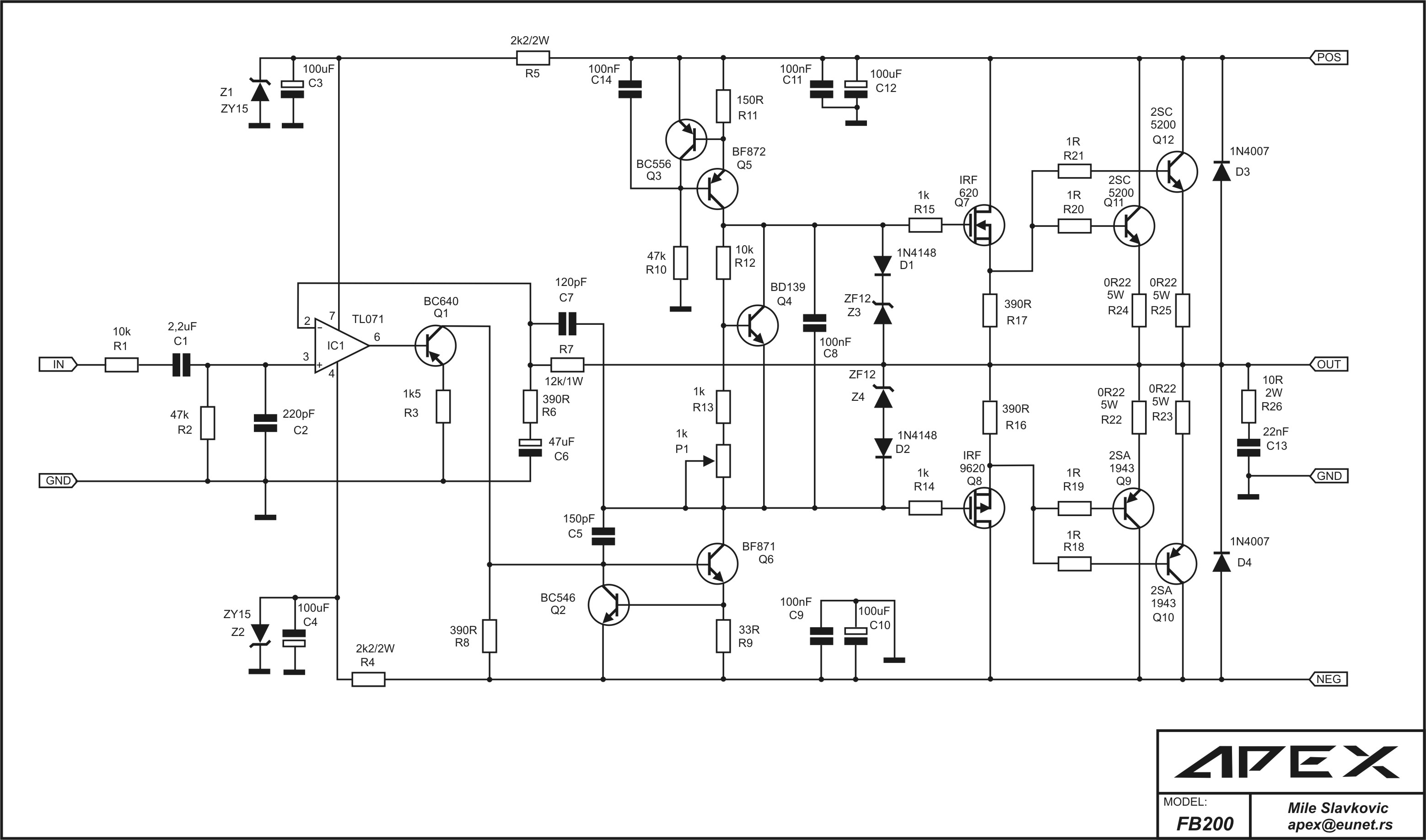

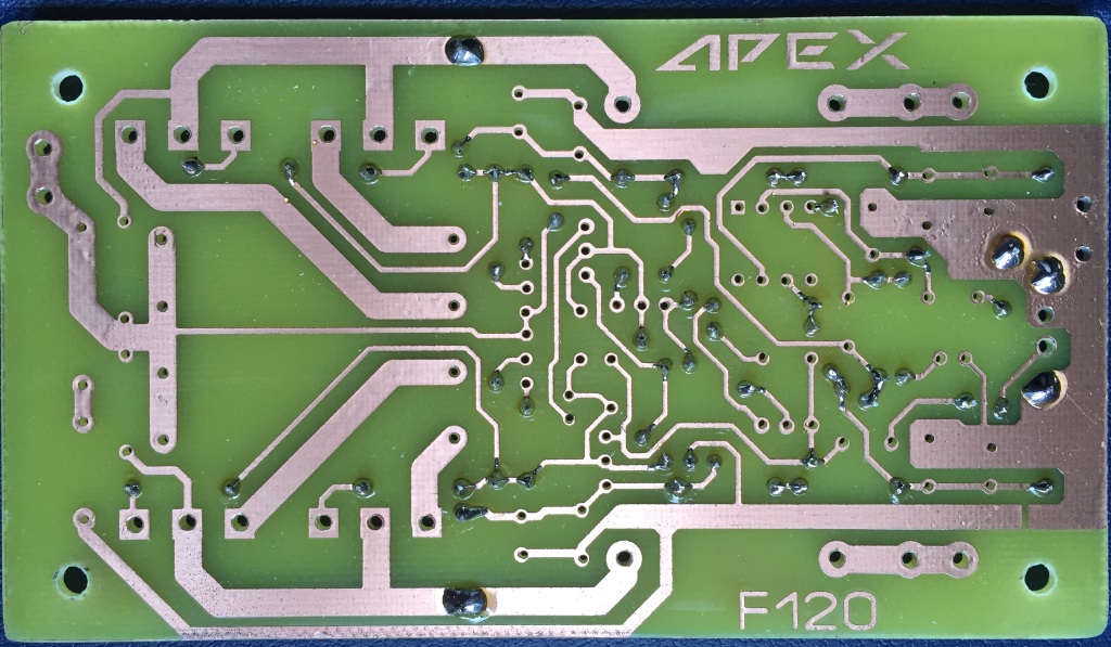

I've never tried an amplifier from this thread. So here is the first draft of a F120.
It would be nice if someone could look at it.
I hope, next weekend I will find time for etching PCB.
regards Olaf

Nice pcb,
Regards
Dear Mr. Mile,
regards
prasi
Mr.mile any comments on the layout of PSU? I am getting the psu circuit screen printed to try on for the kelvin amp stereo.
Reg prasi
Reg prasi
It's ok, you just redraw my pcb.
Regards
Regards
Yes. I redrew your PCB. I am yet to reach a level where I can prepare my own layouts based on your schematic. . thanks for the confirmation. One other help. I did not like the sound of lm3886. My cheap commercial solid state amp makes much better sound. I have posted this query in lm3886 thread. Tell me whether kelvin amp can be used as a full range amp and can it produce audiophile quality sound? I am interested to know the specs of kelvin amp.if you have. Like thd. Imd . bandwidth etc.
Sorry for mistakes as I am typing from mobile.
Reg
Prasi

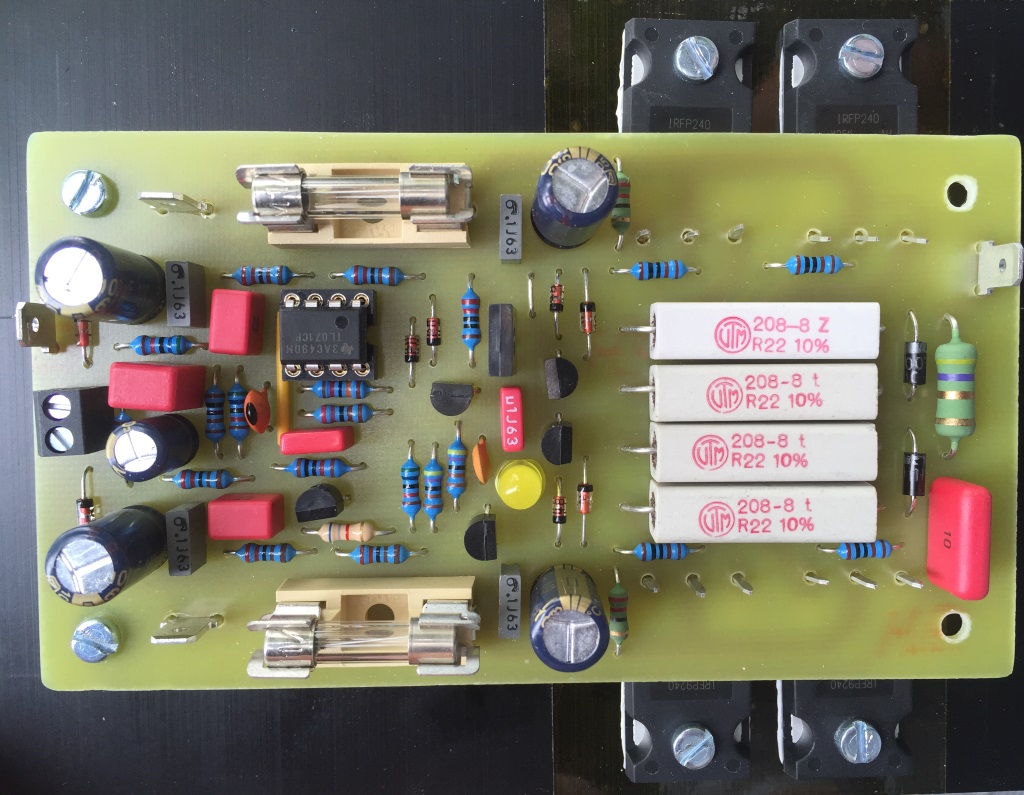

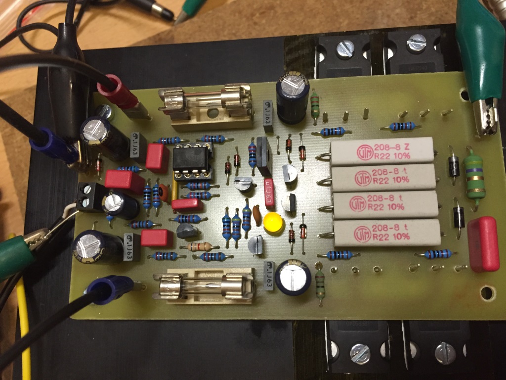

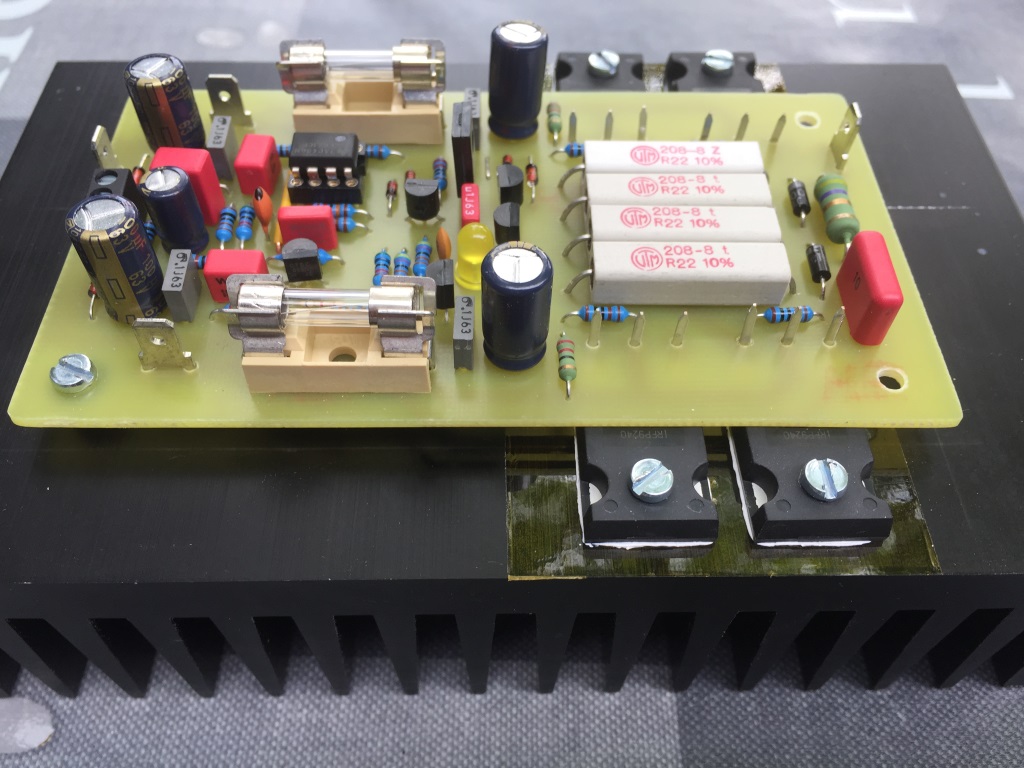

I have assembled the F120. The first test shows a lot of trouble
Quiescent current is 160mA but the output has oscillations at about 20 kHz and + -40Vpp. Supply voltage is + - 52V DC. Zobel (4R7 + 100n) is really warm and R18 (22R) is very hot. A signal at the input (0.5V 1kHz sine) can not be seen at the output.
So tomorrow I will go and check everything again and make some measurements.
regards Olaf

Input gnd and power gnd is not separate on your pcb...
Hi Mile,
yes, unfortunately you're right . I will correct that. Probably is this not the only error...
Then I'll try again.
Thanks and Greetings
Olaf

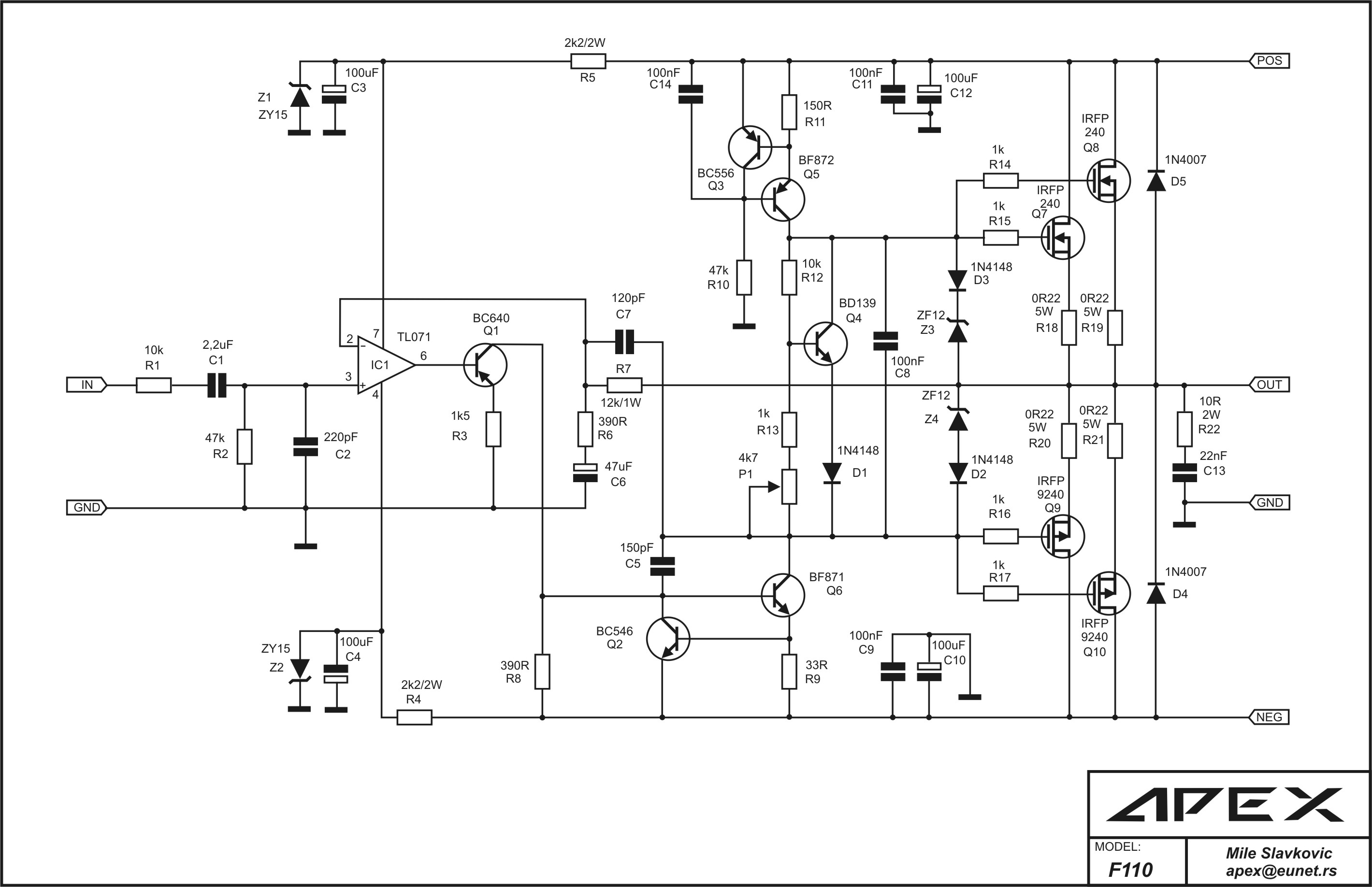

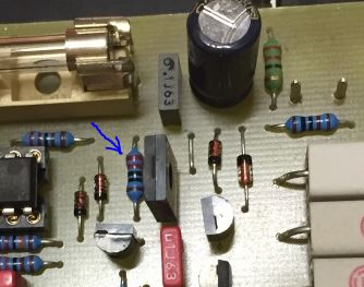

R11 is 220R not 22R...
now the amp is singing
I corrected the input GND and changed all components in the oscillating negative supply and the opamp.
The sound is very strong and clear, but I tested only on old speakers.
It runs on + -52V, all is cool, quiescent current is only 8mA (?), offset is 1 mV.
Unfortunately my oscilloscope is broken, so I have no other pictures.
I will build the second channel with the corrected layout as soon as I find time
regards Olaf

R11 is 220R. Seems to be ok.
You add 22R in positive rail it's ok.
Regards
