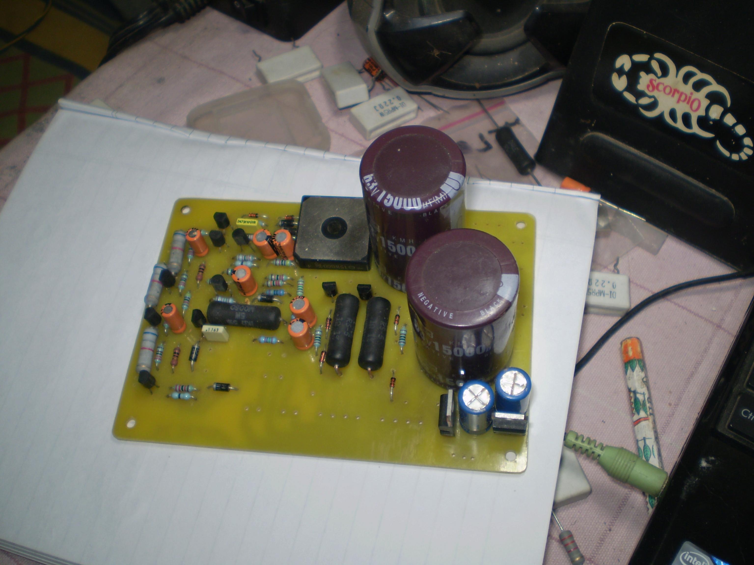

GREETINGS NICE POWER SUPPLY FOR MY BLAMELESS SUPERCHARGED THANK YOU FOR YOUR WONDERFUL SCHEMATICS

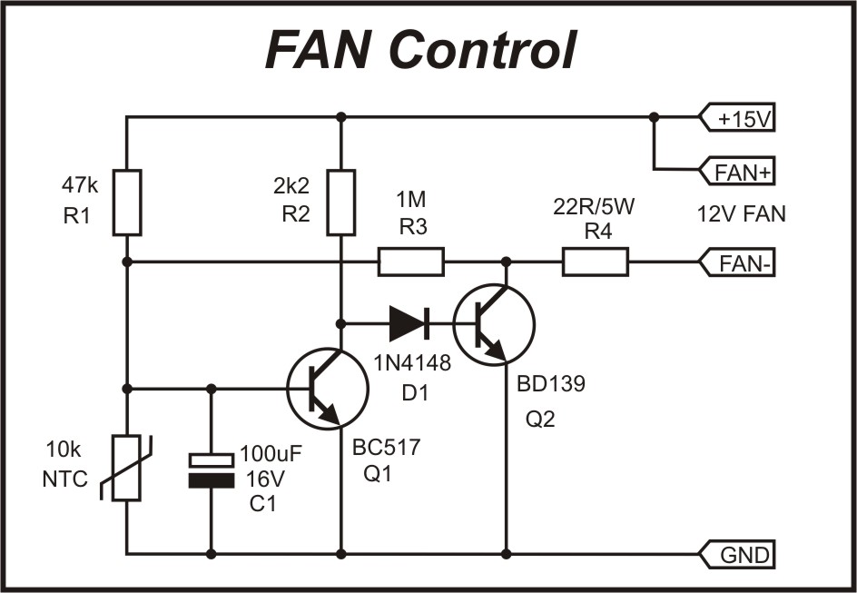

If you want to connect fan to F100 PSU use this circuit 'fan control' will turn fan on in case heatsink temperature is over 60deg. Fan out voltage on F100 PSU is over 15V DC with 12v ac input from transformer. Resistor 22R/5W can be change to get 3-4V voltage drop for different fans.

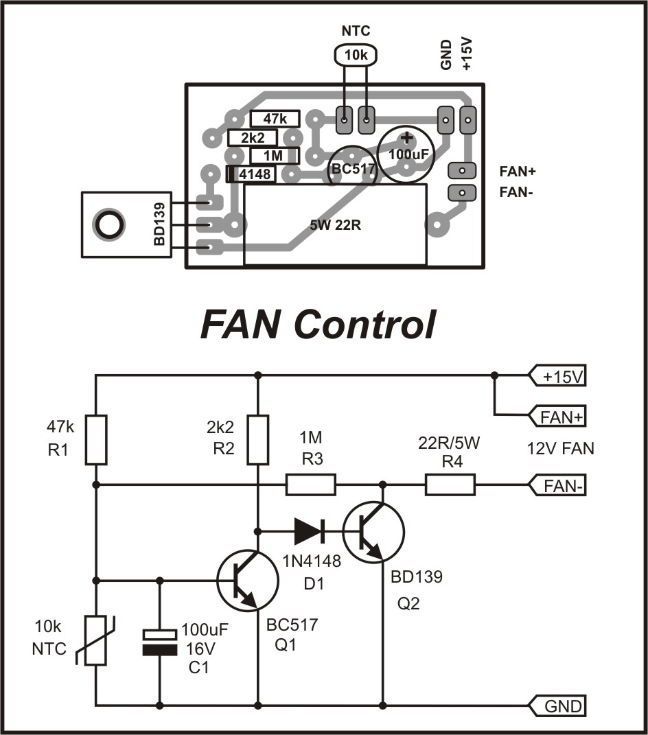

Fan Control PCB
