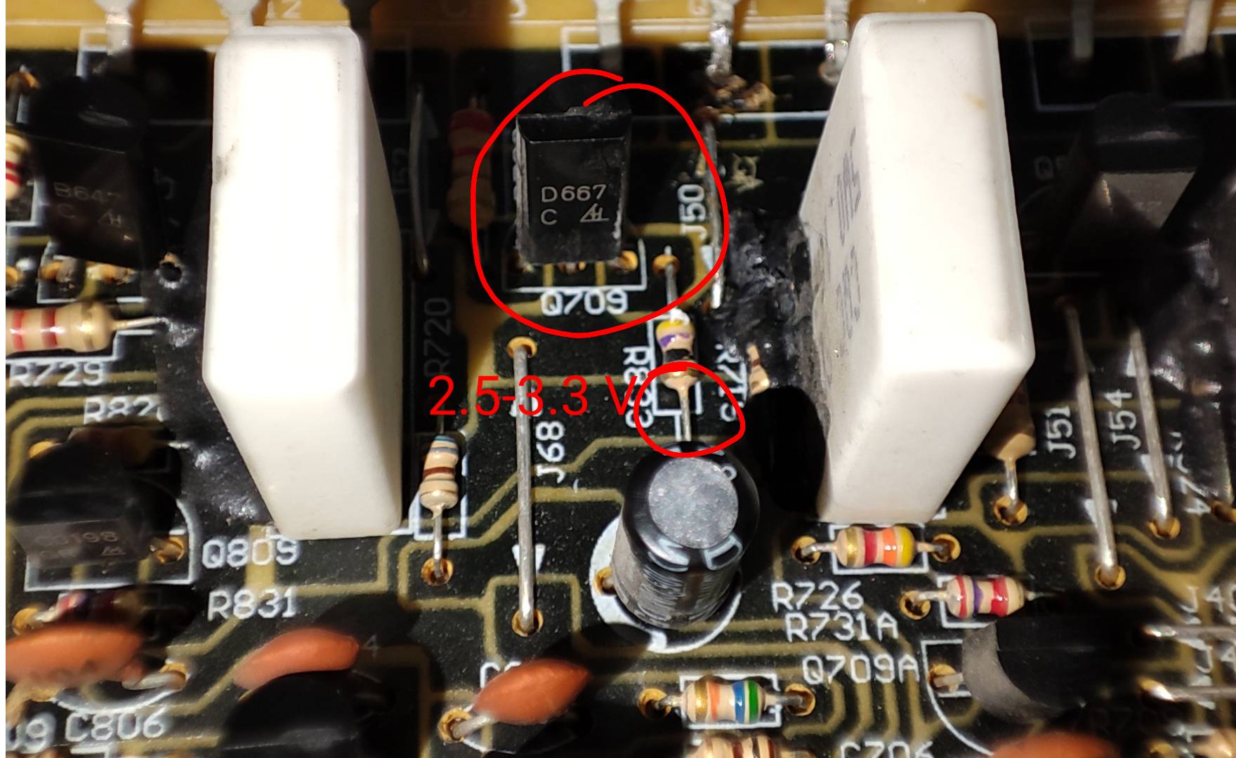

I received a HammerTech ECA470 with a dead power supply issue, only the mosfets on 1 bank were dead.
After I fixed the power supply section I have noticed that one channel is outputting DC on the speaker terminals only under two specific conditions, either after a long shutdown period which will output high amount of DC (probably the reason caused the power supply to die) or when it's playing bass part of the music
When the amplifier was off for couple of hours, powering it back on will caused it to output only DC with a little bit of music in bridge mode and when using each channel individualy, one is fine and the other one outputs DC only on the bass frequencies of the music.
Can you please help understand what is causing this problem?

Only the jumper connecting the rail voltage to the 5198 on this channel had a broken solder connection and the guy before me didn't noticed that and has used a piece of wire to connect from the other channel's jumper

But I found out the pre-driver b647 has 2.5-3.3 on its collector which is driving the D667 and that is driving the 5198 with the correct 0.3 v same as the other channels but 2.5 v on the pre-

Fore many amplifiers, there is a DC blocking capacitor at the front end of the power amplifier (at the differential amplifier). If this amplifier has that capacitor, does the preamp side of that capacitor have any significant DC voltage?
There is another capacitor in the feedback loop (shunting everything but DC to ground). This prevents the amplifier from amplifying any DC. If that cap is defective, that can cause excessive DC offset.
I checked for where is the DC coming from and it wasn't from the cross over section, then I found a bipolar 4.7 mf cap which had DC on both side and it was connected between the base and emitter of a C3198 transistor, removing the cap didn't changed anything so I looked for any defective cap connected some how to the C3198 and no luck there either.Fore many amplifiers, there is a DC blocking capacitor at the front end of the power amplifier (at the differential amplifier). If this amplifier has that capacitor, does the preamp side of that capacitor have any significant DC voltage?
So I freshen up all the capacitors solders and the problem was gone, probably a bad solder connection?! I don't know but now it's functioning as it should.

The channel that was giving DC only when it was playing music had a damaged driver on the 5198 side, and replacing that solved the problem.
On the other channel that had a biasing issue, which sometimes caused it to drive the power transistor to be fully on and output DC on turn-on, had slightly out-of-spec transistors on the biasing circuit. As they are pretty cheap, I solved the issue by replacing all of them together.
I still don't understand why slightly different characteristics between the biasing circuit transistors would cause such a problem when turning on the amplifier and why it was random and had a capacitor-like issue.
