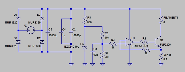

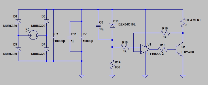

You can use an op-amp for controlling current, but the circuit you have drawn will need to be modified for stability:
An op-amp with a power transistor in its feedback loop will usually require external compensation. A very slow opamp might be OK, but the LT1055 you have shown offers 16V/µs slew rate and 6.5MHz gain-bandwidth product - a nice specification, but adding a power-BJT with its high capacitance will disrupt its feedback loop too much. Think of the result as a kind of electronic tail-chase, where the output of the LT1055 reacts too fast to the feedback sense node for the BJT to keep up with.
Next, beware of output drive requirements. The LT1055, like many opamps is not specified for high-current output. For instance, with +/- 15V supplies it can deliver about 4V into a 100 ohm load (the minimum load resistance specified). For most BJTs, this drive-level will not give low-Vce saturation, and you may find that 3V to 5V of Vce saturation is the best it can do.
A power FET will not show this problem, but these present their own challenges, due to input capacitance - too high for most op-amps to drive directly, obliging us to add series resistance. You then have an RC pole on the output, whose value swings wildly with the capacitance-swings of the FETs (check out the capacitance-vs voltage plots in a typical power FET data sheet).
These problems can be addressed, but whether it still sounds good will be your challenge!

Yeah... Like with any other feedback loop, the stability has to be verified. Think it through, run sims, then verify in the lab. Standard design procedure. At least for me it is. I sometimes reverse the order of the thinking and the simulations. That leads to some interesting learnings at times...
As Rod mentions above, the simple current source circuit does have its pitfalls. I find that they're possible to design around, though. I have that circuit working in a couple of places where I needed a constant current.

What I posted was really a concept, I agree that there are quite a few details to be worked out. In reality, I won't be needing to build one for a few weeks but I really appreciate soaking up the knowledge you guys are willing to contribute.
I have never built with integrated circuit op-amps. It looks like a whole genre of electronics waiting to be explored so I'll do some more reading

Add resistor from source to "-" input, and capacitor from opamp's output to it's "-" input. The rest is fine, if OPAMP can provide you needed output voltage to drive MOSFET.
Yep. I used that compensation scheme in one of my high voltage regulators. Works well. I used an LMP7701 opamp.

Whilst we don't appear to need fast feedback perhaps it helps. In a way it's a lazy way to deal with any h.f. hash from the mains that gets through the transformer and any h.f. hash generated by the rectifiers. By ensuring the current is constant even at high frequencies we do better in keeping stuff we don't want out of the filament current. Any filament current we don't want will be impressed on the signal.
Of course there's still that noisy zener. So how about a dollar or so for a quieter reference such as this:

Please define "constant current". What dynamic resistance you consider as the minimal criterion? What dynamic resistance your MOSTEF has with resistor in source, without any additional feedback through opamp? I thought you need opamp only to keep DC current well defined by your reference voltage.

I mean that the current through the filament, when no signal is present, doesn't change over time. What dynamic resistance do we need ? - well I can't say I've put any numbers to it. Let's think about it here.
I want to avoid non-signal fluctuations in filament current from generating any voltage drops across the filament that would result in an objectionable audio-frequency signal appearing at the output. I don't know what level that should be.
Let's say the signal swing at normal listening levels at the grid is +/- 10V ? . And let's say we want to avoid contamination to the level of -80dB which means 1mV (did I calculate this right?) and which across a filament of 6 ohms is 1/6 mA = 167uA.
So we want the current stable to of order 100uA ?

I highly doubt you'll be able to make a feedback loop that's fast enough to compensate for mains hash and rectifier spikes. Filtering - or just not generating the noise in the first place - works better here. But at least ensure that your circuit doesn't have gain at HF.

So low drift? That probably depends mostly on the tempco and drift of your reference as well as that of the op-amp input offset.

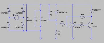

Sorry to resurrect this old thread but I'm currently in for the same type of regulator.
Look at the attached schematic for what I came up with. It's supposed to heat a 2A3 from either 5V or 6.3V spare windings. Excess voltage & power can be dropped in the CRC input. The mosfet max Pd is ~6.5W.
The CCS is adjusted such that 2.5V appear across the filament, much like the Tentlabs regulator. Unfortunately I had to use 3 opamps, whereas the Tentlabs piece seems to require only a dual.
My regulator requires 3.0Vdc after rectification, which, in theory, should be obtainable from a 2.5Vac winding using a synchronous rectifier and huge caps... In practice, it will probably not work with real 2.5Vac 2.5A windings because of voltage sag, when drawing more power than made for.
The real trick would be a dc heater supply for a 2A3 that can hook up to an existing 2.5V heater transformer. Not a lot of spare voltage to play with there.
