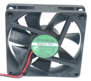

Im looking at this fan to use for my pj.
http://cgi.ebay.com/ws/eBayISAPI.dll?ViewItem&item=6835335838
Is this too much airflow? Because it seems like a hell of alot compared to most fans. And will it be too loud?
Also, soed it matter if it is AC or DC?

Usually more airflow means more noise.
Noise is defined in decibel.
Your fan is rated at 53 dba which is a lot.

Theres a princess auto in Hamilton actually. I never knew they sold fans.... how much though?.... I just ended up buying that fan like 5 minutes ago before you messaged me back.
Is there a point in using this fa? It obviously has more than enough CFM but will the noise be WAY too loud or will turning up the volume a bit drown the noise. My PJ will be about 2 feet in front of me.
I am sure it will be too loud.

I agree with germax, 53 dba will be much too loud. However, you may be able to still use it. That fan pushes a lot of air at 12v. If you cut the voltage it will spin more slowly, moving less air but also operating more quietly. At 6v it should still provide good airflow. If you put it in the interior of your projector enclosure that will also reduce the noise level.
A good benchmark for a 12v fan is less than 30 dba. That's where they start getting pretty quiet.
To run the fan at a lower voltage you have a couple of options.
One is to use a lower input voltage. For example, if you are going to use a computer's power supply to operate the fan then you could use a power lead from the 5v rail instead of the 12v one. I typically use this method when I want to make a computer more quiet.
The other option is to still use a 12v power source but introduce resistance in series with the fan. This is the same principle dimmer switches use to control the speed of ceiling fans. One way you could do this is wire 2 120mm fans in series, with each then getting 6v. Another way would be to use a resistor. An adjustable or variable resistor (potentiometer) would be ideal because you could fine tune the speed and noise level of the fan. In the US, you can find potentiometers in Radio Shack and electronic supply stores.
