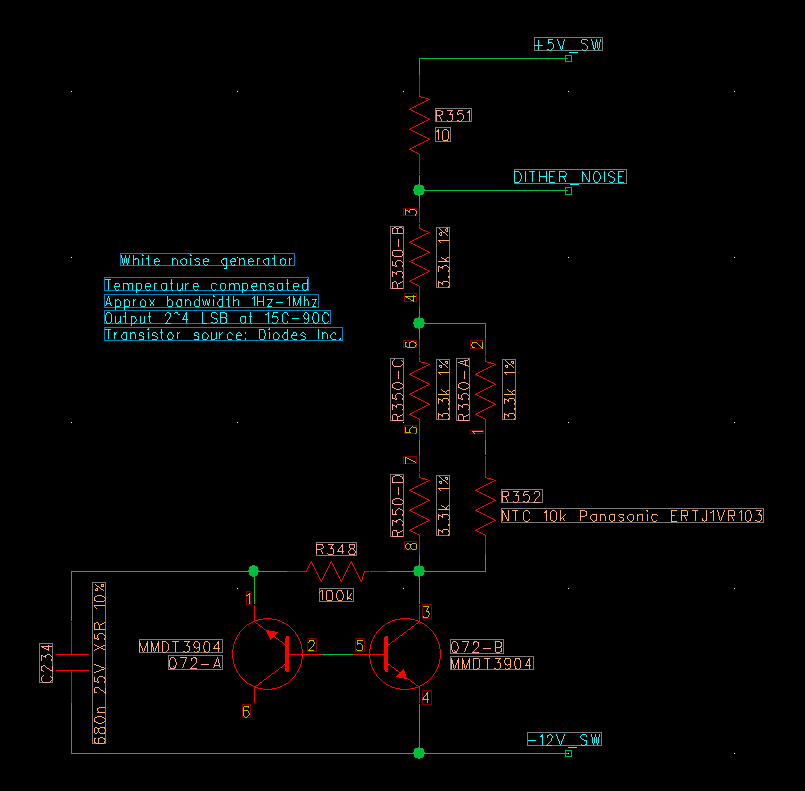

I think I could get that 0.5% in battery measurement, or more, with built-in 10 bit ADC (and trimming maybe). It's a matter of producing white noise with a pair of transistors, injecting a couple of LSB of noise into the ADC, sampling at the highest frequency allowed by PIC processing power, and summing or averaging readings in a higher bit depth accumulator or IIR LPF. Oh, wait, but this is not conventional C programming, it is real-time signal processing, as complex to do in ASM as in C, and saves a lot of resources haha

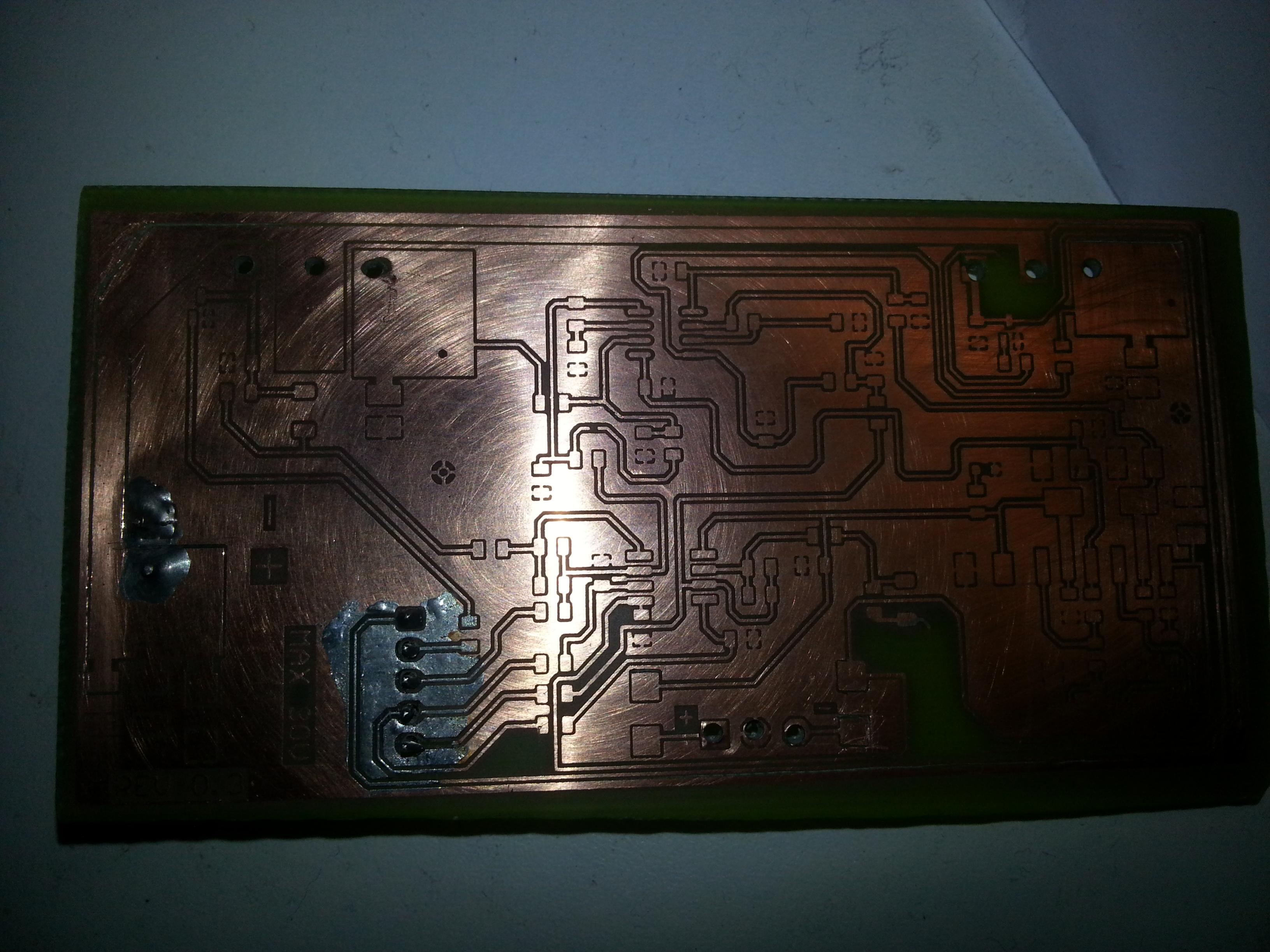

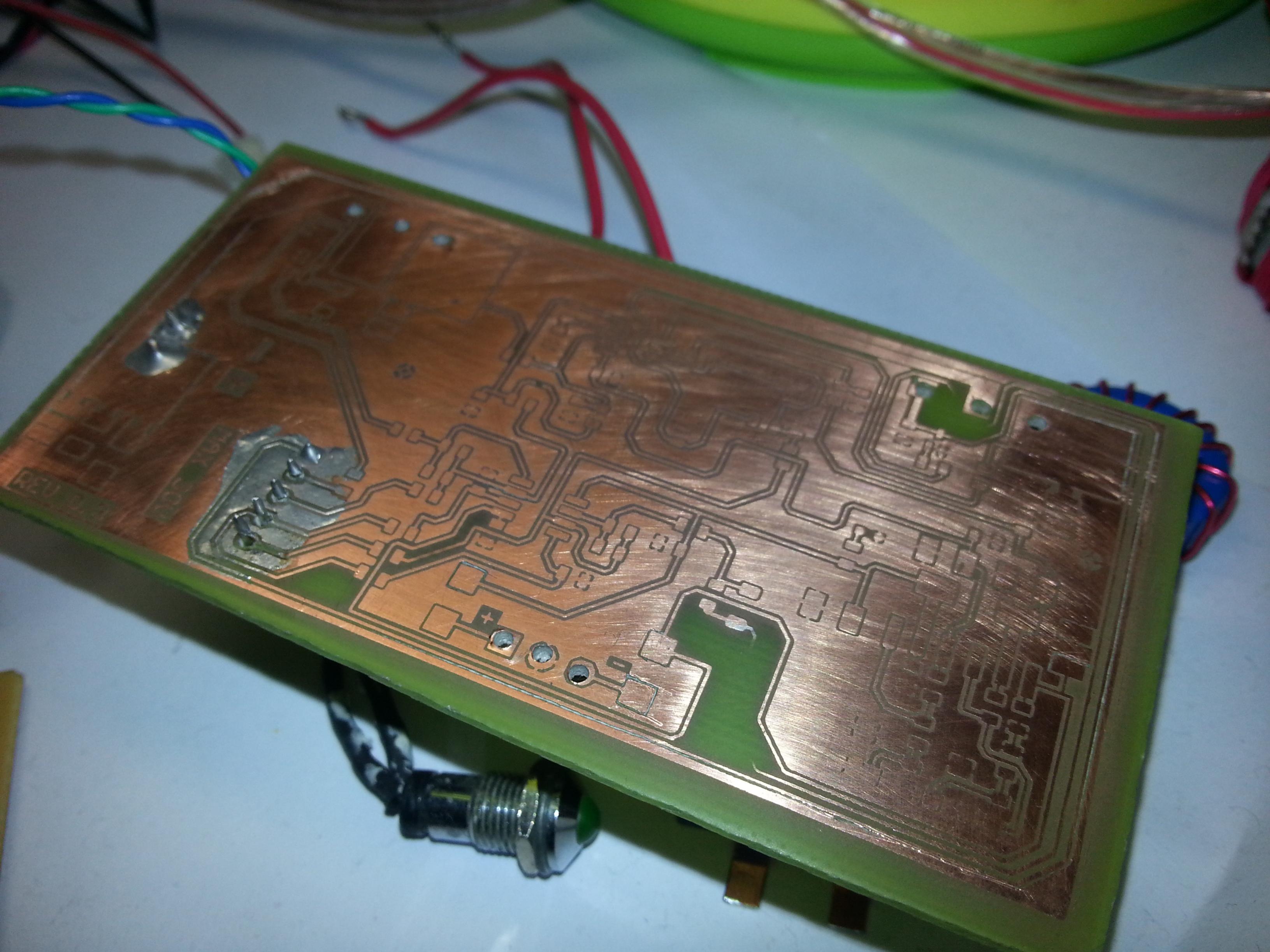

The weekend is over, This is the last entry for now, I have managed to develop the board at home, its been a while since vie created a board out im out of practice, anyway this isn't bad considering I used a UV nail lamp :D

Good work etching the PCB. Thanks for BK precision manual.

My suggested technique for maximizing ADC integrated in MCUs is oversampling, to shave pennies and producing better equipment at same cost for the masses (in the hope that some become techs too). The precision increases proportionally to the square root of the number of samples averaged, provided that there is enough noise with a frequency spectrum extending high enough for random toggling of +/-1 LSB or more of ADC. I just use some code to show numbers by RS232 in text terminal in PC to verify adequate toggling. The circuit of a simple temperature compensated noise generator is attached.
The averaging can be FIR (summing all samples over a period of time, giving one higher precision sample per summing interval) or one or two 1st order IIR LPF (result=result+(ADC-result)*coef) with coef chosen for enough attenuation at sampling freq.

I will hang onto this, and experiment with this at another stage. I've seen this
technique used in this application note, I think for DC application this will work well, but at higher sampling rates this technique wont work as the injected noise will introduce all kinds of issues. thanks for the tip!
