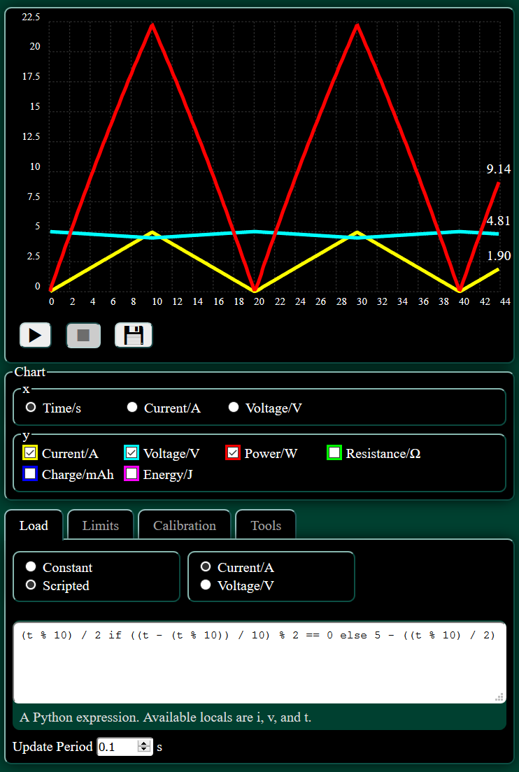

And lastly a screenshot of the GUI as it appears when run on a web browser on a PC, demonstrating how the load can be scripted to do things like ramp the current up and down.
attachment.php
It's capable of 10A, 50V and 100W. It can take over 100 samples per second, though it gets a bit noisy as the sample rate increases. There is a longer description and full source code on my website.
