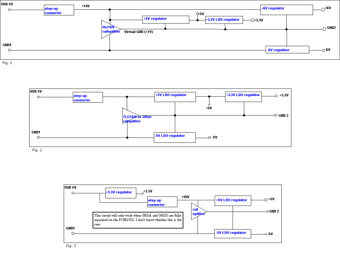

What do you think of these circuits? This are just rough schemes, I will add capacitors etc ofcourse.

If you are to take signals from the USB to the DAC you would need som way of isolating the grounds between the USB and the DAC in all three suggested solutions, optocoulper or transformer.
This since you will have the USB ground as negative rail (with a regulator in series) in all three suggested solutions.
As i see it if you do not want to do that then you could use different topologies for positive and negative rail.
The cuk converter (cannot remember the other name for it) inverts the voltage. And for positive voltage there is the step up converter.

Personally I would connect the input of the 3.3V regulator to the 'raw' 5V from the USB port,instead of the output of the 5V reg. Just so all the 3.3V stuff isn't drawing all it's power through the 5V reg aswell (which has it's own loads to worry about.)..But it may not matter much in this situation..Also,be aware that the USB port can't supply alot of current. 500ma max or something similar.
I was thinking about a couple 9V rechargeable batteries for the output amps..Maybe figure out a way to re/trickle charge them from the USB port. Maybe even just use one for the -9V supply,or something.
Hmm,if you used two,you cold run the whole thing from the batts,and use the USB to charge them when it's plugged in,also that way you won't have to worry about current restraints as much,because it will primarily be running off the batts. Then again,maybe ~500ma is enough..
