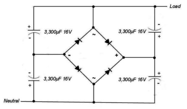

DC blocker diode/cap orientation

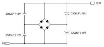

I know there are a lot of threads on mains DC blocking, but none I've seen address my specific question. Circuit #1 is used in a popular manufacturer's amps to block DC. I have been told that the orientation of the diodes vs caps is incorrect, that there is no protection for the caps the way it is now. Drawing #2 shows the caps reversed. Which is the right way ? Comments ?
a good Question. Here the overview of the threads, that I know:
http://www.diyaudio.com/forums/powe...t-buzzing-toroid-transformers-what-right.html
http://www.diyaudio.com/forums/solid-state/2080-dc-filter.html
http://www.diyaudio.com/forums/soli...nt-limiter-their-amplifiers-very-special.html
My favorites are the follow topologies:
DC-Blocker - Scintilla-buizenversterkers (correct version from picture two in post #1)
L C Audio Technology / DC Filter
Because I don't understand the LC topology exactly, I ask there.
Actually there are caps necessary with reverse voltage above 1V. MKP (foil) versions unfortunately very large and expensive.

Those electrolytics on the schematics above are not connected ACROSS the AC power source..... The max. voltage will be present on them is about 1-2 V DC with the circuitry employed. Of course if any of the diodes fail for any reason, now that's a different story.... that means major kaboom, sparks and smoke.
Not to contradict you, but in my 40 years of service practice I've never found one single rectifier blown in amplifiers... everything else yes, but no diode bridges. Those thing are incredibly rugged, a 5A nominal current rated rectifier can take 50-80A peaks -for short time of course. So as long as their voltage rating is sufficient (at least 4-600V) -and you do not put a short circuit across them- you need not worry about their reliability
